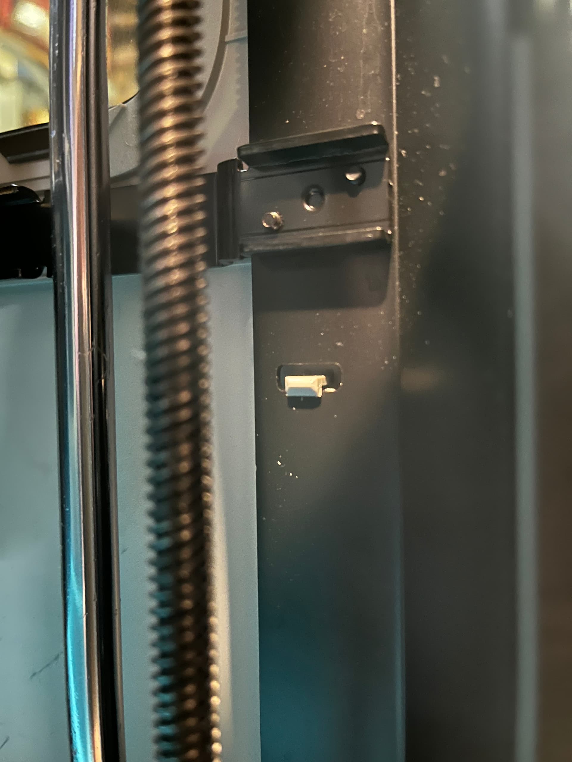

The missing piece does not effect the structural integrity of the part so you can live as it is. Replacing that part would be a major endeavour and re-install one more time the gantry with additional risks.
Ask for a replacement part in a ticket if you wish but just keep it as spare when in the future you don’t have better things to do :grinning_face:

Update on the panel ticket.
Bambu is providing a replacement panel for the unit. I am thankful for this!

Yeah, luckily it was just cosmetic damage. There’s always the option to design/print something thin/light to hide that and glue it on. :slight_smile:
