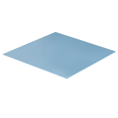

Ah I see. Maybe something like this then - ARCTIC TP-2 (APT2560): Economic Thermal Pad, 50 x 50 x 1.0 mm (1 Piece) - Thermal pad, Excellent heat conduction, Low hardness, Ideal gap filler, Easy installation, Safe handling - Blue : Amazon.co.uk: Computers & Accessories
At least it conducts heat, where silicone would be a bigger insulator than the air was. (despite what the link says, the pad linked is bigger than the bambu heat plate)
Thermal Pad is a great idea, but I already have everything on hand now. Silicone is not the best choice but I use it only as a glue, the layer will be very very thin

Nonsense, silicone has quite good thermal conductivity compared to air, about 0.2 W/m·K on average for non filled types, air has about 0.025. Cheap white thermal pastes have about 0.8 W/m·K for comparison. It’s better to have silicone to fill all of the gaps than having nothing.
Thermal pads are only good if you have a thick gap to fill. Otherwise it’s better to have much thinner filler layer even if filler material has worse thermal conductivity.
The good thing about a thermal pad is that it DOES cancel out imperfection and unflat beds. It will prevent the glass top from slowly taking on the form of the warped bed below.
Nope. It will fill the gap with the least of distance but areas with the most of distance will have gaps remaining. Thermal pads are not something you can sneeze that easy. Even super soft types will not do the job of filling uneven gaps on area this large. As of gluing them, you may have some luck with very hard types which can be barely squeezed but not with soft ones. Not to say they will start leaking silicone oil after some time under high temperature.
