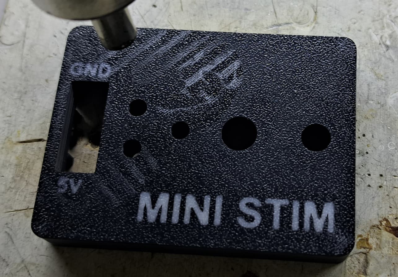

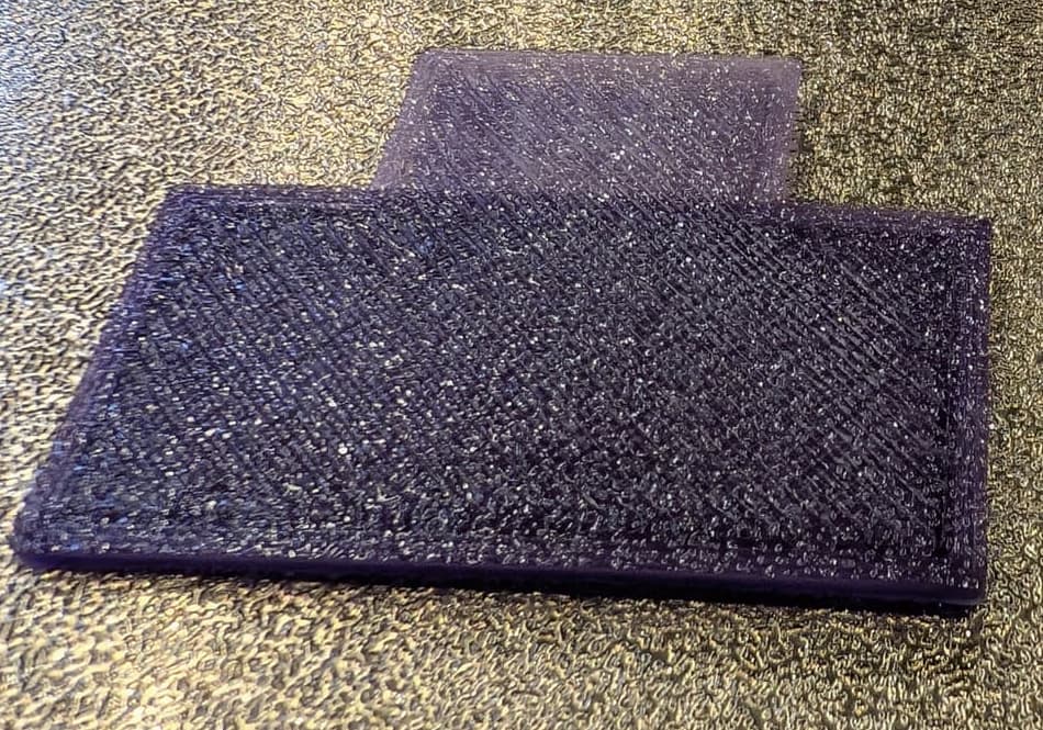

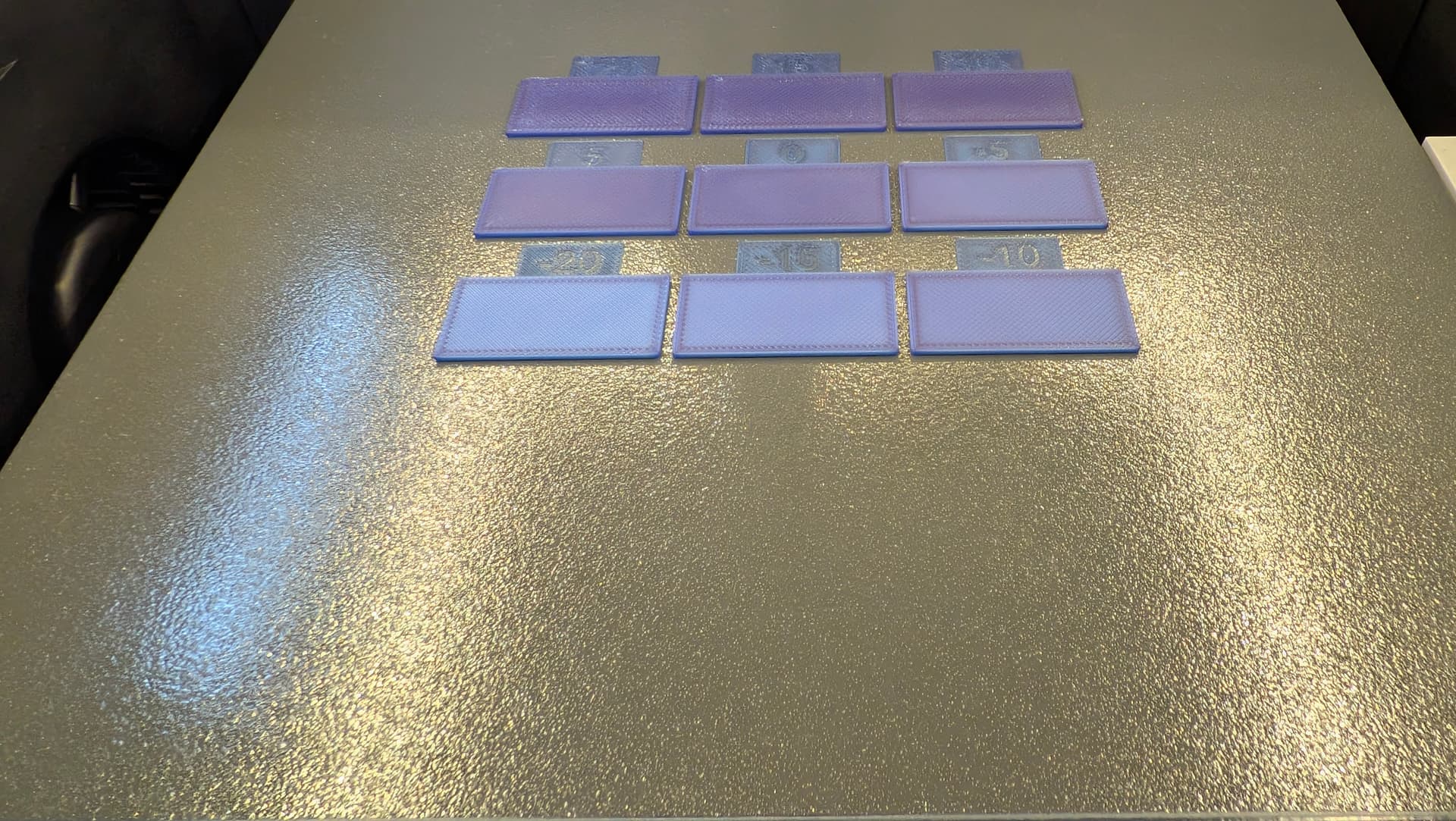

Yours
vs mine
Just ignore the ghost of the previous print. Can you tell the difference?

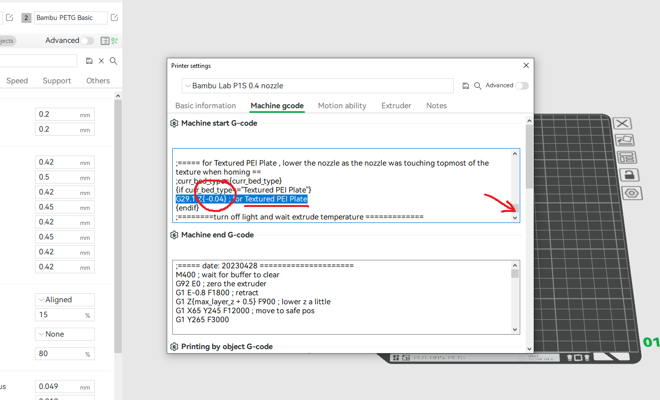

In your case, it would probably be better if you close the door and the top lid as well. But you may suffer the heat creep.
Solution is to move the nozzle closer to the bed. This code below is to offset the nozzle closer to the bed:
That’s how my prints look when they stick. With PCTG they look identical to what you posted. When my prints do stick (30 percent of the time) they look like that as well. I’ll try adjusting but I’m not holding my breath.
