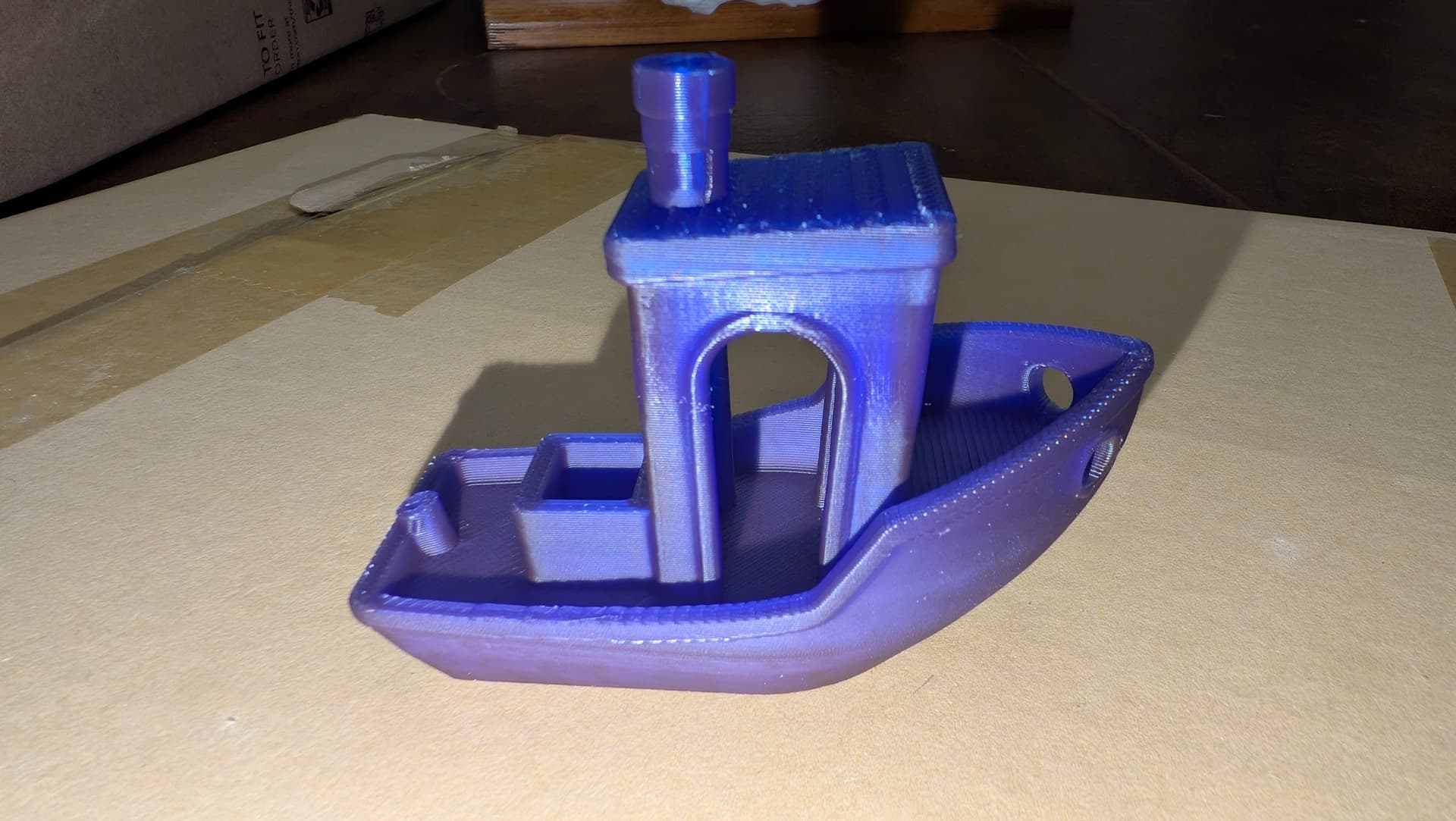

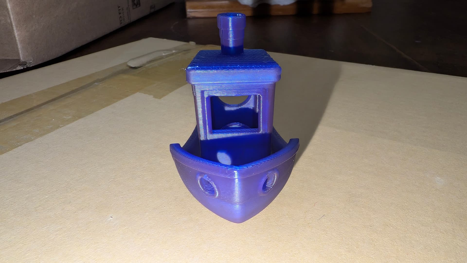

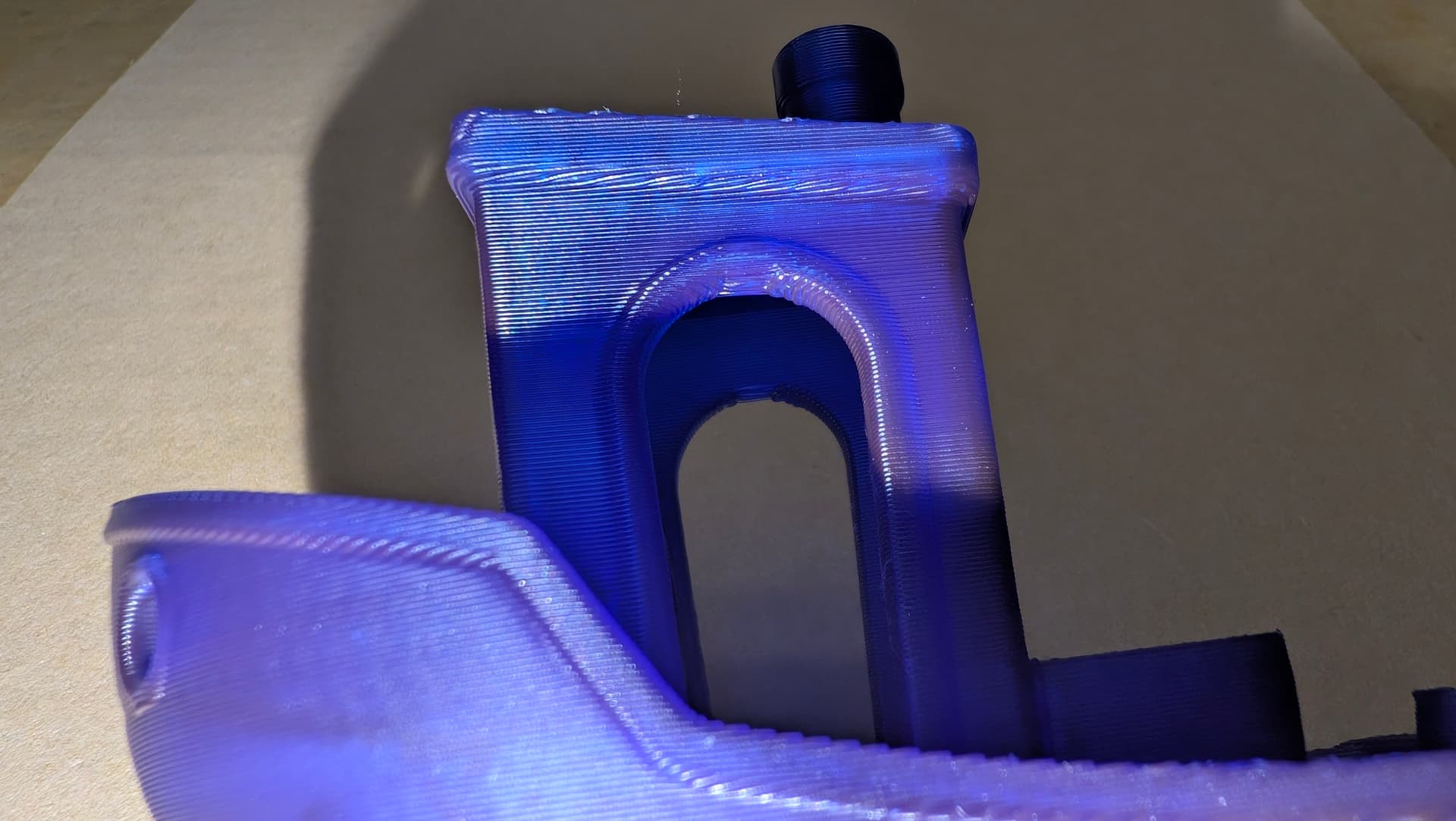

As I mentioned a little earlier, I FINALLY was able to successfully print the Flow Rate calibration for the first time in 9 months but using a different build plate from Biqu (Cryogrip)

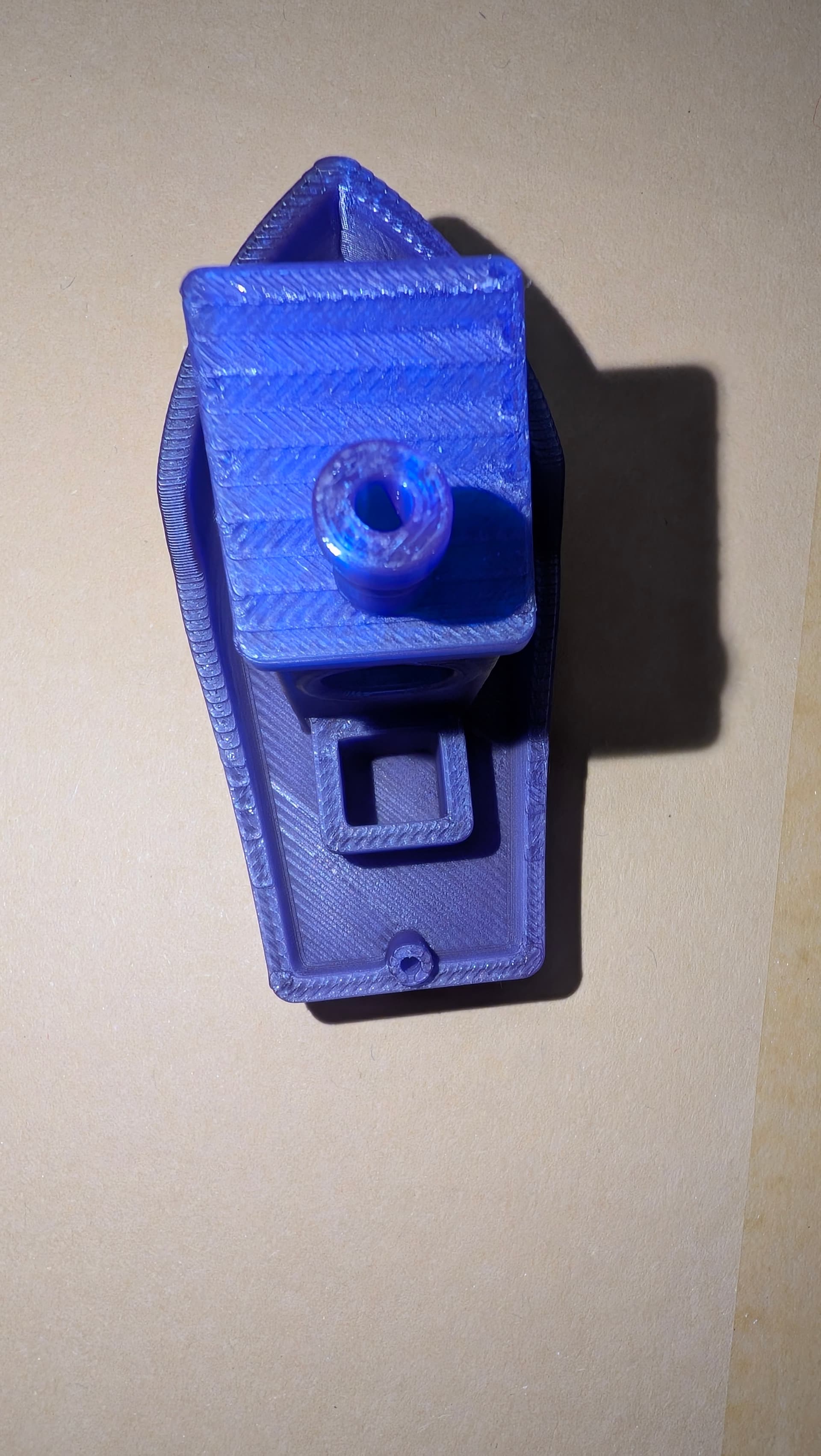

I give you my very first successful benchy using PLA on my P1S

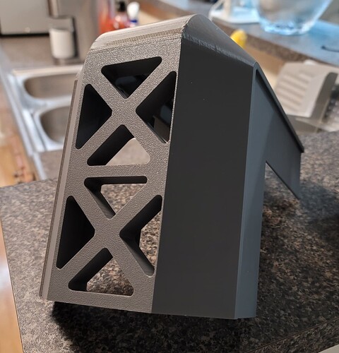

Bambu Lab P1S PLA Silk. Made yesterday in anticipation of Christmas.

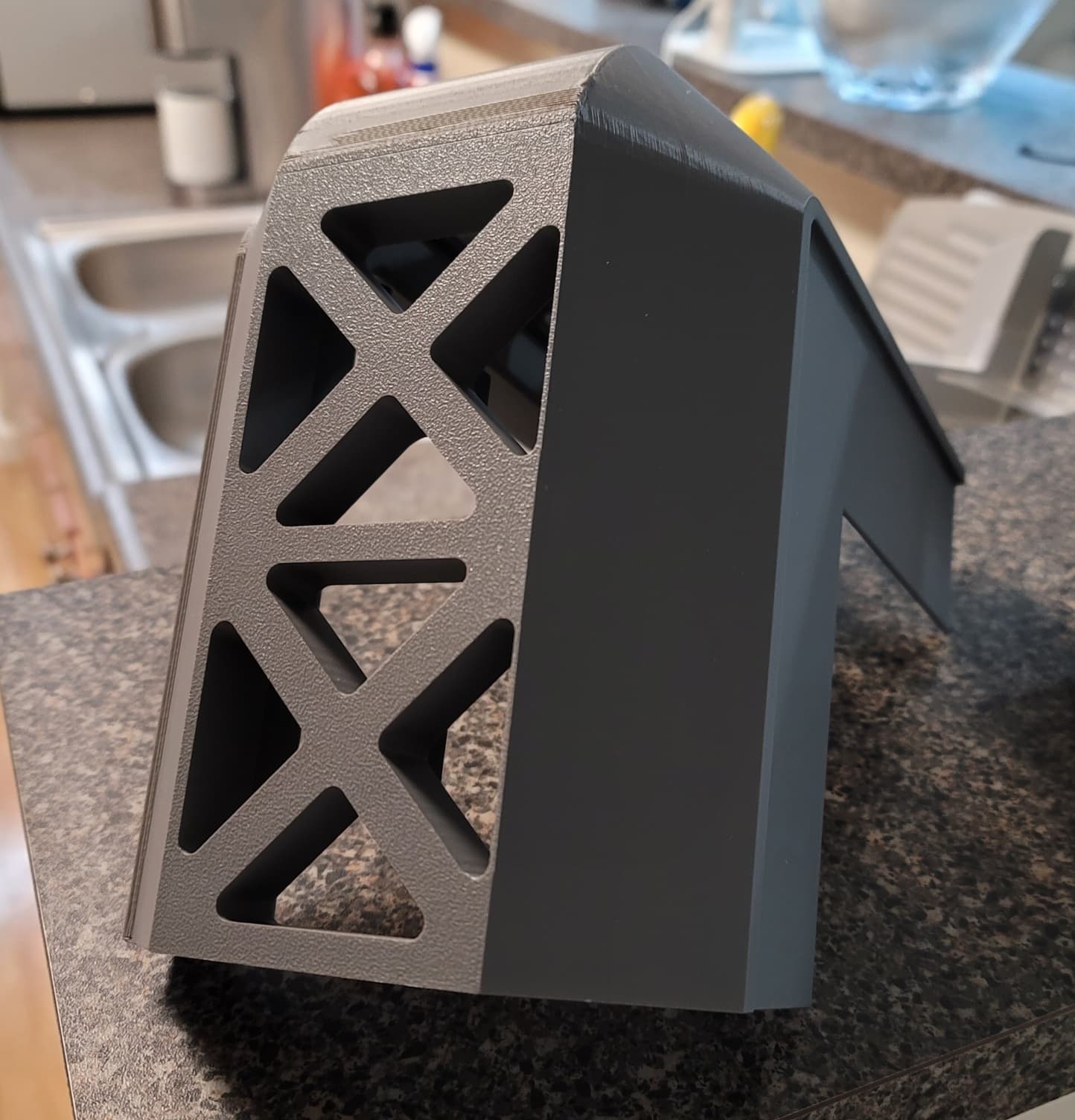

Bambu Lab P1S PLA Basic, Dark Grey AMS Riser, made Monday (while snoozing due to length of print)

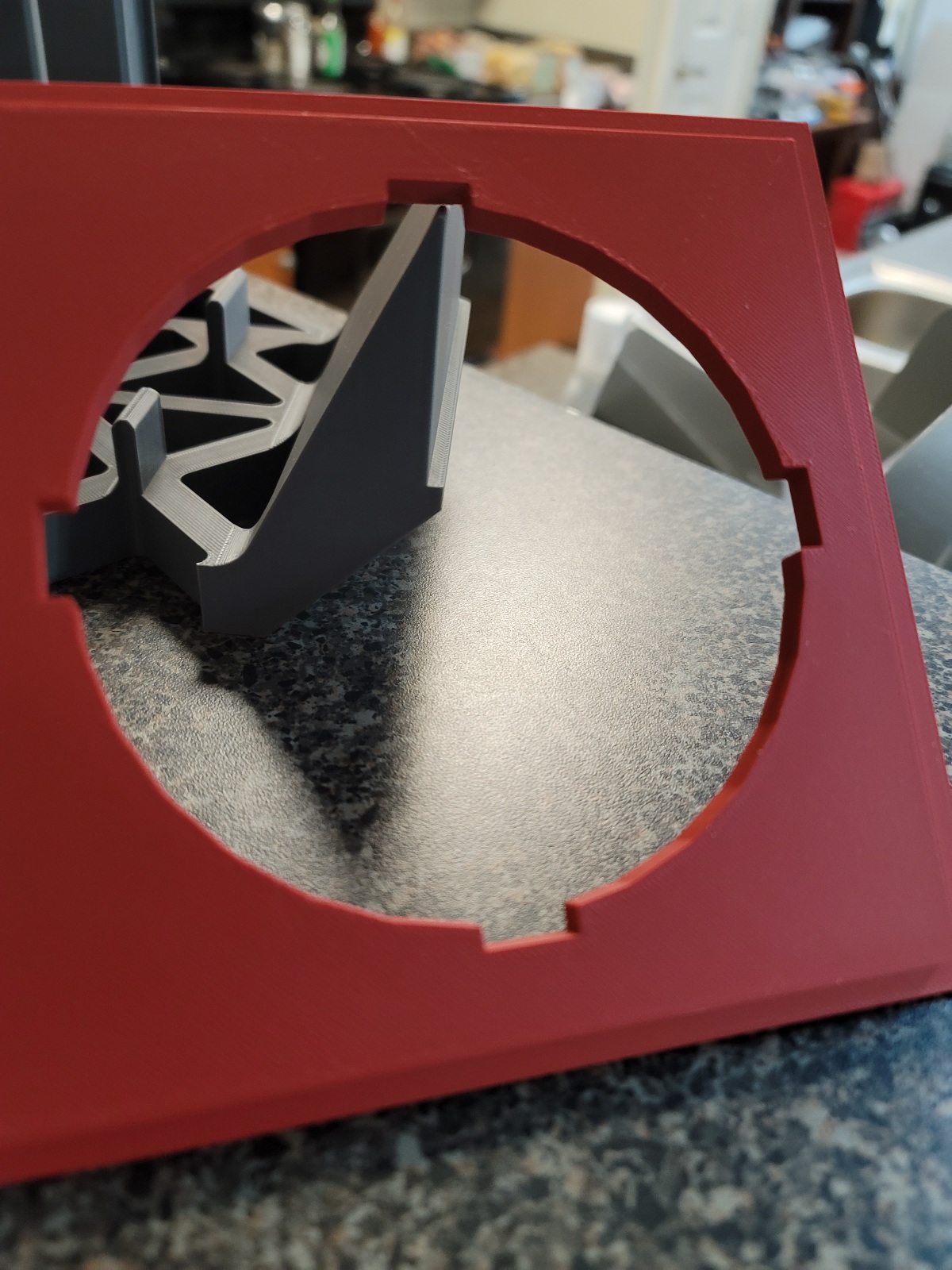

Bambu Lab P1S + OpenSCAD PLA Basic Red, Made Saturday for AMS Dry Air Purge

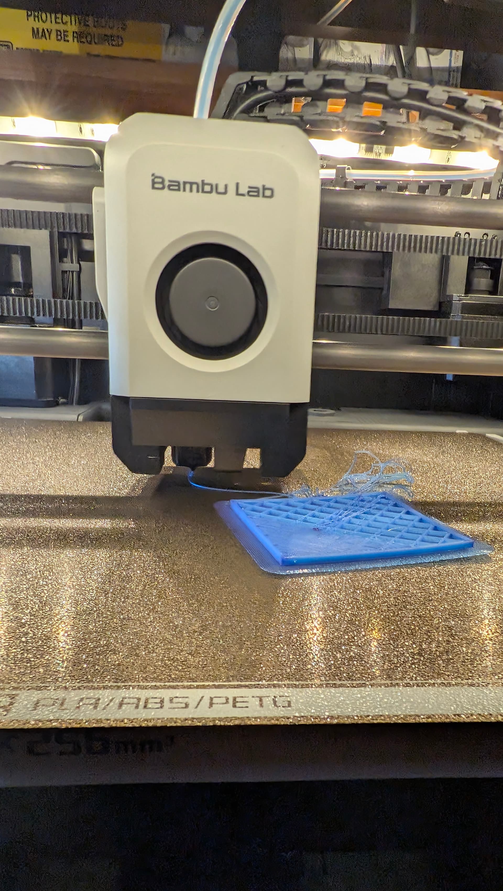

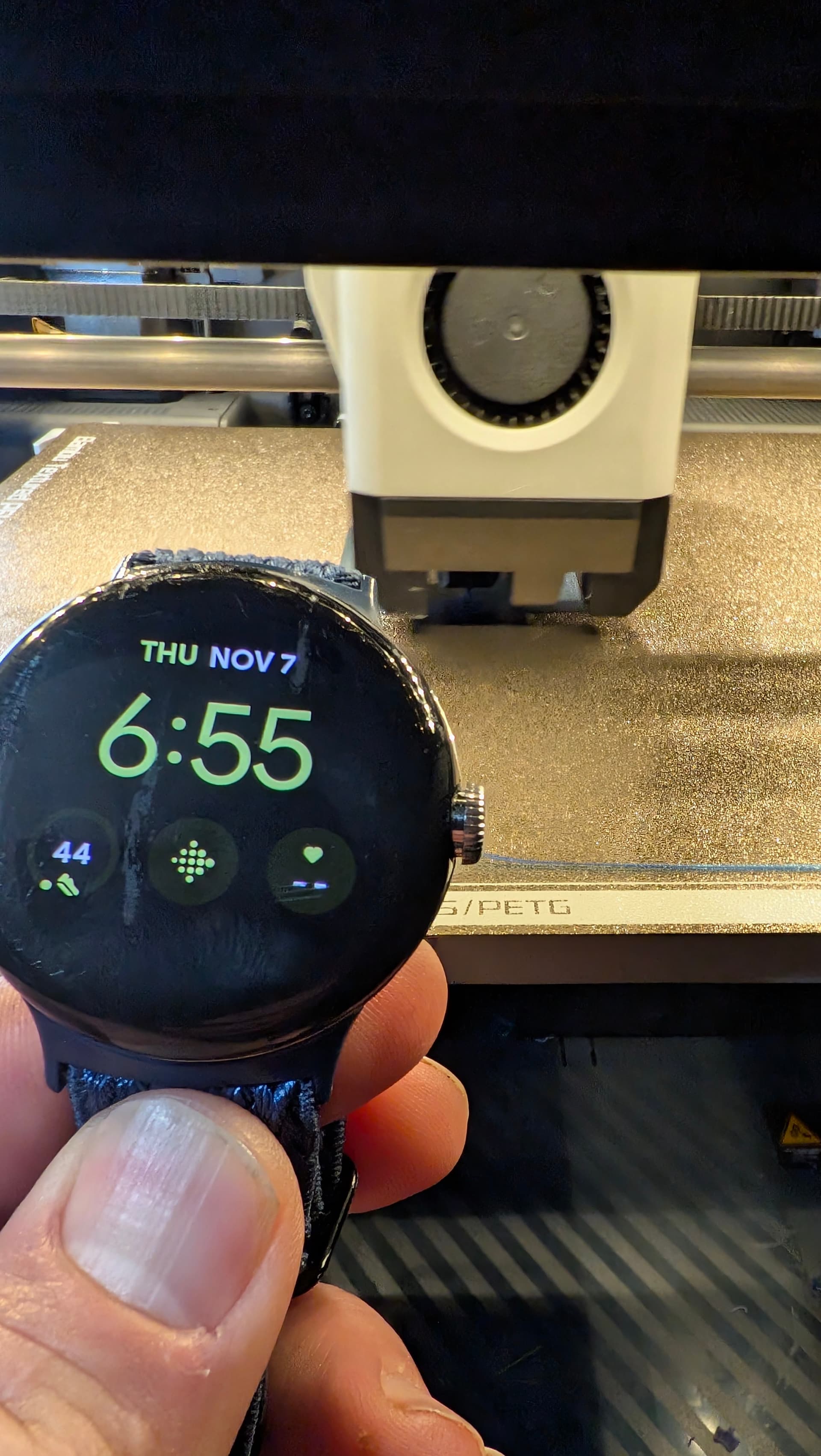

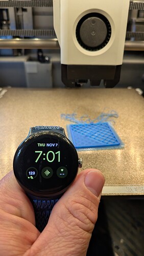

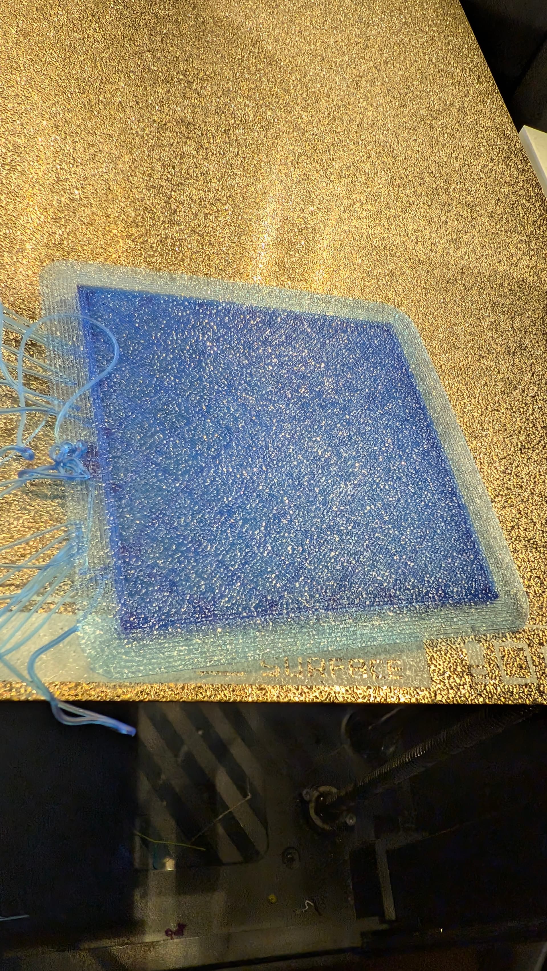

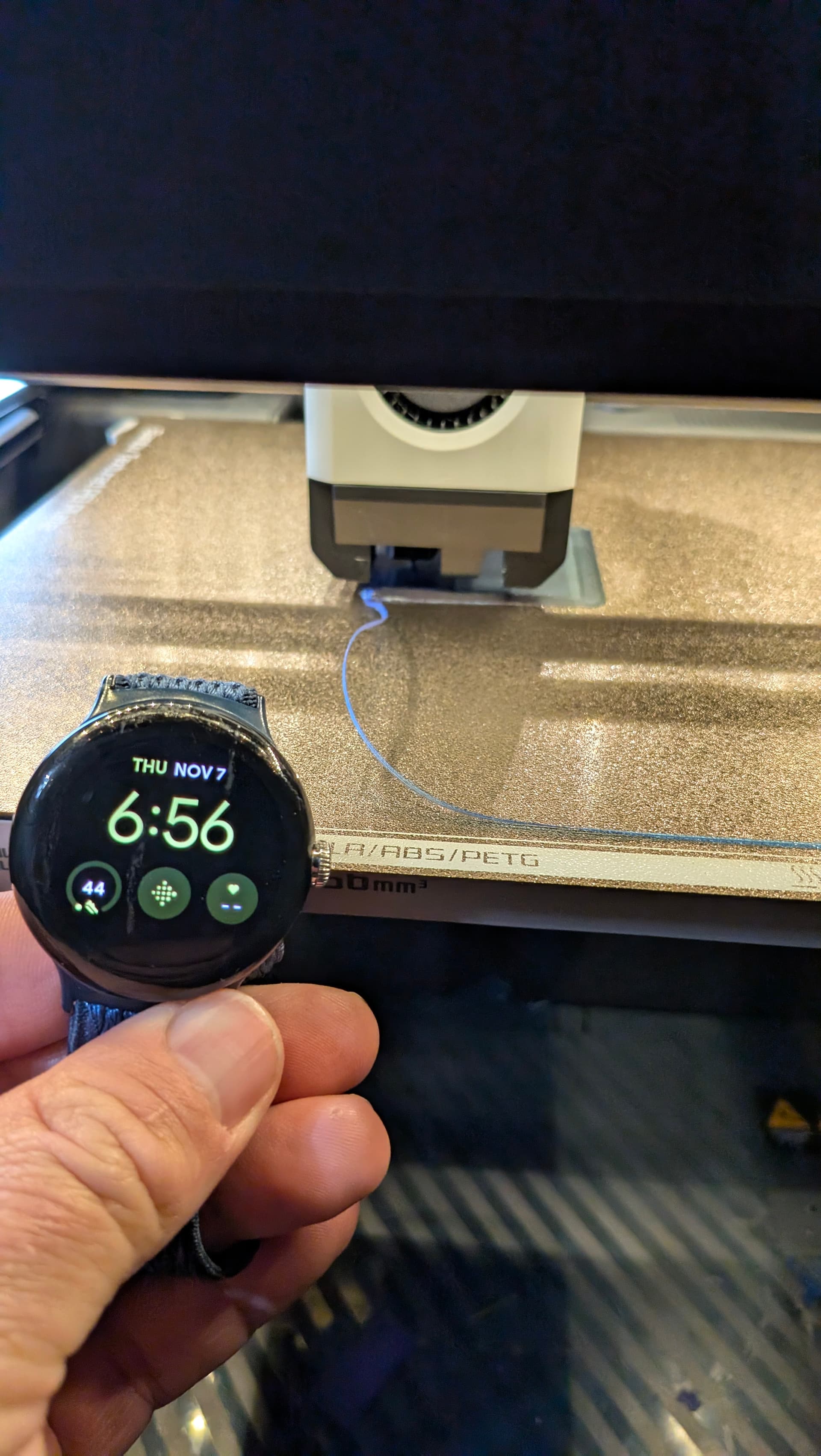

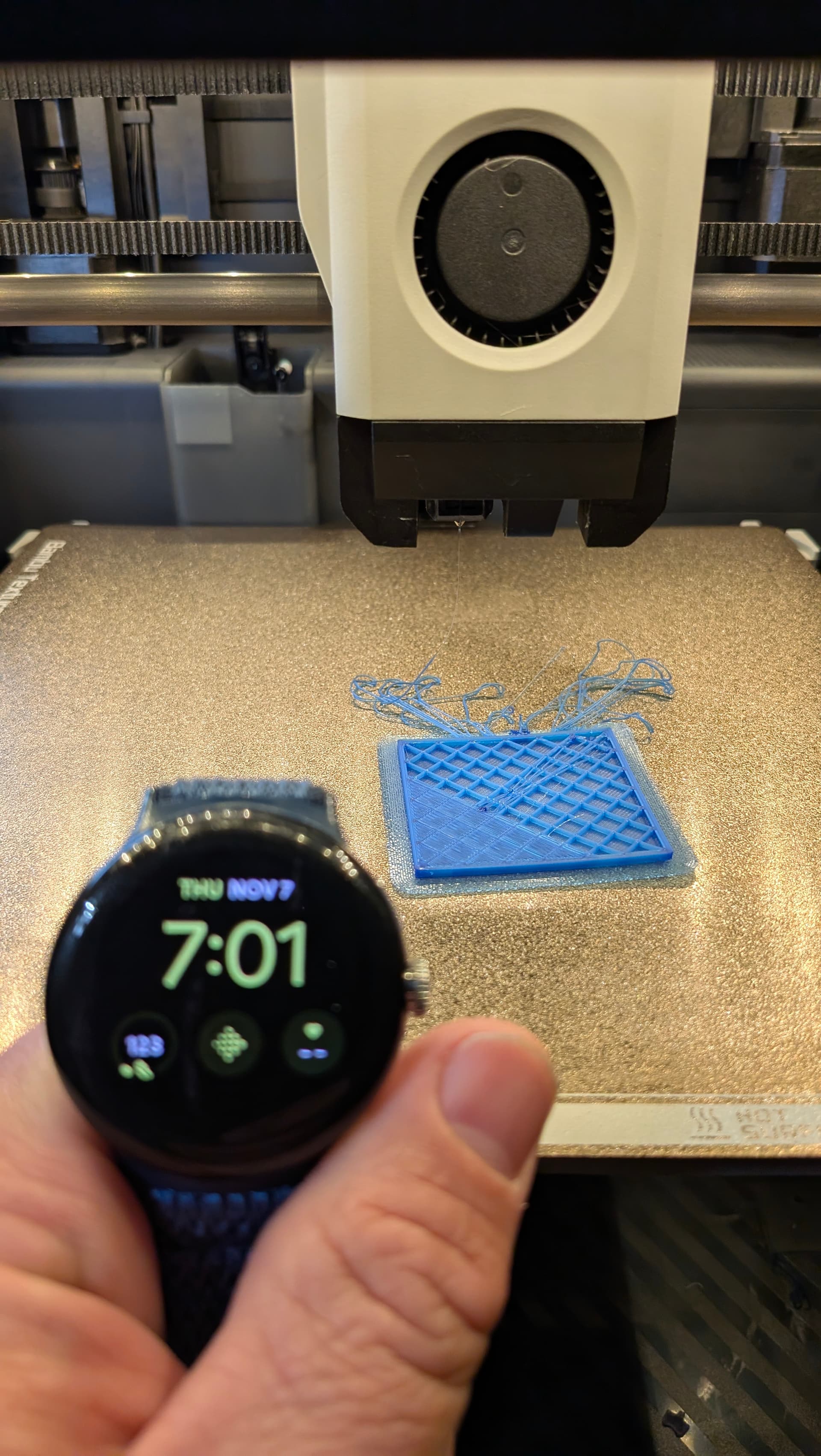

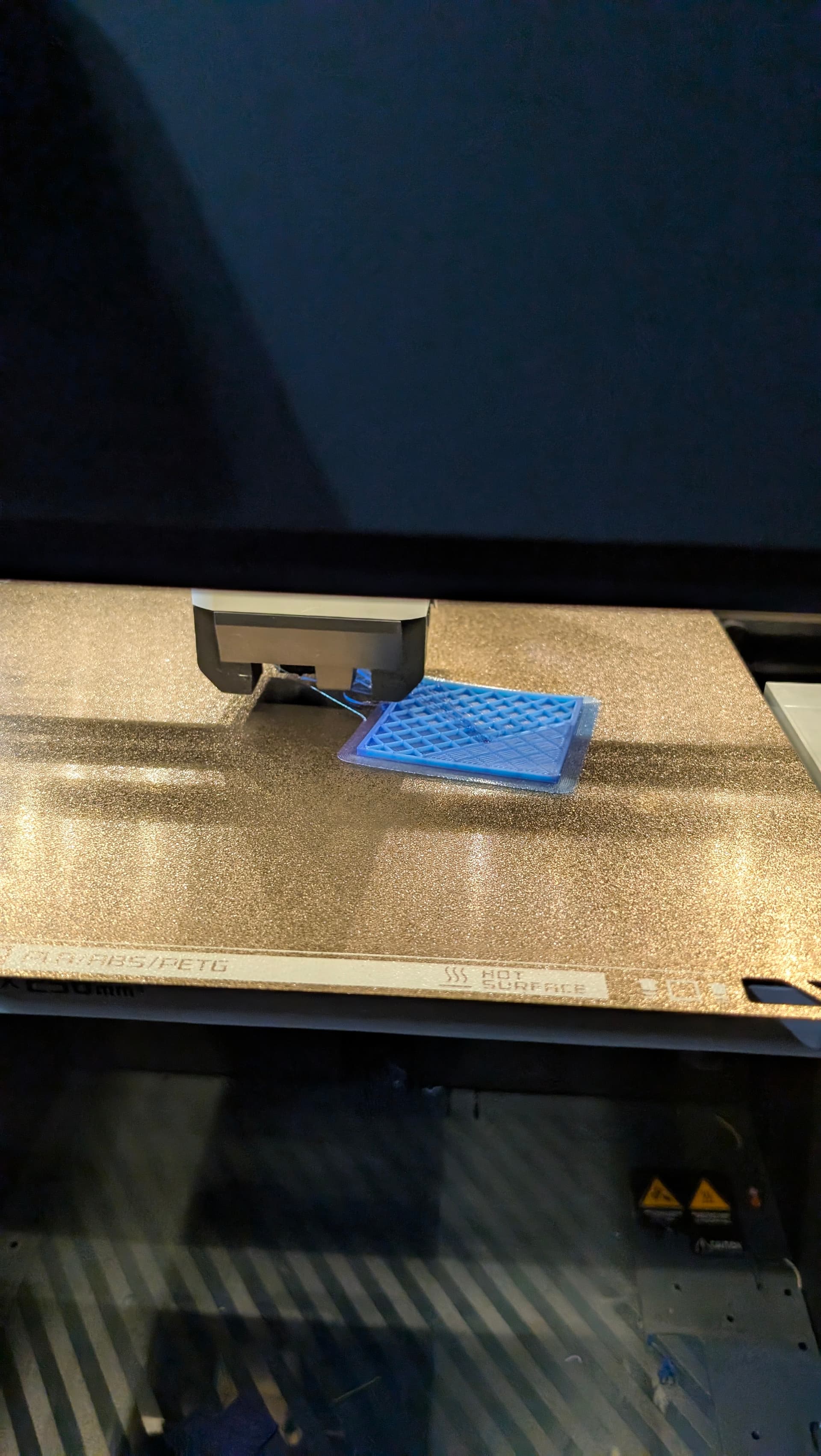

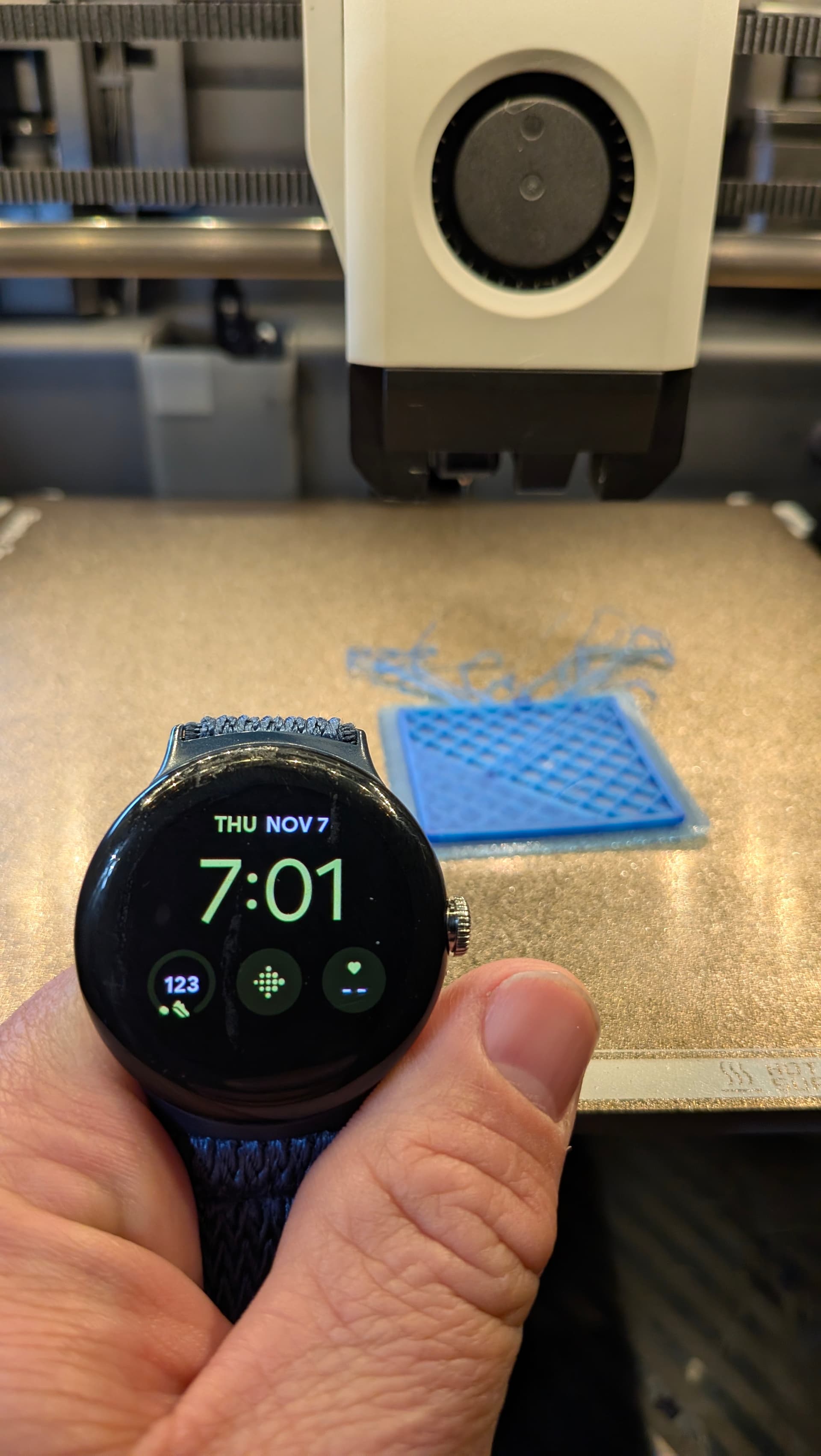

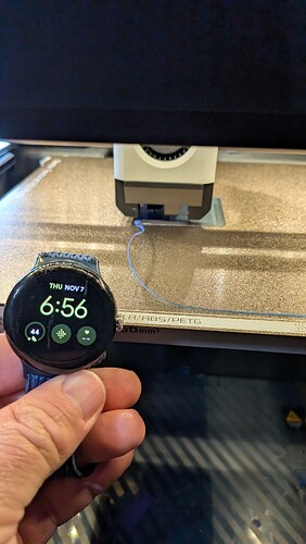

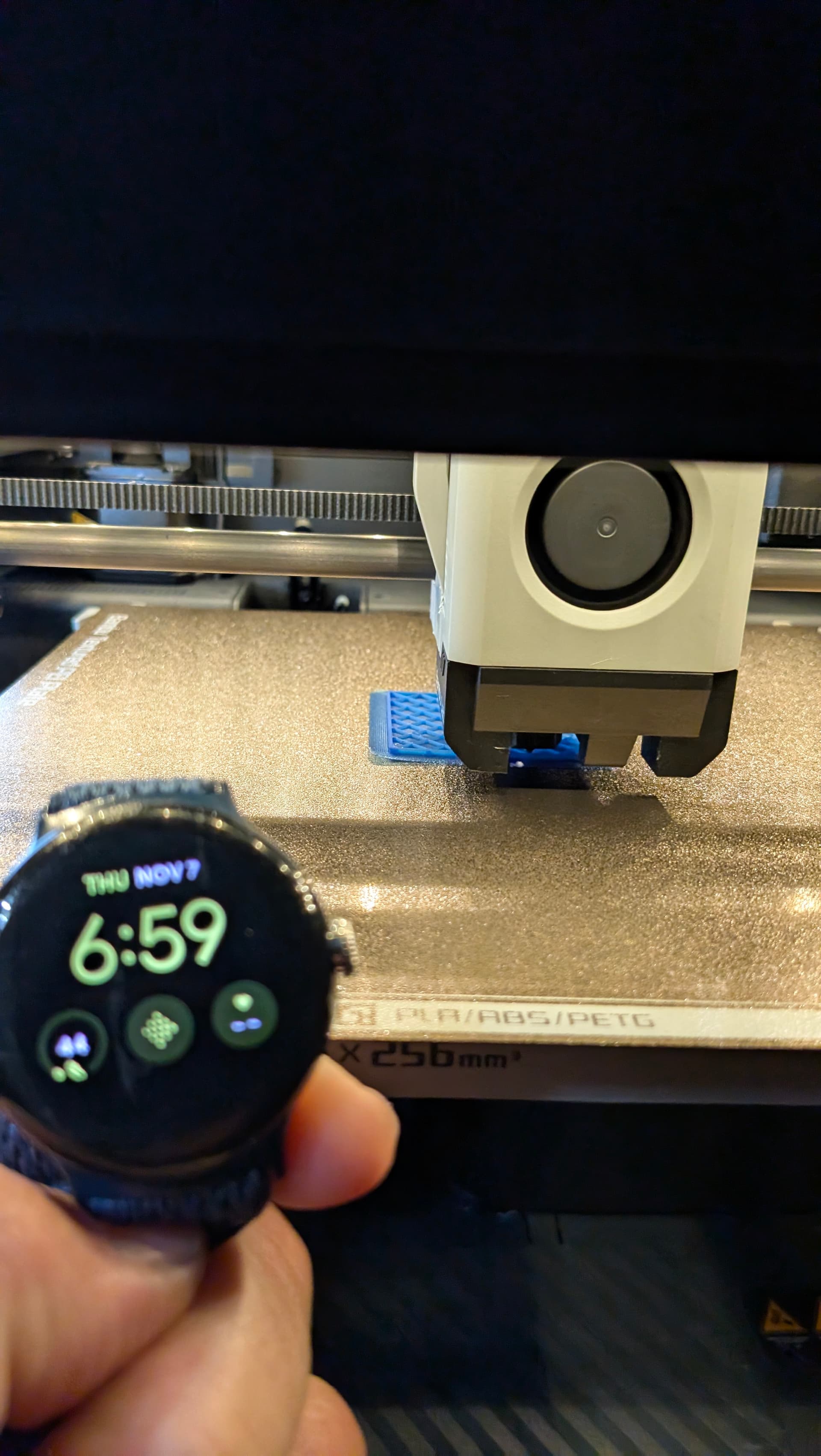

Added photos of the adhesion test that I just ran. Even included a pic of my watch with the time and date shown so you can see just how fast it lifted and lost adhesion on my gold pei plate.
You’re not running bed temps at 35 with the gold pei are you?
No. I used the profile that Bambu tech support sent me for those last failures. I think it was 55°
They finally responded to my newest ticket and sent over the settings of exactly how they wanted me to test it.
Over the past 9 months I’ve tried everything from no heat to 90° bed temp.
Each one had exactly the same results. Failure.

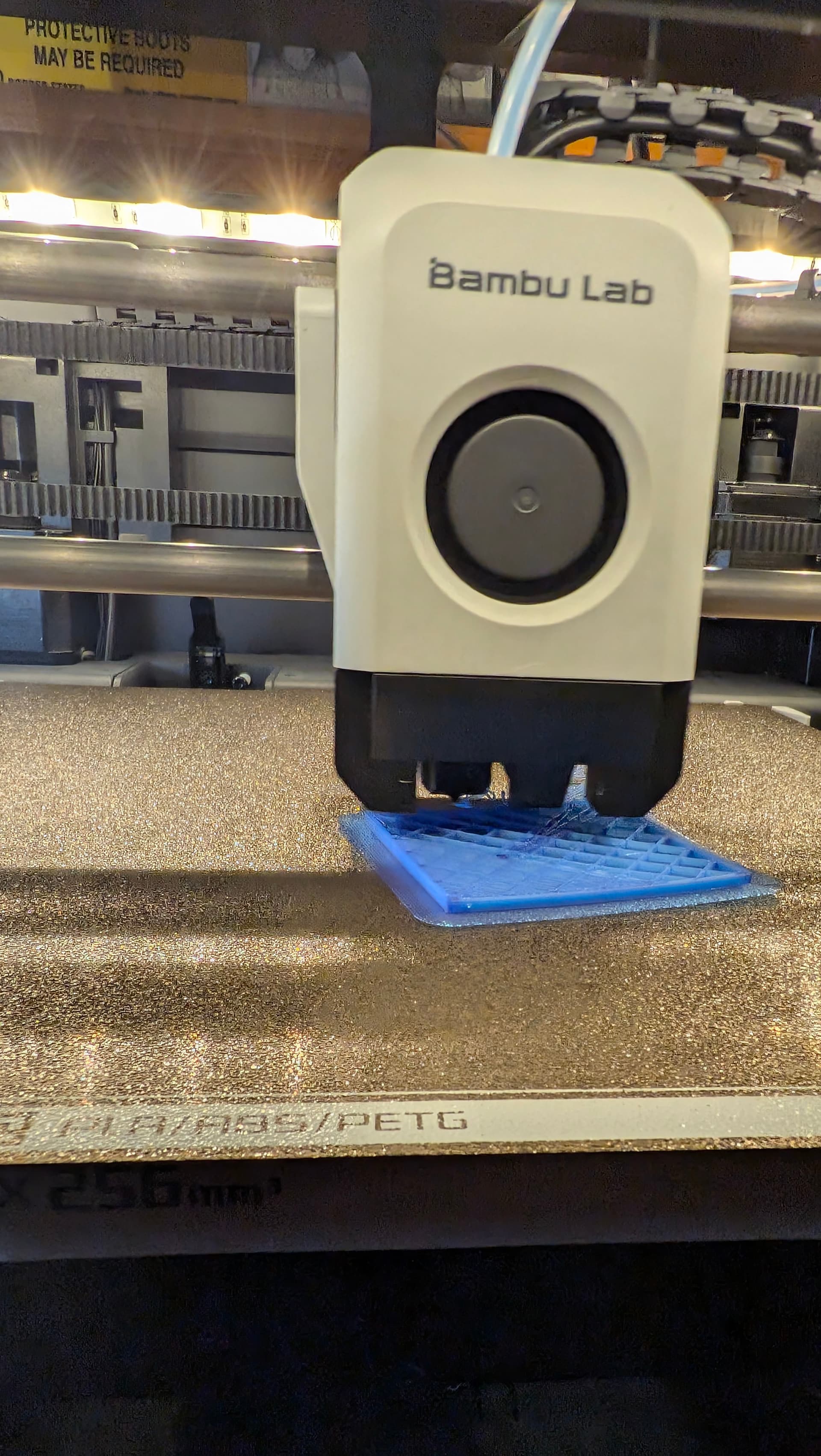

Is that a Bambu Lab build plate? Typically there is a logo dead center of plate.
Also, what filament is that?
What file are you trying to print?
It seems like some sort of test square or something.
I want to print it and see what happens.
.4 nozzle?
Some of pictures look like filament is really mashed into build plate.
You don’t need that brim and it doesn’t look like it is helping as one of those pictures you can see corner of brim lifted

I know you said the bed is set at 55, is it getting to 55? How do you know?
Looking at the prime strip curling up in front of the print, and seeing the print warp after 3 minutes in the front makes me think that the bed is not getting hot enough.
What you set it at, and what it gets to can be two different things.
Just a thought.
Says he’s got a thermal gun. Something is really fishy.
Well I’m confused though.
The 7:01 pic shows lifting on the right hand corner. A.s best as can be seen looks like the left hand corner is fine.
6:59 the left hand corner is lifting, right seems fine.
The top pic doesn’t match the 7:01 as far as what’s completed. The print isn’t paused it’s stopped.
I’m confused as to where the spaghetti came from. It’s not there in 6:59. In the 2 minutes it’s started top layer, so it hasn’t printed back there. Where did that spaghetti come from. It’s on 7:01 and the “completed” test.
Any ideas, or am I a confused old man?
You did like me and drilled in on those pictures and the pictures don’t really match the commentary.
Something isn’t kosher.
That blue filament seems translucent AND looks like the nozzle is about 1 micron above a build plate of dubious origin. Anyone have a gold Bambu PEI plate that DOESN’T have the logo in the middle?
There is one picture where it it laying down a diagonal layer yet the spaghetti and nozzle position are not at the diagonal pass.
Sometimes, these type posts, I think some folks have buggered up their printer and trying to run a scam to get their money back or a replacement printer.
Another Creality owner probably made a bunch of changes to “Make it better” and messed it the *** up instead
I’m open to an explanation. There are some…inconsistencies in the pictures.
I don’t know where my Bambu Gold plate is. Use a different PEI now, I don’t remember if it had a logo.
Yes, it is the plate that shipped with my printer directly from Bambu
Inland PLA
Brim was part of the 3mf file sent by Bambu, I printed it as they recommended. I’m not at my PC for the rest of the weekend, so I don’t have it with me to send to you
I used a thermal gun that I borrowed from a friend to confirm bed was within 1 to 2 degrees of what the printer says.
It initially lifted at the left corner, then popped loose shortly after. I let it spaghetti a bit before I stopped the print. I pulled the print from the head before I shot that last pic here are a few more I shot - I forgot to hold my watch up, but it should be obvious they’re the same print.
It’s the plate bambu sent with it. If only Bambu had pictures of the pei plate… Oh, wait, they do!
