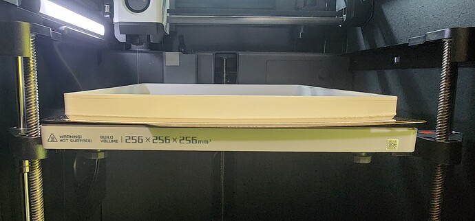

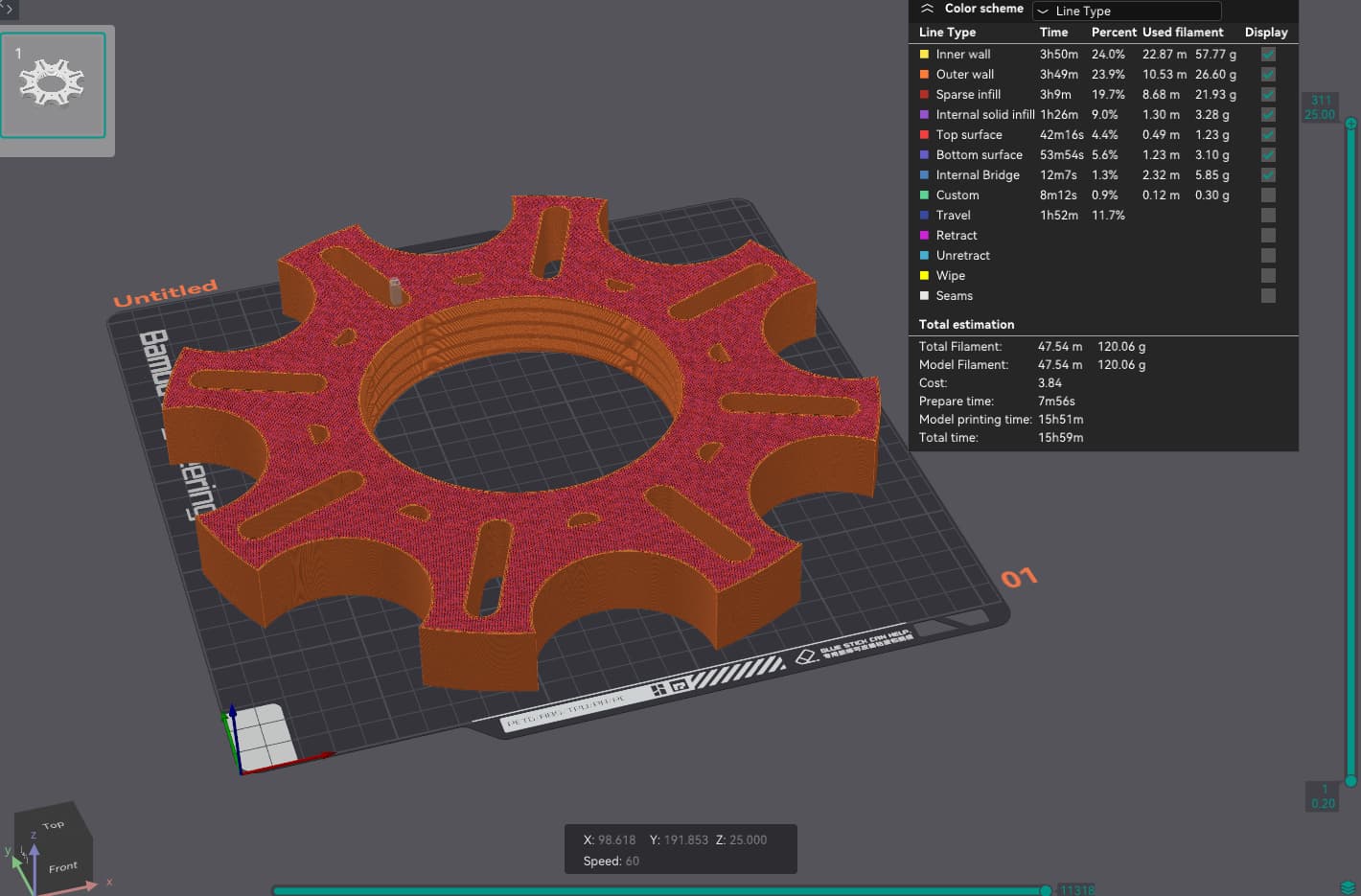

So, my ASA is sticking to the plate just fine, but it’s pulling the plate off the bed! What am I doing wrong?
I needed to print a part in ASA and it curled just a little but stayed stuck down too. I read somewhere that thick walls can make parts curl but I don’t know how thick is too thick.

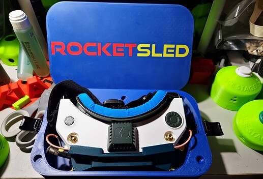

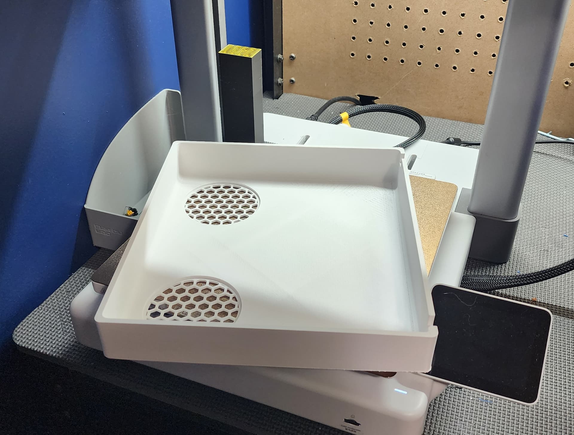

The print in the pic I posted has a 4mm “floor” and 4mm “walls”. So, it ain’t 4mm. What’s weird is, the other half of the box printed just fine with the original settings. Same dimensions footprint. The only difference is taller walls (but the failed version has failed well before reaching the height of the lid walls) and the lid has the two round grated openings, while the failed half has a square “window” in approximately the same location as one of the grids on the lid.
No, it wasn’t printed on the A1, just sitting on it for the pic lol

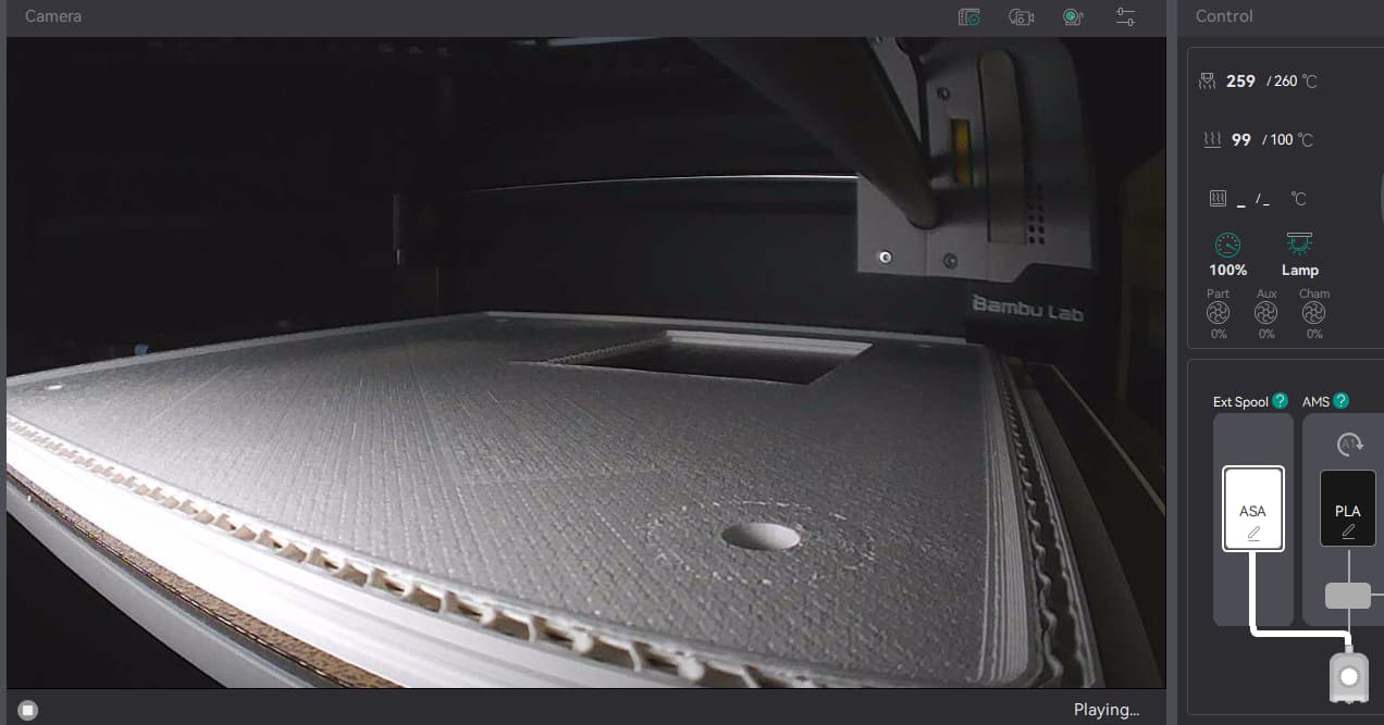

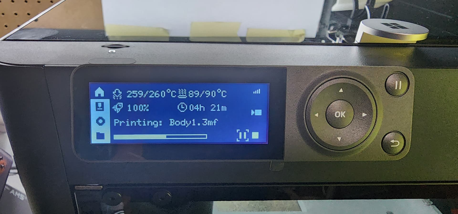

Lid and door were closed. The P1S only goes to 100 on the bed, so I cranked it there for a while before starting. I turned parts and aux fan down to 20%. I didn’t mess with the Exhaust fan, so it was probably running. Are you saying turn that off as it will keep the chamber hotter?
Despite nearly throwing the kitchen sink at it, I’m still getting some warping, though perhaps a bit less than last time.
I can tell because as the nozzle runs over the lifted areas, it emits a rubbing sound.

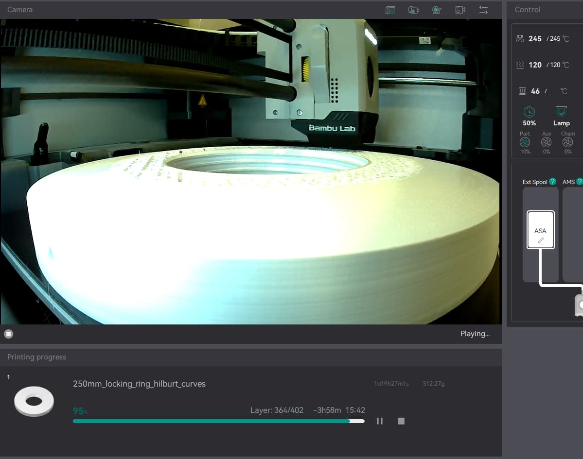

- This time I used Hilbert curves nearly everywhere: both as bottom layers and as infill.
I temperature soaked the chamber prior to starting the print. Even during the print the chamber is still registering 48C (as you can see in the first picture).
I applied vision miner to the build plate. So, just like the OP, it’s not a bed adhesion problem. Rather, the build plate itself is warping from the ASA shrinkage.
Not sure what else to try to fix on this.
- I could go with fewer bottom layers: two instead of four, at the risk of lowering the strength.
- I could go with 2 walls instead of 3, at the risk of lowering the strength.
- I could try lightning infill for the sparse infill instead of Hilbert curves.
- I could shrink the diameter, so that it’s further from the edges. I suspect this may have the greatest impact, as build plates are usually cooler near the edges. The trade-off is accepting a smaller build; or

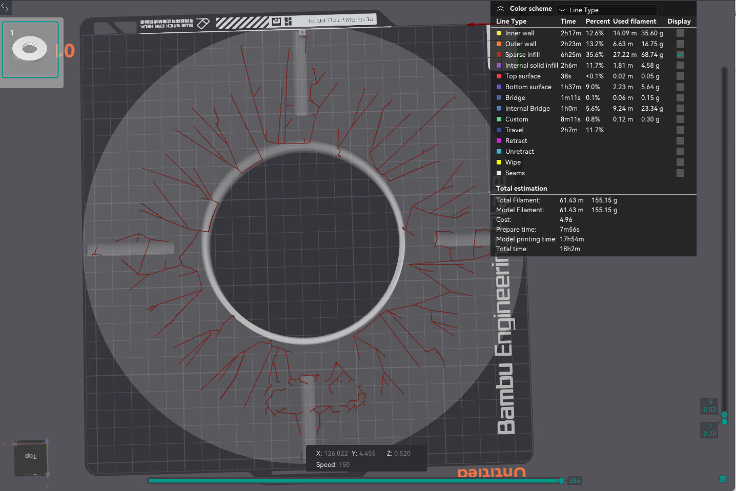

I had chosen Hilbert Curves as the sparse infill because:
- short lines, so it should reduce shrinkage
- to possibly help bolster the outside wall and resist the outside wall from shrinking in.
However, it occurs to me now a possible (likely?) unintended consequence: that using Hilbert curves as the sparse infill in this way may have created a giant heatsink that radiates more and more heat out of the bottom layer the taller it gets, causing the bottom layer to shrink enough that it eventually pulls the build plate away from the heated bed, as has happened.
I think this may argue in favor of using lightning infill, which would have less direct contact with the bottom layer. It too would radiate more and more heat the taller it got, I’m guessing not as efficiently as the Hilbert curve is doing.

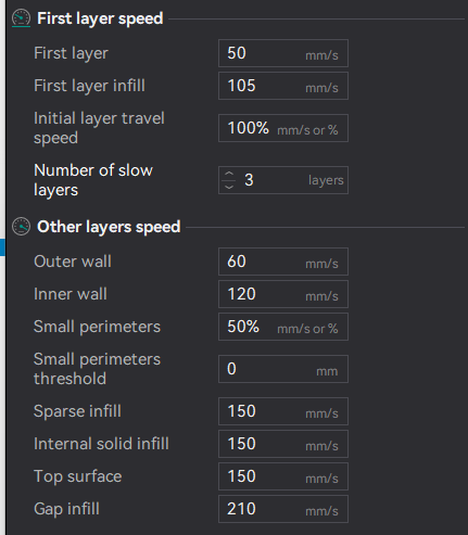

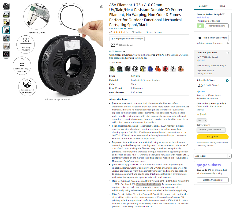

However, trumping all of that is the issue of print speed. Looking at one of the “no warp” ASA filaments on amazon, the recommended print speed is just 40-60mm/sec,
which is an absolute crawl compared to my current settings, which already seem so slow as to be bordering on impractical:So, if anything, maybe the answer is a “high speed” ASA, of which there seem to be few, but Sainsmart advertises 500mm/s for theirs:

@RocketSled My last post came less than a minute before yours, so you may not have seen it. Cutting to the chase: at what speed are you printing your ASA? A number of the posters in the “Large ASA prints warping” thread advised against going faster than 70mm/sec.

About 50mm tall. There were two separate halves, a top and bottom. Both came out fine. And while I don’t remember the speed I printed at, I can say with a fair degree of certainty that I used the Bambu generic ASA profile and default speeds. Though I may have bumped the build plate and extrusion temps up a bit.

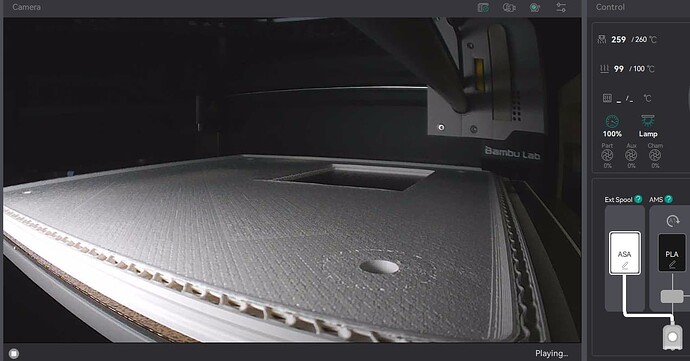

Thanks for the comments. It appears that there’s enough resilience in the X1C that it looks as though it will turn out OK by the time it finishes:

Meanwhile, back in Bambu land, it looks like Lightning may be a very good match, as very little touches the bottom layer, and most of that reaches only about 2/3 of the way to the edge:
That keeps the lines relatively short, which is a good thing.
Ironically, the print turned out almost perfectly. The problem is I had used vision miner as the bed adhesive, and it simply would NOT release. The Hilbert curves made for a rather spongy interior, rather than making for a rigid body, so there was no way to get leverage on it. In the end, the bottom layers had to detach from the rest of the model, and I’m now soaking it in water to try to get the bottom layers off the build plate. Would it have warped without the vision miner? I have no way of knowing without redoing the print and using something else.
Rather than do that, though, for my next attempt I’m trying a design which I hope will either interrupt or resist the long lines which encourage warping:
Also, on the assumption that it will work, I’ll be replacing the vision miner with a milder bed adhesive, the kind that usually automatically detaches when the build plate cools off.
