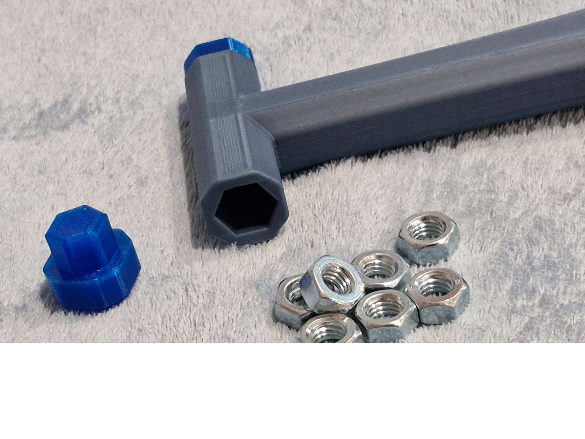

I use generally use nuts.
You can make room for them vertically or horizontally and they are more easy to refrain the movements than with balls. And the are a lot cheaper too.

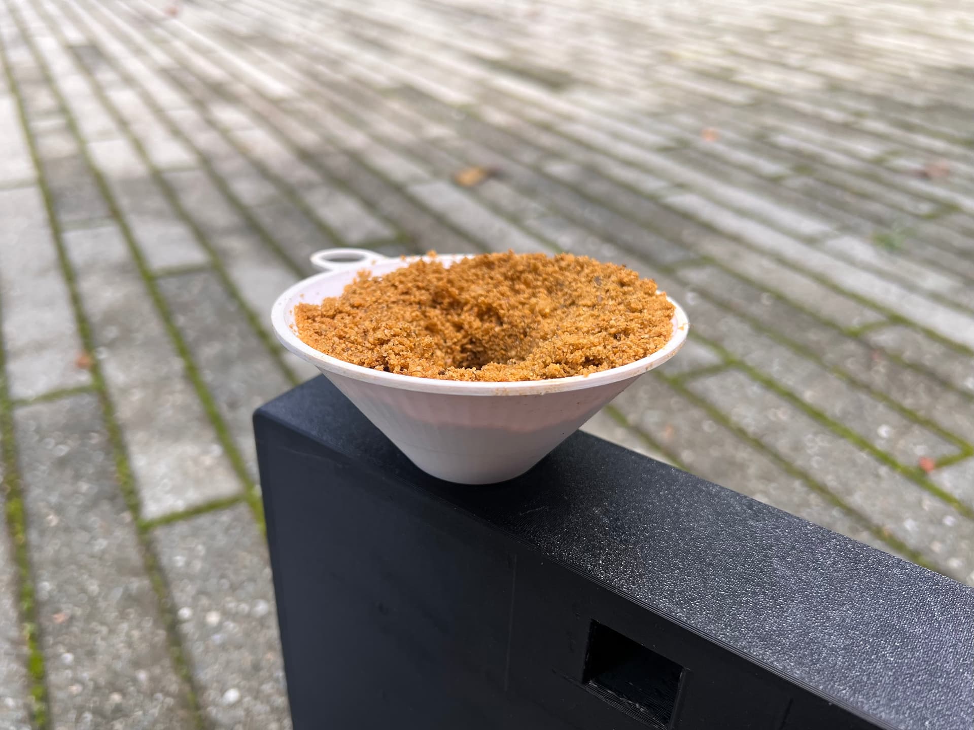

Make sure no matter what you use that it is secured. I have seen some videos where people have used sand for example and as soon as the toolhead went over it the fans blew the sand into the whole printer. You can imagine how much fun it is to clean that. Sand works generally but I would always make sure to cover it with some glue.
Yeah, @Olias posted a cautionary tale (with pictures) about using sand…
I made a bookshelf that needed a very stable base for it. It has an access port on the side that screws open and closed. It holds about 4 kg of sand. I wanted to avoid adding anything heavy to it while it is printing so the sand is all added after the fact.
This also seems like a model that MakerWorld should love to feature as it takes several kg of PETG to print the tallest versions but so far it hasn’t been noticed.
