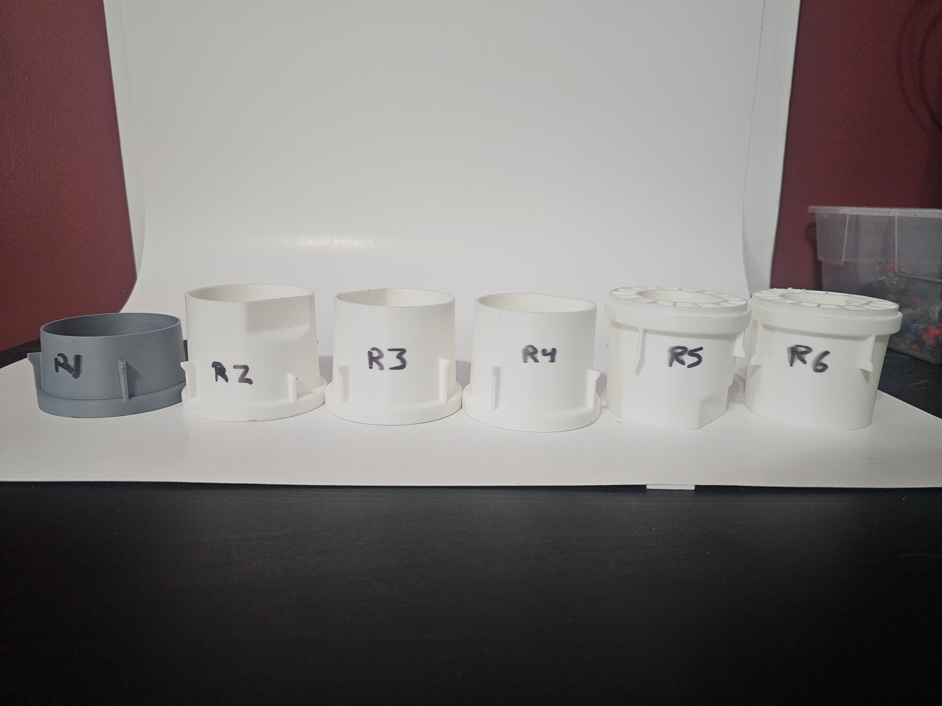

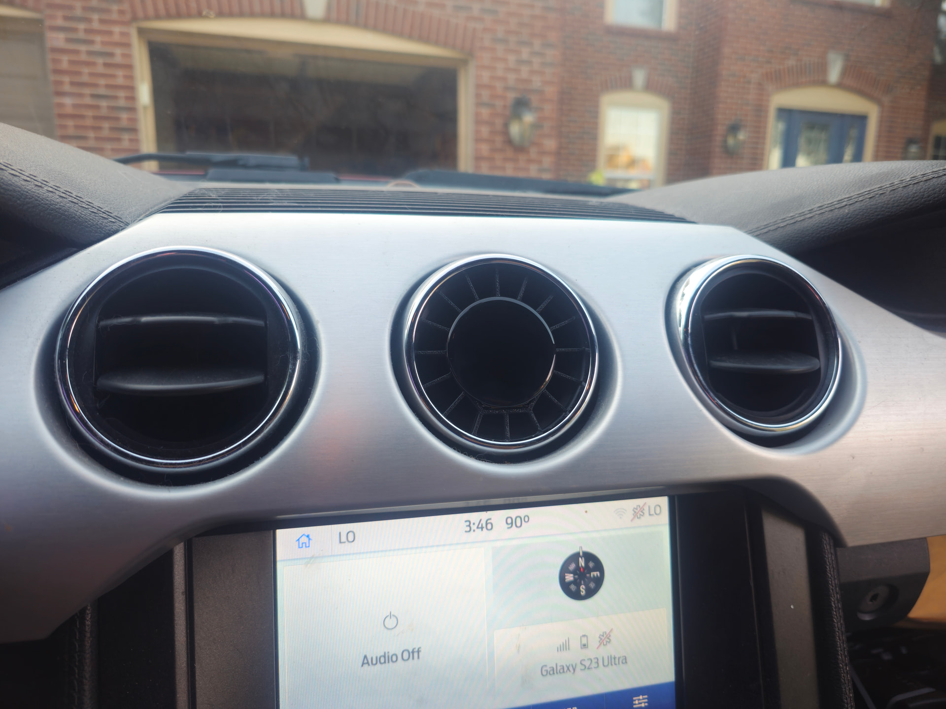

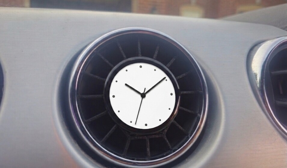

Ive been working on a fun project recently. I have been working on integrating some ESP32 screens into the air vents on my Mustang.
I am posting to share something fun, and maybe get some suggestions and feedback.
I also want to encourage more people to share what they are working on.
(Kinda hard to see with it all black)
I decided to go down the route of recreating the original venting, mostly so I could maintain my chrome ring.
Took a few iterations to get right.
The most annoying challenge was figuring out what size of screen I wanted to use. I originally used a 1.75 inch screen, then switched to a 1.46 inch screen to allow for more airflow.
Right now I am at the stage of deciding the best way to power the unit. Its an easy USB C connection, but took some creative modifications to get everything to fit. I am either going to tie it into the USB ports on my car, or do a fuse box splint to completely hide the wires. I am running it off a power bank right now, but thats only a short term solution.
The programming side is going to be the hardest part. I have a good amount of experience with Pi based machines, but nothing with a UI. Thank god for Claude Code, I was able to get a simple clock.
I am hoping to eventually copy it over to all 3 vents, then tie it into the sensors on my car so I can display gauges for Boost, Trans temp, etc. I also have a cellular modem in the car, so maybe something like a Spotify UI, but that might be redundant with having Carplay.
I favour the fuse box or, alternatively, a breakout connector for power behind the car radio. Some car radios even have a switched power output at the back for external hardware, such as an external camera, which is also powered. Although ‘radio’ doesn’t quite cover it anymore - let’s call it a multimedia hub.
The fuse box definitely has a switched output. For the multimedia system, you’ll need to check the datasheet, but that’s usually the case as well. Then you can turn on the screen when you start the car.

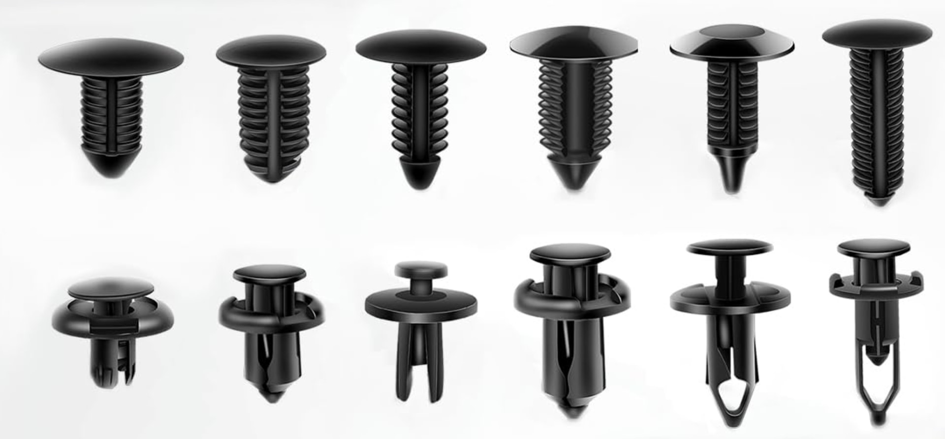

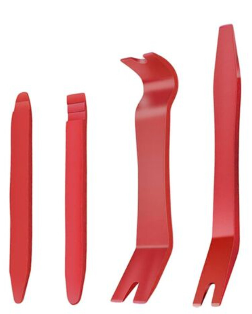

If you buy one of those plastic levers, you probably won’t even have to remove the front panels; it’s usually enough to just slip a cable in without taking anything off.
If you do decide to remove the panels, don’t forget to order the brackets beforehand - they’ll break off, which is by design, and you’ll have to replace them. Not all of them, but some variations of them.
Of course, I don’t know if that’s the case with your car! Some manufacturers use them, while others use reusable clips. They also look different depending on the manufacturer; here’s an example picture.
Sadly no breakout connectors on the radio. I replaced my infotainment system with one from a 2022 a few years back, so I pretty much know the ins and outs of that system.
The reason I am debating on whether to do the USB or fuse splint is because I already have 2 splints on my fuse box powering my radar detector and dash camera. Which I need to figure out if and where I can draw more power, while with the USB route, it is guaranteed. Plus the fuse box is 12V ( ESP32 boards use 5V), so I would need to mount a buck converter somewhere in route.
Appreciate the advice on disassembly. I’ve been working on cars for longer than I have been 3d printing, so everything is handled on that front.
Good thing is that Ford uses reusable connectors almost everywhere. Of course that doesn’t stop them from breaking on occassion. Funny thing, about 20 of those connectors in my interior are printed.

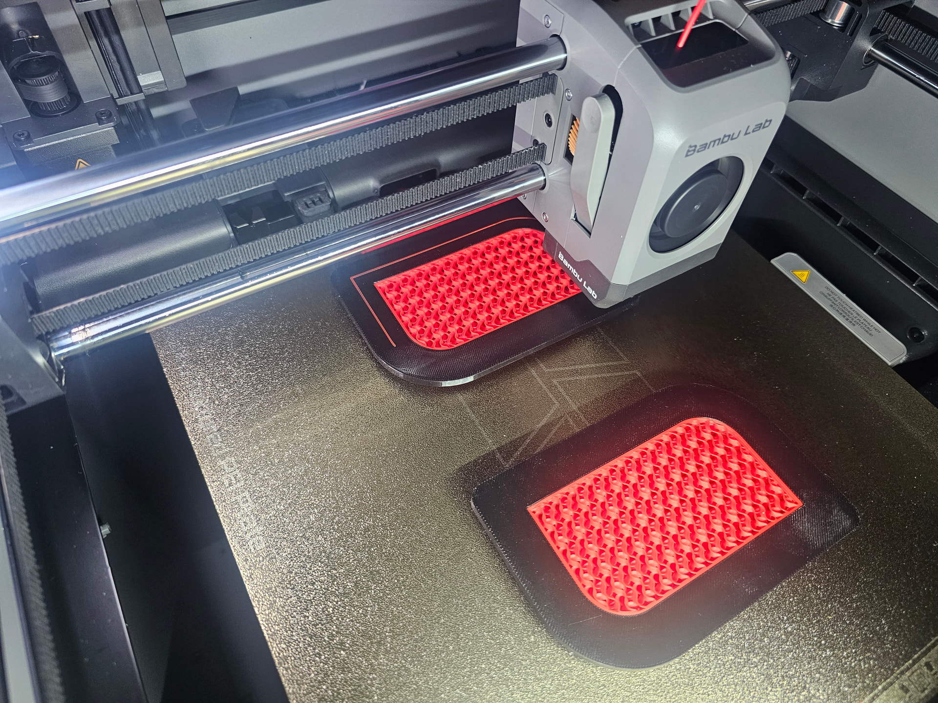

My local animal shelter is doing drive to collect pet accessories so I have been working on making some of my pet hair brushes to donate.
Always so satisfying how these go together. I print the tpu brush part first, then inlay that into the handle while it is printing, pretty much making it permanent.
20 down and about 30 more to go.

It’s nice, Cincinatti, but there is a digital clock right under it. Unless you like the bigger clock face with hands. But it does add a custom touch.
The clock is a proof of concept because it was easy (ish) to program and didnt require any outside sensors.
The end goal for that project is to show engine details: boost, real time octane, and Trans temp.
But the sky is the limit with dev boards.
