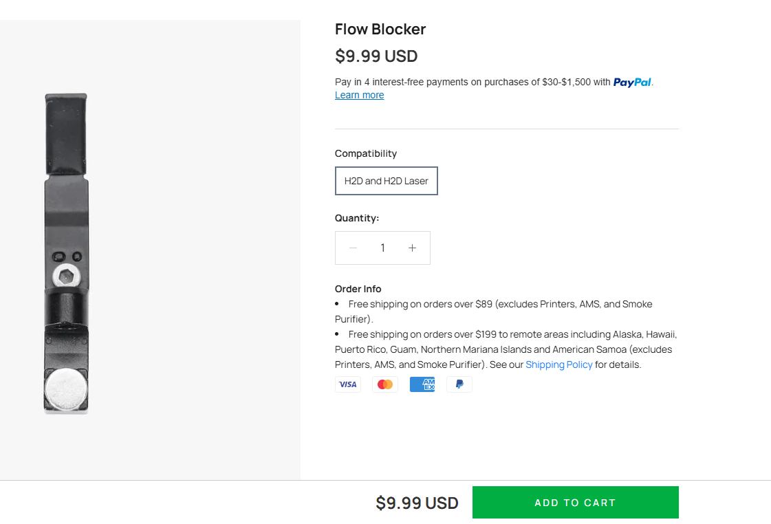

Revision: Official name for ooze guard is actually “flow blocker”:
I figured that’s what you probably meant. Like you said, it seems to only be available as the full assembly:
