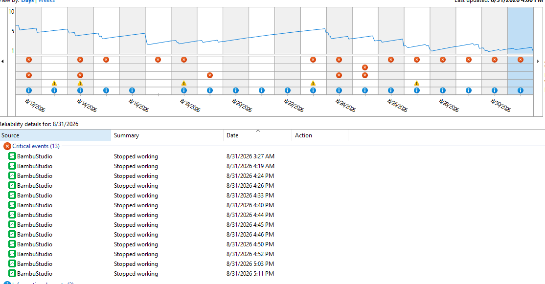

I confirm this is a problem for many. Will they ever solve it? It started recently (probably 2.7 and onwards for me) but now, it is absolutely impossible to work with. CTD with no warning or message reported after 1 - 5 minutes:
Description
Faulting Application Path: C:\Program Files\Bambu Studio\bambu-studio.exe
Problem signature
Problem Event Name: APPCRASH
Application Name: bambu-studio.exe
Application Version: 2.8.2.61
Application Timestamp: 6a871932
Fault Module Name: bambu_networking.dll
Fault Module Version: 0.0.0.0
Fault Module Timestamp: 6a7ef3c3
Exception Code: c0000005
Exception Offset: 0000000000d5447a
OS Version: 10.0.26200.2.0.0.256.48
Locale ID: 1033
Additional Information 1: 9e47
Additional Information 2: 9e478dc24b18afd38fb6ead21530ed9a
Additional Information 3: a76f
Additional Information 4: a76f0f07961a52b8743c604c824705de
Extra information about the problem
Bucket ID: 0196c615833365eabf84a3249f0217bc (2271119489783437244)
I have P1S and H2D and 4 AMS units, cutter… paid a bunch of money for this garbage. Let this be a testimony of how ‘good’ your ■■■■■■ software is:
Have you logged an issue on github? That is probably the best way to get in contact with developers.
