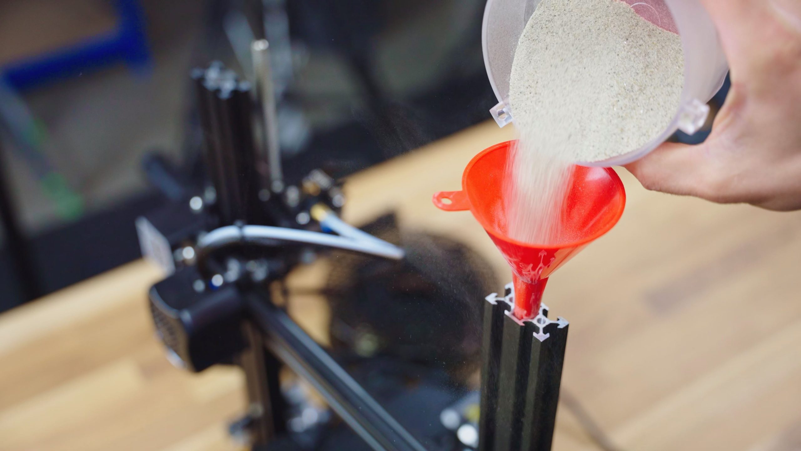

Tom Sanladerer set out to test the effects of some different kinds of damping and printer orientations, and in some cases he found that results were actually worse than with no damping at all:
