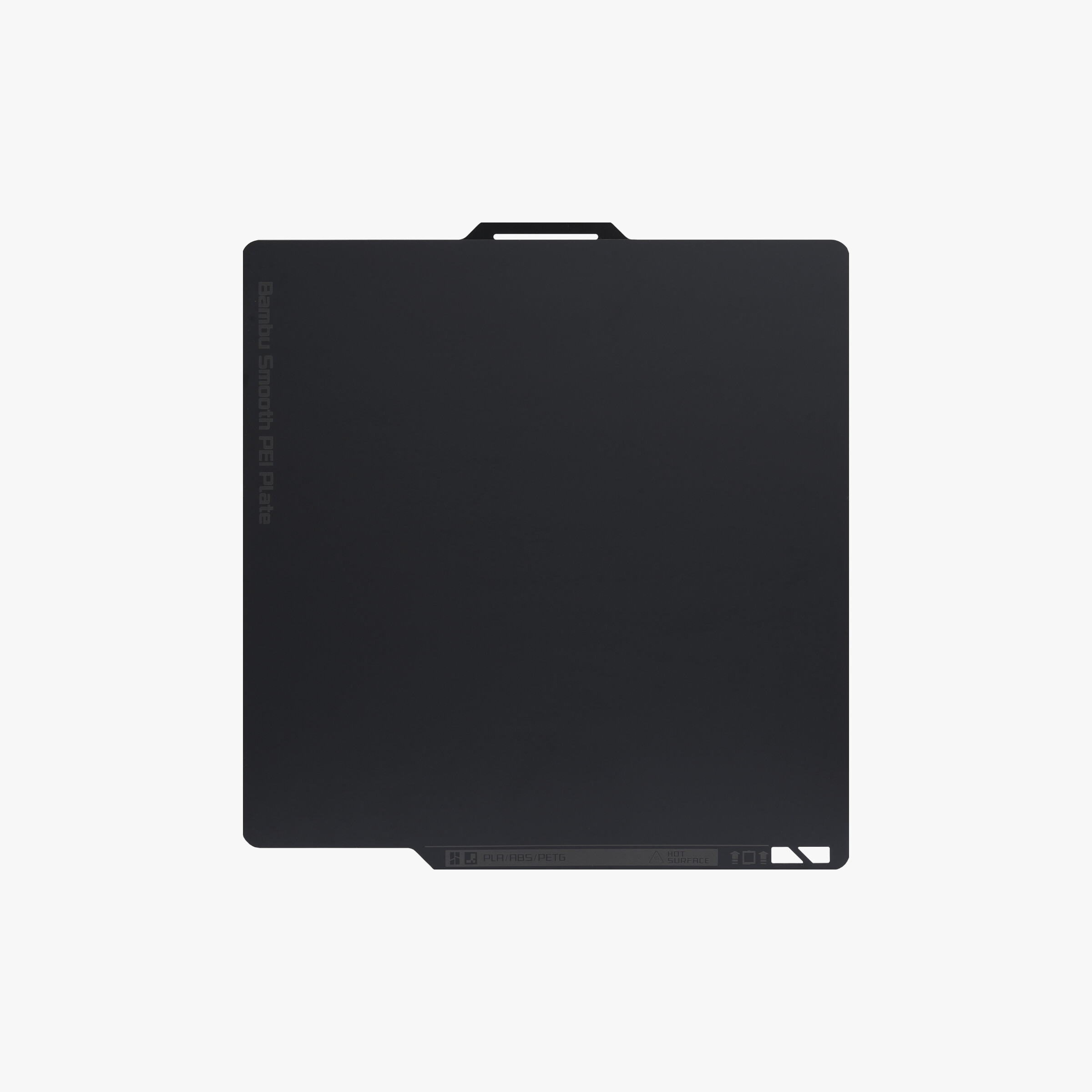

Where to buy more H2D build plates?
The Bambu store doesn’t appear to sell any. AFAIK, it never has. So, what would be a good third party alternative?
Well, I’ll be danged. I guess it just wasn’t where I was looking. Thanks!
