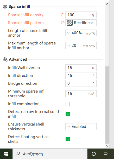

Out of curiosity, what infill do you use?

Another method to achieve a good 100% infill is the use of 999 wall’s. Works great in particular when coupled with the Arachne wall generator.

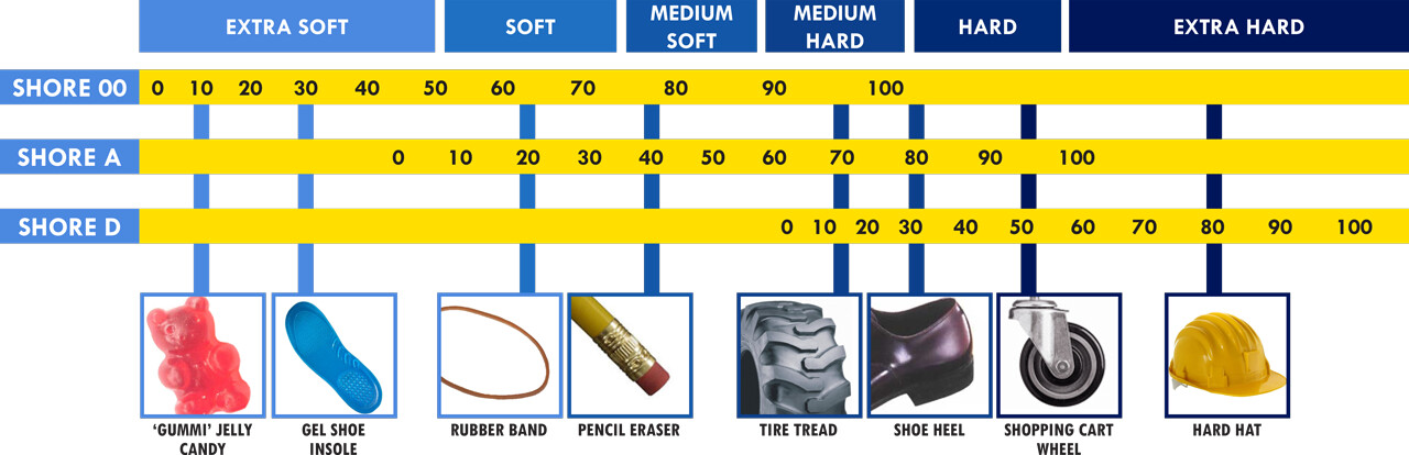

With TPU, a large range of hardnesses/flexibilities is available. TPU with a hardness of 85A, the softest available from Bambu and quite challenging to dial in, is about as soft as the sole of a shoe (when printed solid). The more commonly printed TPU 95A is about as soft flexible as a skateboard wheel while the TPU for AMS (I recall shore hardnesses of either 63D or 68D) compares to the flexibility of a golf ball or a wooden yard stick.
So, flexible is a very relative term.
Good info here. Just be careful with the “shore” designation, it appears the 63D and 68D would be harder than the 85A and 95A.

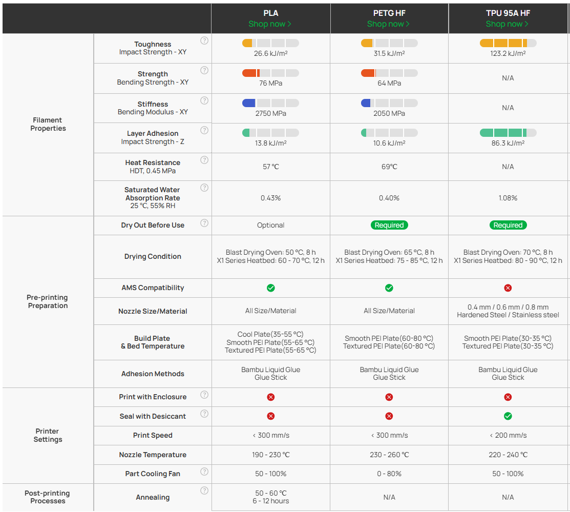

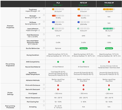

From the Bambu filament guide:

For an open-frame printer like the Bambu Lab A1 Mini without an enclosure, PETG or TPU are the best, toughest choices to use instead of matte PLA, which is extra brittle. [1, 2]
Why Matte PLA Cracked
  • Additives: Matte PLA has agents added to kill the shine, which sacrifices significant layer bonding and impact strength.
  • Brittle Nature: It shatters easily upon hitting hard objects like rocks. [1, 2, 3]
Best Filament Options for Your A1 Mini
  • PETG (Standard or High-Impact):
    • Much tougher and more flexible than PLA, so it bends slightly instead of shattering on rocks.
    • Prints easily on an open bed-slinger like the A1 Mini without warping or needing an enclosure.
    • Resists water and sun exposure well. [1, 2, 3, 4, 5]
  • TPU (95A Hardness):
    • Nearly indestructible against hard impacts because it is rubbery and absorbs shock.
    • If printed with high or 100% infill, it behaves like a hard plastic tire or skateboard wheel rather than a floppy cord.
    • Prints safely on the A1 Mini, though you must feed it directly from an external spool rather than the AMS Lite. [1, 2, 3, 4, 5]
