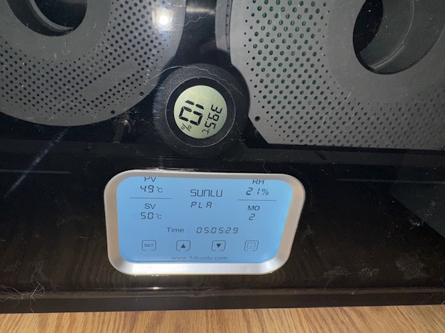

Why does Sunlu S4 say 21% when meter says 10%?
I thought maybe the spools that were sitting on my AMS Lite were getting “wet” after being on there a month (PLA Basic). So I got a Sunlu S4 dryer (in case i need to print from it in future summer months). After running one session, the humidity in the dryer in the “maintain” mode was listed at 32% even though room RH is 10%, so i thought, nice, it squeezed some moisture out. But then I was doing another set of spools and dropped in the second RH meter in the dryer.
Anyone know where the S4 senses RH that is displayed on the screen?
The RH meter I got off Amazon says my room is 10%, the meter I put inside the dryer with some filament also says 10% after being in there for 30 min.
Yet the Sunlu dryer says 21%, significant difference.
Anyone know why?

Id go for that, save that the little cheap sensors are at their minimum RH (10%) both inside the case and in the room mounted on the A1 crossbar.
Plus the temp on the one inside the S4 is 39.6c when the control panel says its at 50c, so its definitely not making the air 50c.
Your answer lies in your photo. RH is function of how much water vapor the air at a specific temperature can hold. In your case, the sensors show a 10c temperature difference.
Here’s an over simplification of what that formula looks like. In short, a hotter environment can hold more moisture.
However, in the case of your circular hygrometer, it looks like the humidity sensor has failed. the 10% reading is indicative of a failed sensor. I recently found out why. These sensors have a coating on them. If they were mishandled(someone touched them during manufacturing) or somehow the chemical coating was worn off, they will stop reading accurately and eventually fail.

I think my room is just very dry, if i breathe on the hygrometers the go up. 10% is the minimum spec, so maybe just bottomed out, but now that you mention it, they are not reading higher, so maybe they were “stuck” at 10% somehow.
Thanks for the detailed reply though. I think the S4 will dry filament, i just dont think ill trust the readings too much. Im sure its 50c somewhere in there, just not the air temp.
