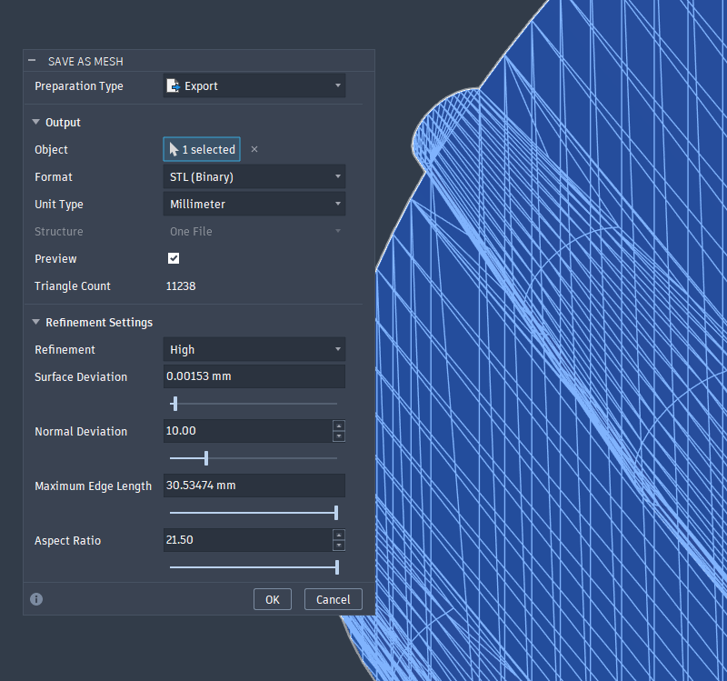

With STEP import into Studio, the number of triangles created (the resolution) is going to make a big difference. Personally I find the two sliders in Studio to be inadequate to determine the proper resolution, and prefer to create the exported mesh in Fusion, where I can get a preview and more controls (“Save as Mesh”). Also simpler to recreate since the export settings are saved per project. Contrary to sometimes-popular belief, all the slicer does with a STEP is convert it into a triangle mesh anyway (same as STL and 3MF), then slices using the mesh.
Cheers,
-Max
PS. The Fusion mesh dialog I'm talking about:
