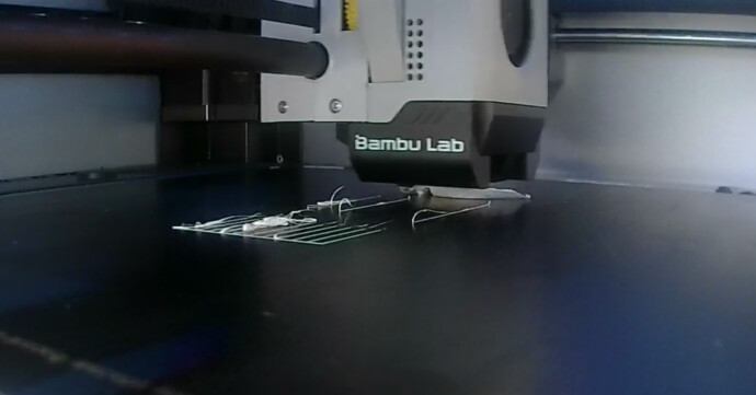

Thanks @Alex_vG - OK, this is an example of a print which I have been trying to finish all evening. This failure is on a brand new Bambu Lab Smooth PEI plate and I have also used the Bambu Lab glue stick. I am using a 0.2 stainless steel head and am printing in PETG. The print is a 3 colour print (red, black & white), but as you can see it has failed before it even attempted the white. I wasn’t watching when it actually failed, but the print order is red, black then white - so it looks as though it failed during the black filament printing…
Previously when I get failures like this, I run the tramming gcode and close the gap between the head & bed and it will print fine… but clearly this isn’t right as you shouldn’t need to ā€˜tram’ every time you print on the X1C.
Also, my filament is dried using a Sunlu S4, and in the AMS the humidity is at 10%. The black & white are genuine Bambu Lab PETG HF and the red is a generic PETG filament (Overture).
For perspective, the diameter of this print is about 40mm.

The printer does a ā€œhomingā€ operation to locate the build plate. Right after it cleans the nozzle, it moves to the center of the plate and does this tap-tap-tap thing with the nozzle. That’s the printer figuring out where the build plate is.
It does this every time it prints. It can’t have too big a gap unless it didn’t get the nozzle tip clean and there’s a blob of plastic sticking out when the plate is probed.
So every time you raise the bed, the printer finds it at the new, higher position and does exactly what it was doing before. This can’t really be fixing anything.

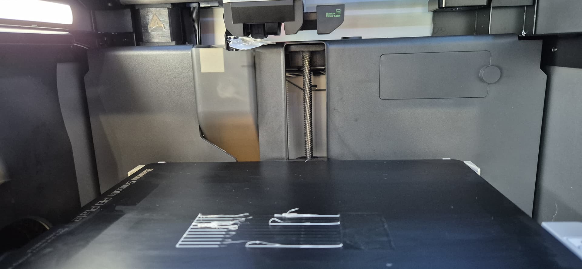

Not sure the manual calibration is meant to look like this :frowning:
Hard to determine the best line to be honest lol
How fast are you printing the first layer?

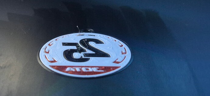

The pictures you posted (including the ā€œ25ā€ medallion) make me 95% sure you need to wash your plate. Extrusion and adherence is OK in the clean areas.
Use warm water, grease cutting dish detergent, thorough rinse, dry with clean towel, do not touch the surface.

40mm/s (default setting) for initial layer @silver118822

I can confirm that the plate is clean… I washed it in exactly the way you described then applied some gluestick as previously I have had issues with prints using the 0.4mm head sticking too well. So far, am impressed with the improvement the Bambu gluestick makes.
I am running a new print at 260°C / 80°C as suggested by @L0rdS474n and it seems a lot more promising, so will wait a few hours and let this one complete and see how it turns out…
May tweak a little more to improve it - perhaps slow the initial layer down - I did also increase the initial layer from 0.1mm to 0.16mm to see if that would help!?!?

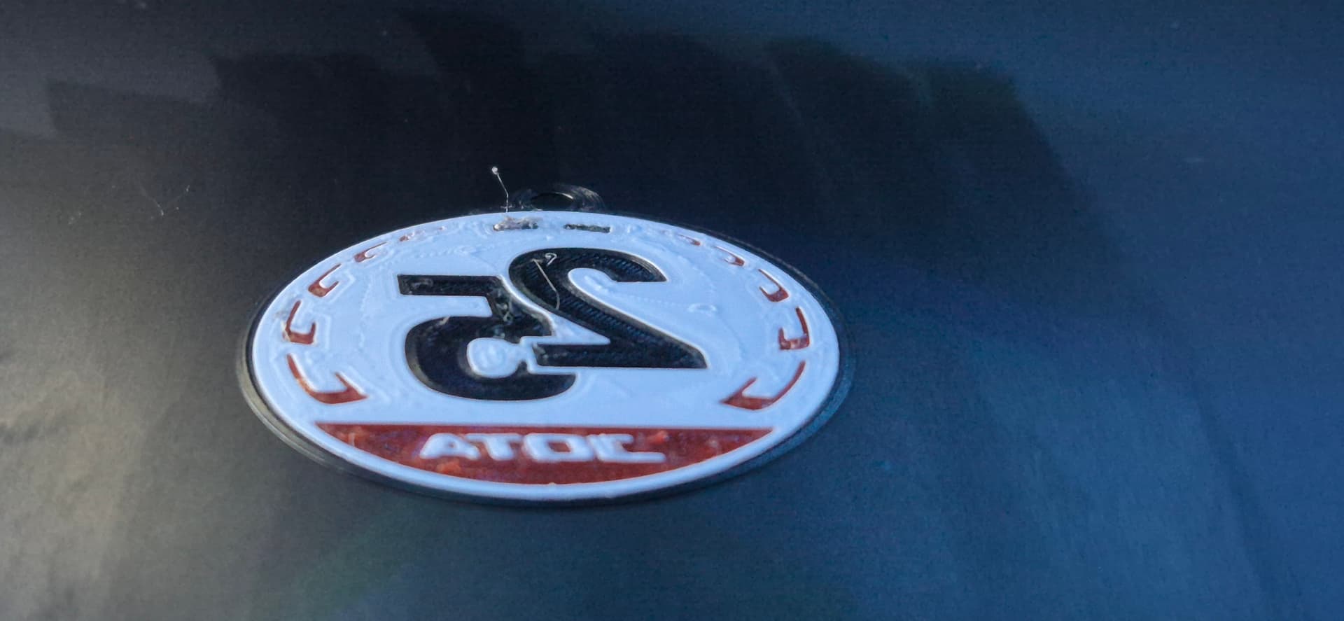

Thanks - I’m still not 100% sure that this will look how I need it to, but will know in about 3 hours!!
One interesting thing I have noticed is that a lot of people have posted that they are struggling with bed adhesion when using Bambu PETG HF Light Grey… which I have big issues with this one too - so wonder if its not particularly good quality… also have struggled with Bambu PETG HF White - had better results with Overture white to be honest.
But I guess I just need to play more with temperatures to start with as 260/80 seems to have made a marked improvement :smiley:
This looks much better, so it may be close to your solution. Please keep us updated.
