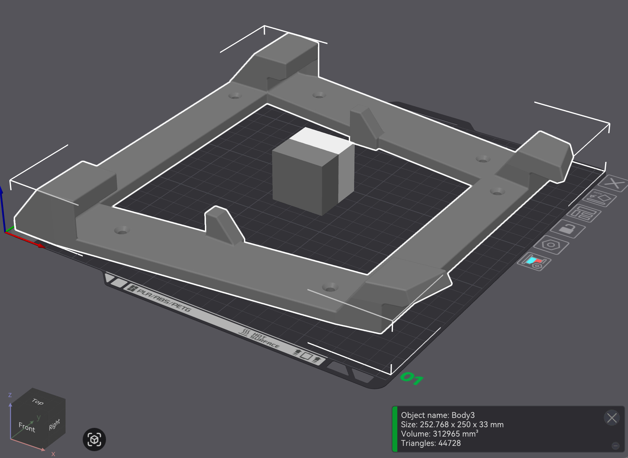

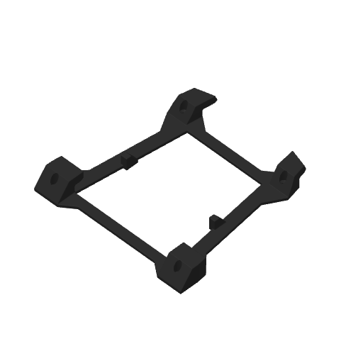

A couple of days ago I started designing a wall mount for a top case of my motorcycle. It’s basically a trapezoidal frame with a hook at each corner.
It’s a tight fit on the bed but the first prototype out of PLA turned out great. Only after some minor adjustments on the design I went ahead and attempted the final print out of ABS.

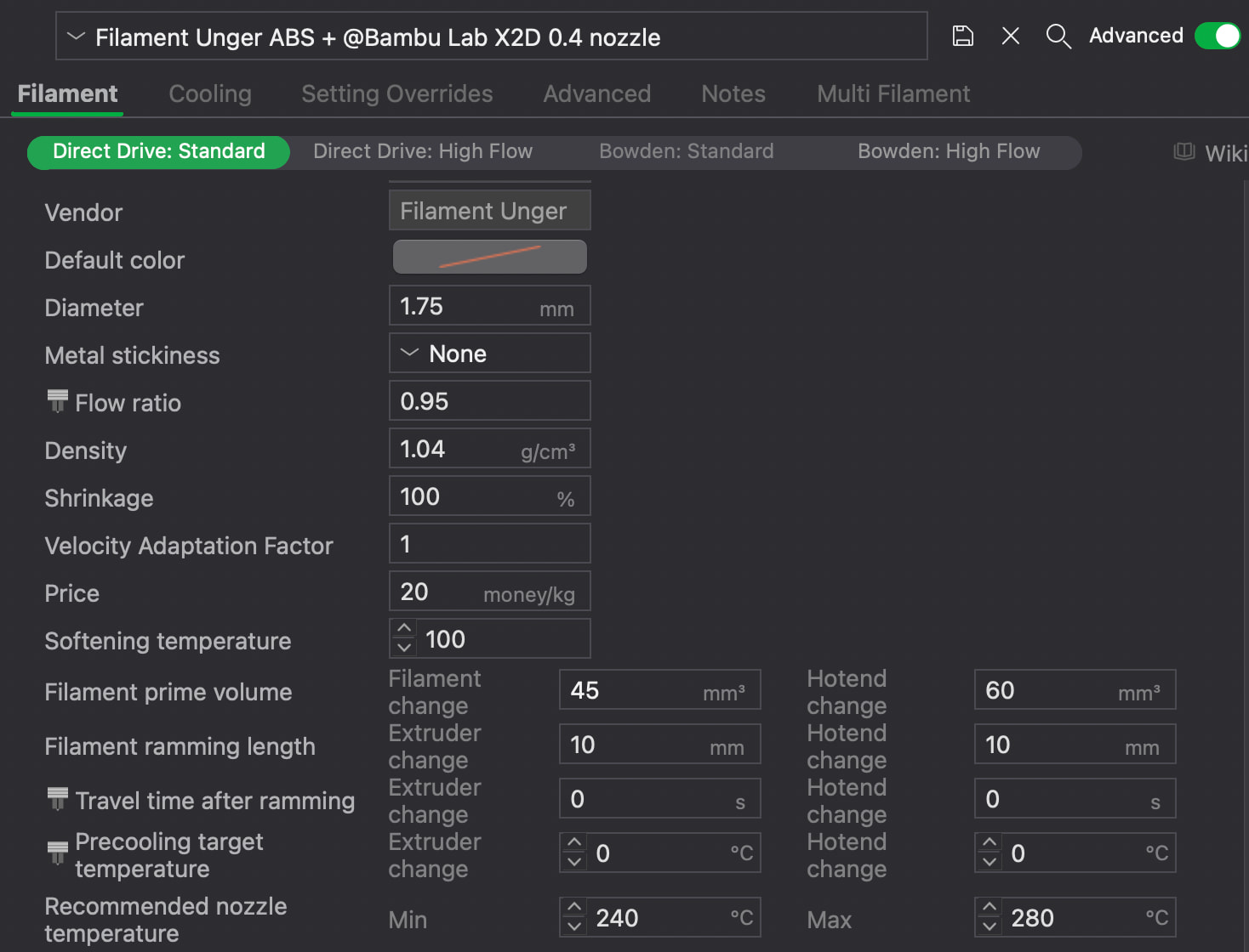

I have a spool of ABS+ from a German manufacturer I used for other smaller prints before. The quality of those has been great and the printer had no issues with it. The manufacturer even provides optimised profiles for Bambu Lab printers. Those profiles only show minor deviations from the generic ABS profile though. My only initial adjustment was raising bed temperature from 90 to 100°C to improve bed adhesion on the textured PEI plate since I had some minor issues there before.

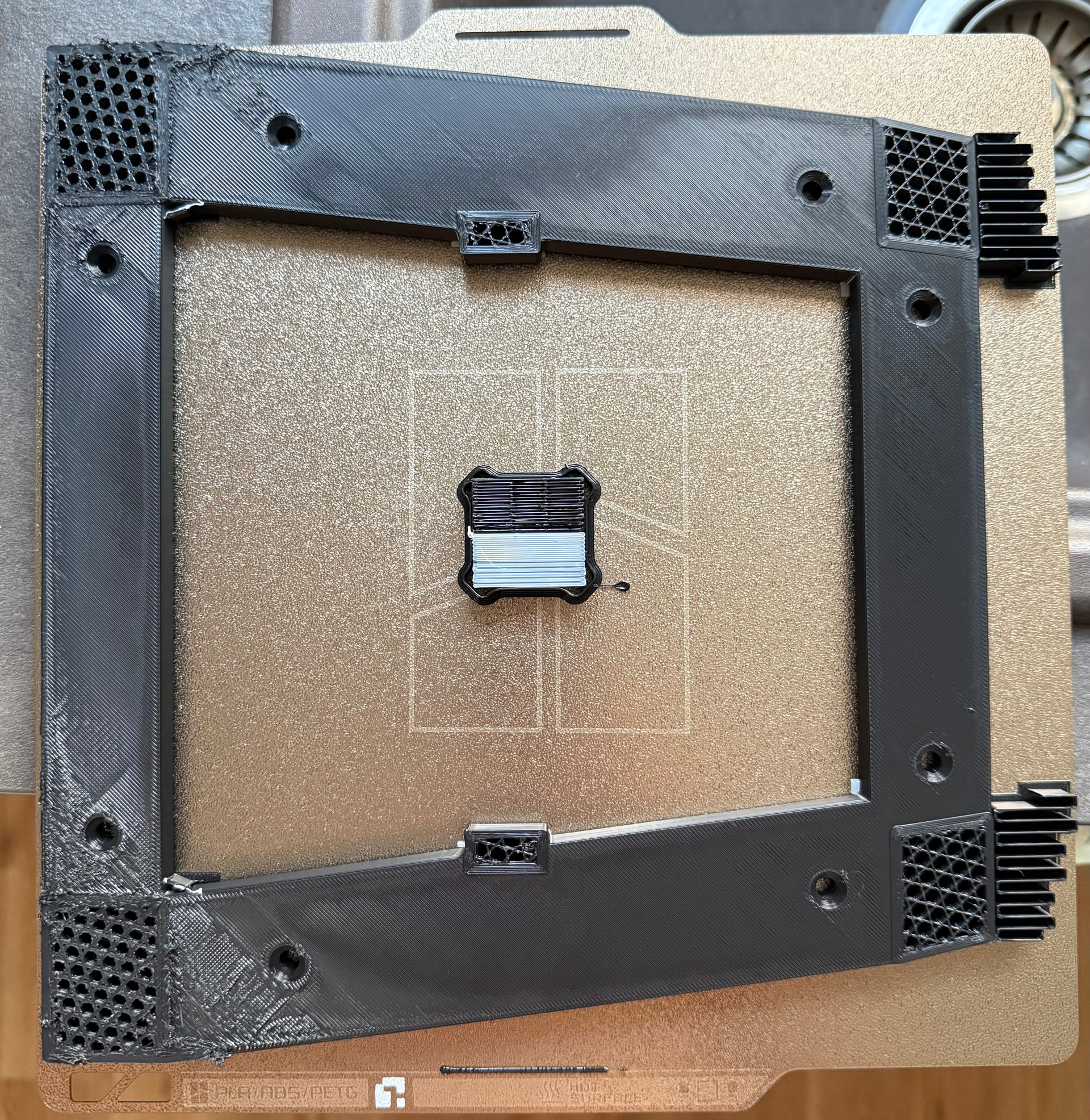

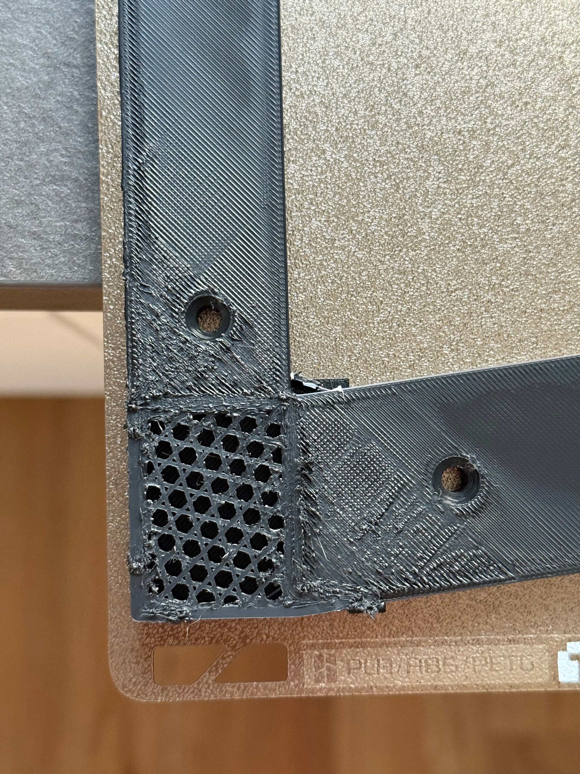

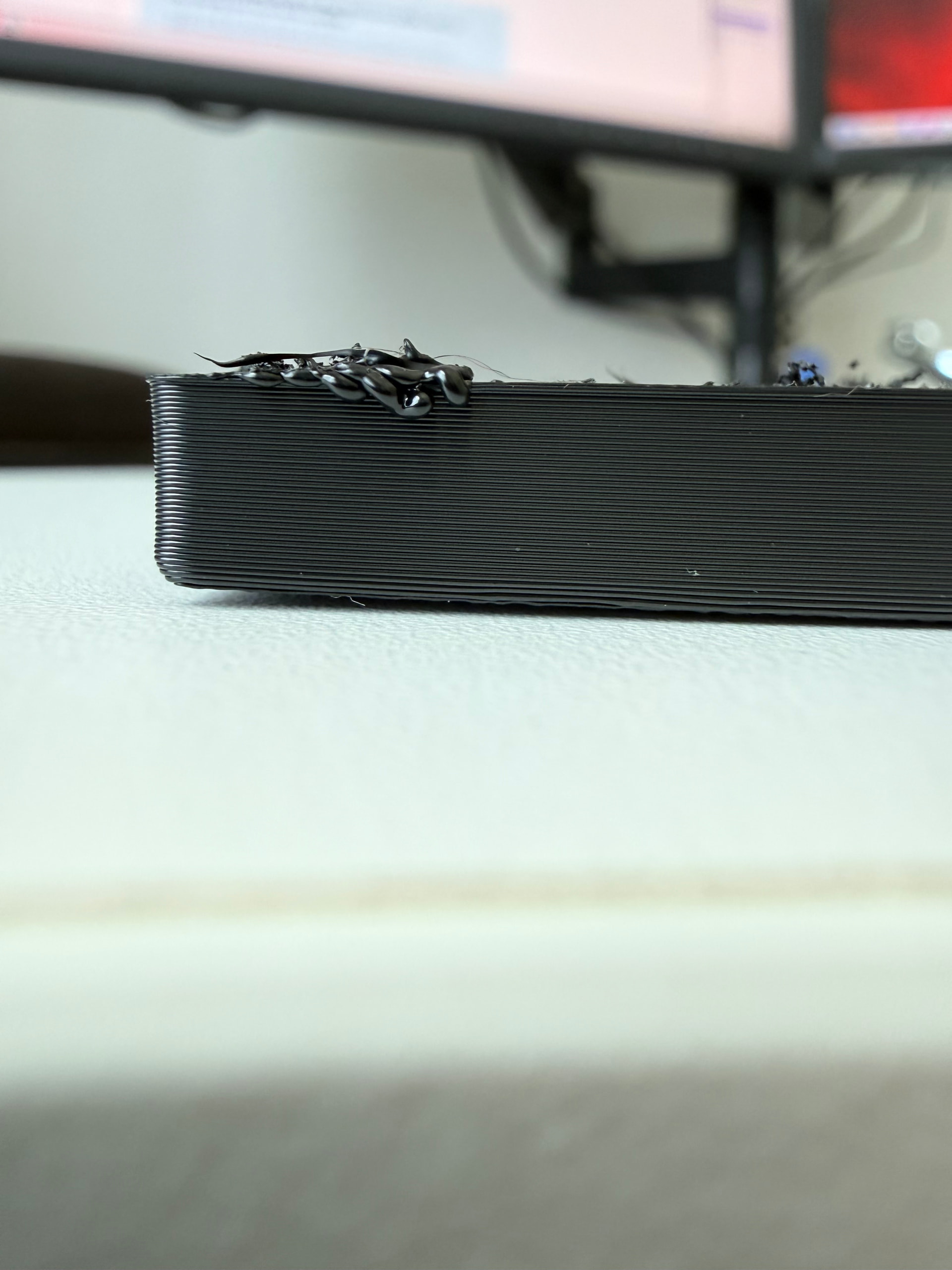

The print runs fine at the beginning. Bottom layers and infill of the frame look consistent at all directions up to the point where the top layers of the frame begin and the infill continues for the hooks. On the left counters (back and front) of the part the printer begins to mess things up. I had 2 attempts and that issue seems reproducible as it happens only on the left side corners.
You can see how thick the lines of the infill get on the affected corners and how the printer smeared around the material on the surface. The right side of the model looks fine though. At both attempts the printer stopped at this stage with error code HMS_0700-2000-0002-0009 “Failed to extrude AMS A Slot 1 filament; the extruder may be clogged or the filament may be too thin, causing the extruder to slip.”

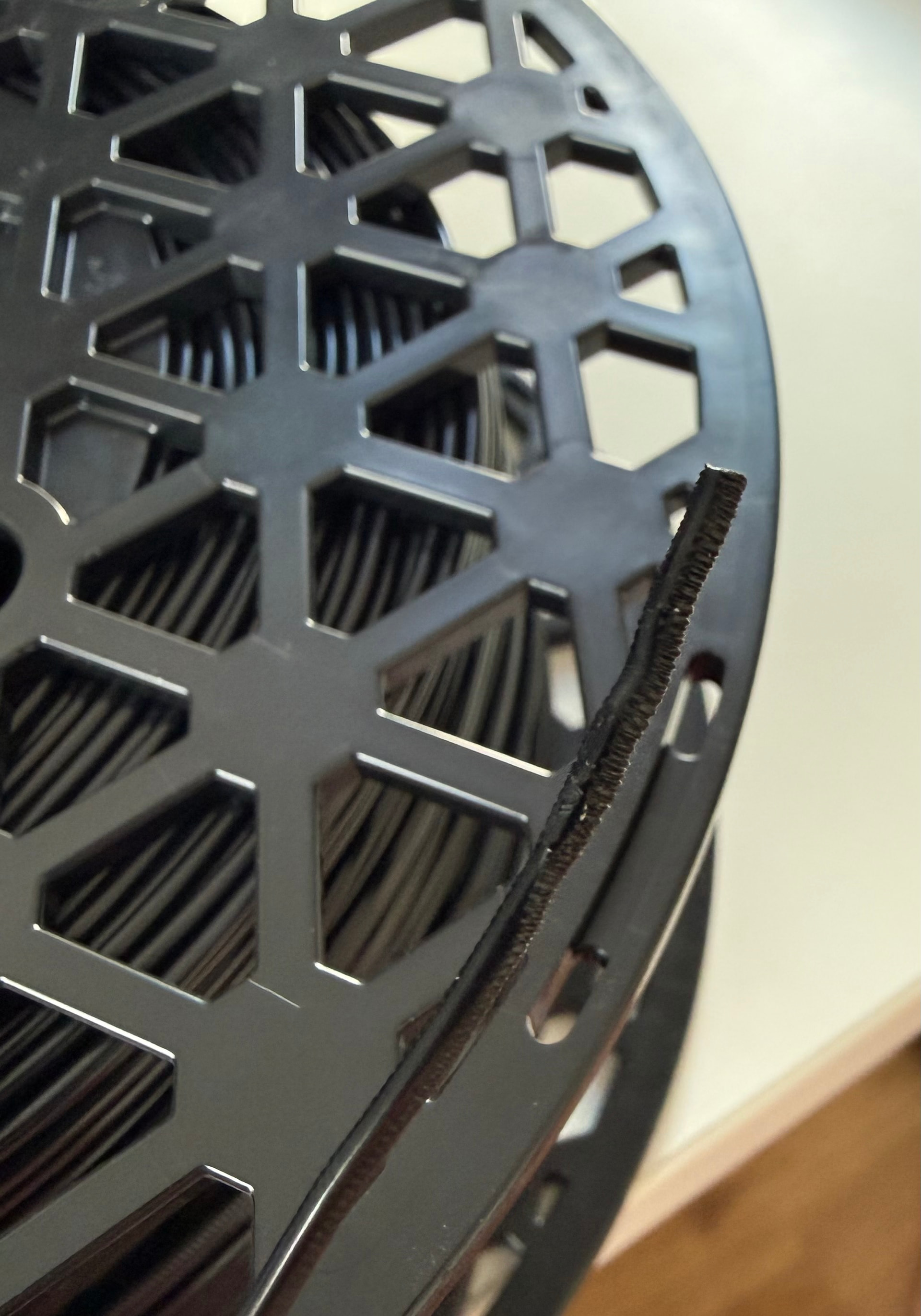

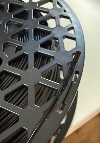

The AMS pulled back the filament and I checked the ending. It looked deformed:

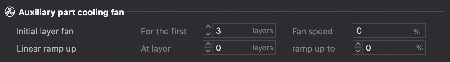

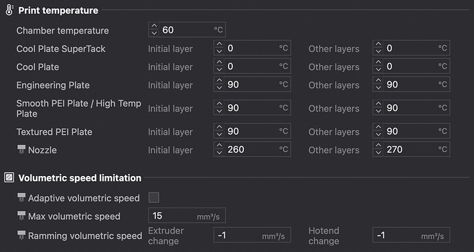

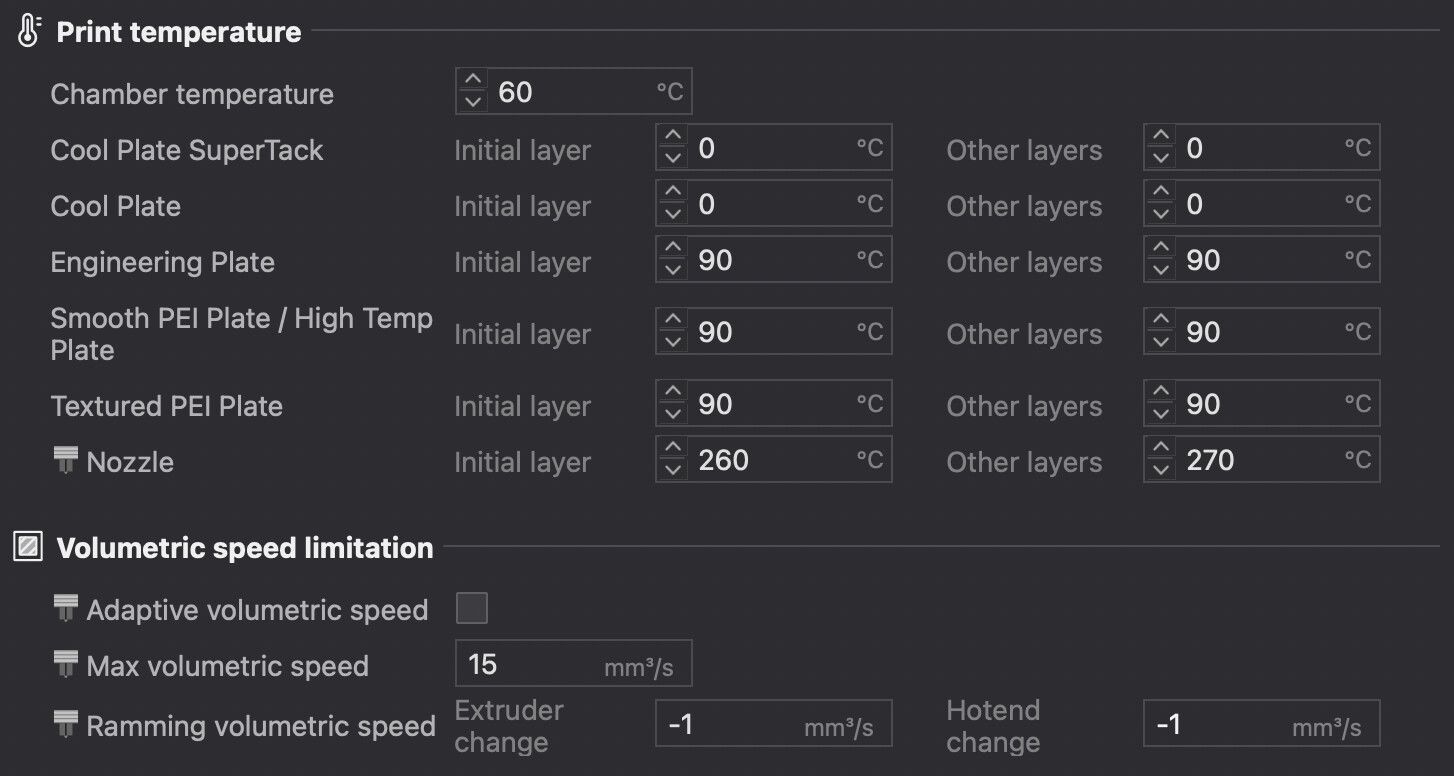

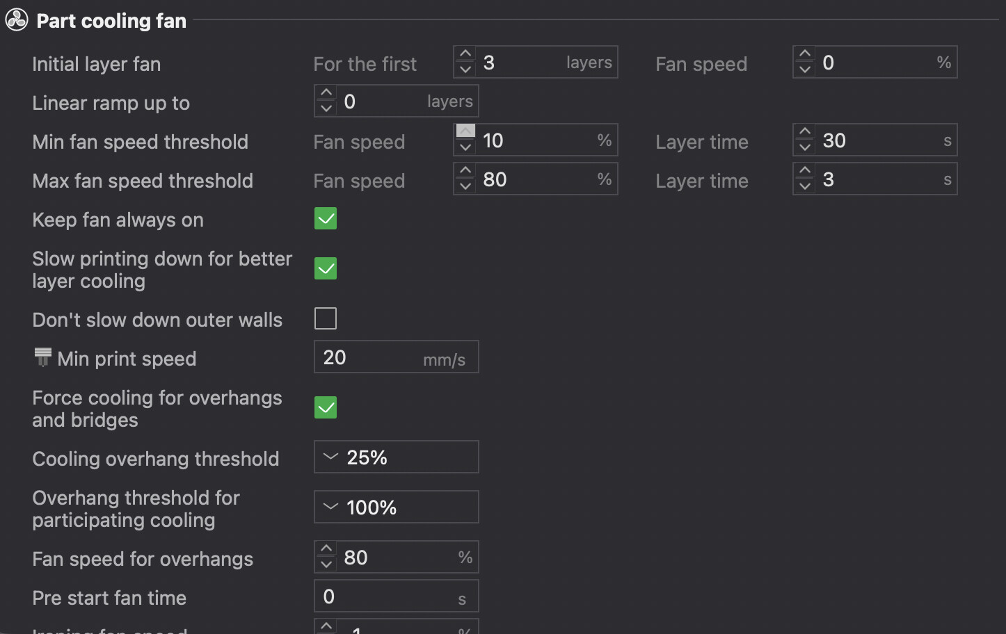

On my first attempt I printed the model with 5 walls and 30% tri-hexagon infill. Support interface layers on the Aux nozzle with support for ABS. Profile settings for the first attempt were (except bed temperature which was 100°C):
For my second attempt I cut the deformed ending of the spool, dried the filament for 12h at 65°C (went down form 28% to 8% humidity), reduced noozle temperature to 255°C after the first layer, chamber temperature down to 50°C and minimum print speed 30 mm/s after consulting my little friend Claude. The result however looked exactly the same. The print starts great without issues but ends with the same problem with again the extrusion error.

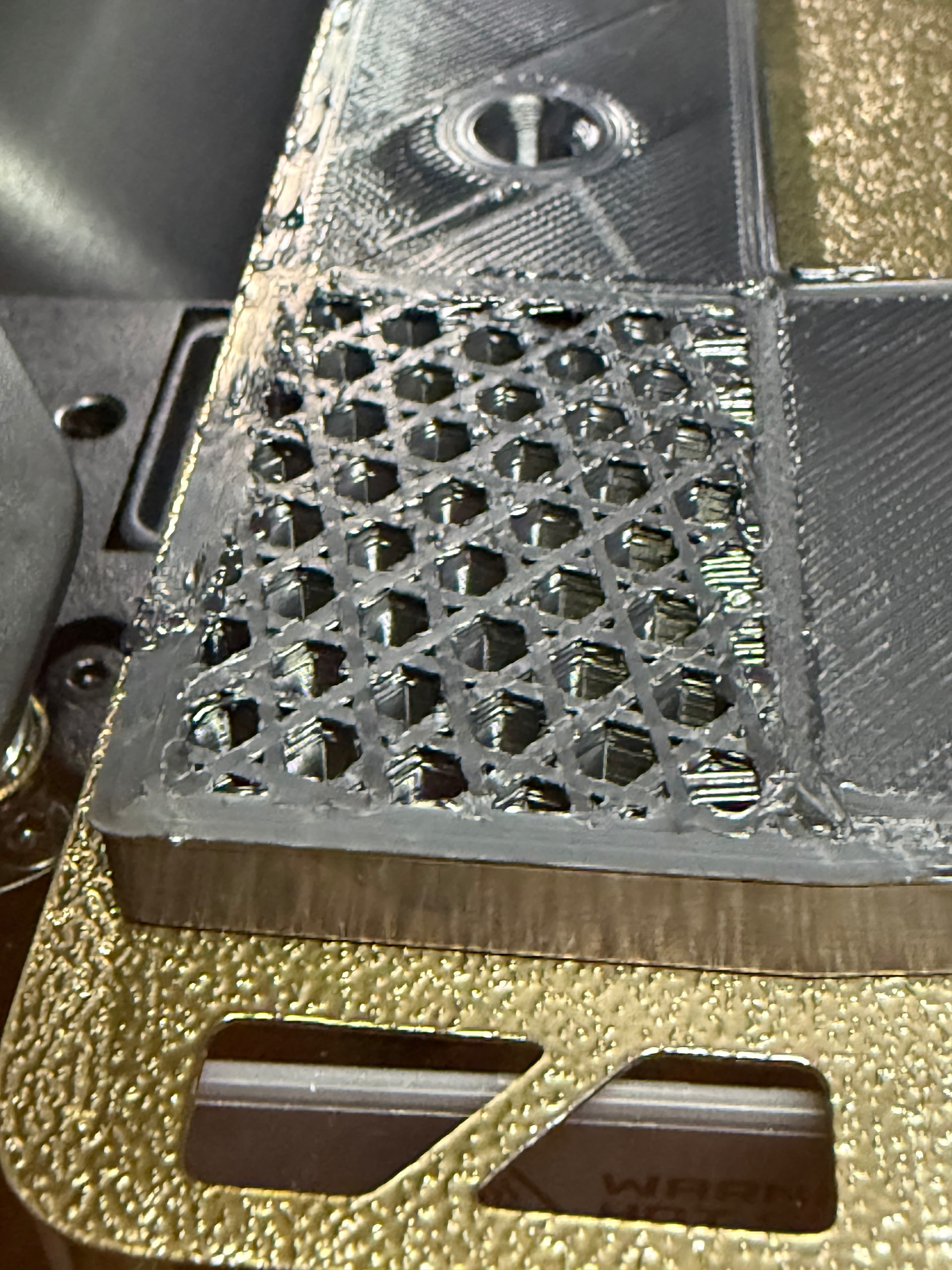

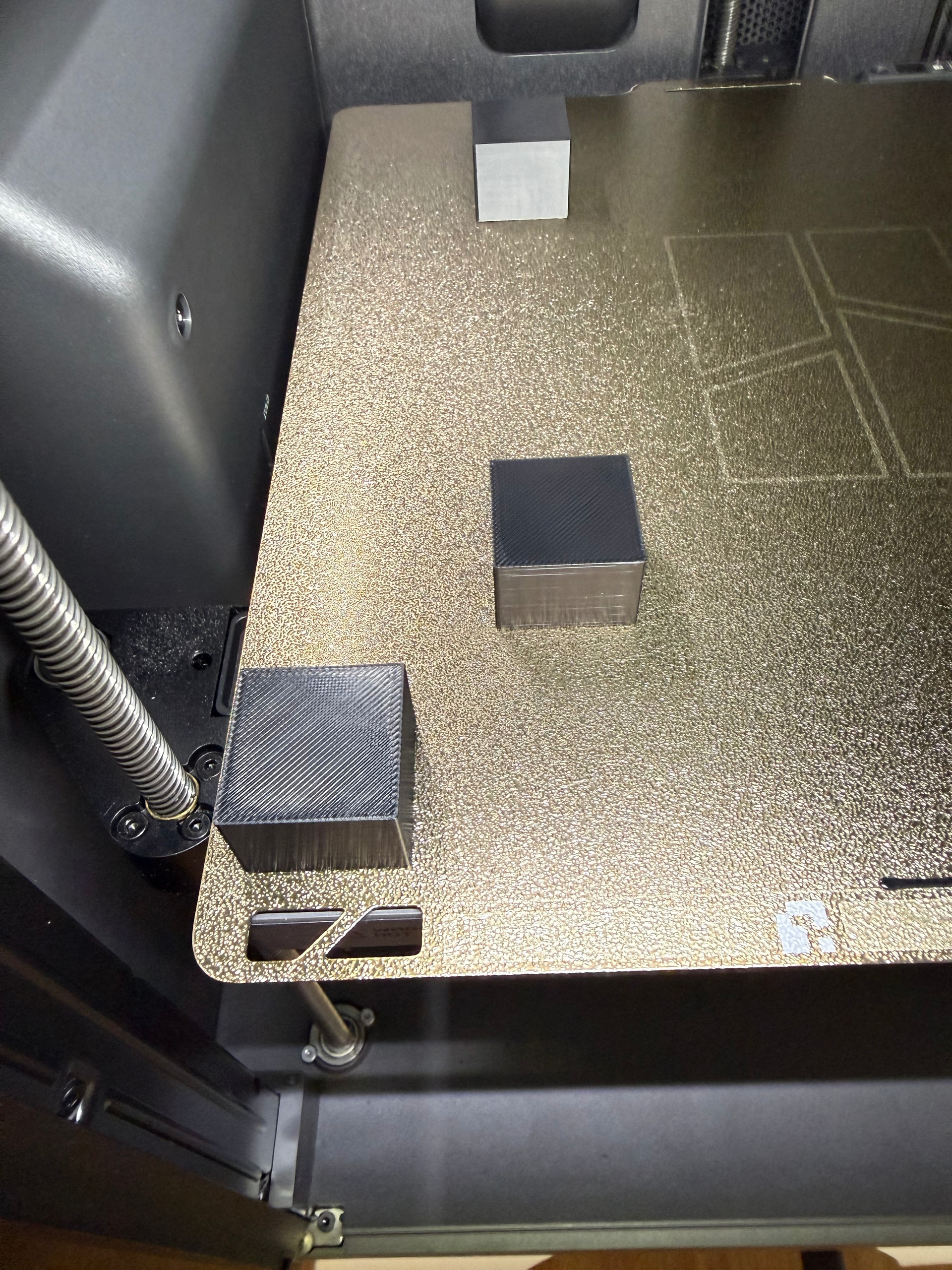

Thanks for your thoughts! I actually think you’re on the right track with your assumption. I had a closer look at the pictures I took during the print and that seems to confirm your theory about warping.
You can see that the model pretty much sticks to the plate. The thin shadow below the edge comes from a 1mm radius rounding so that’s ok. But look at the uneven gap between the plate cutout and the heat bed. Looks like it lifts the plate from the bed. :face_with_peeking_eye:
Looking at the part on a flat surface it doesn’t look like much but it seems to be enough to cause this mess and the clogging of the hotend.
Any tips how I could prevent it or should I switch to a different material with similar strength that is not as likely to warp? I unfortunately don’t have any experience besides the three materials I described earlier yet.
Confirming the conclusion I just printed small cubes to remove leftover brims from the plate. One very close to the front left corner and they expectedly turned out all well.

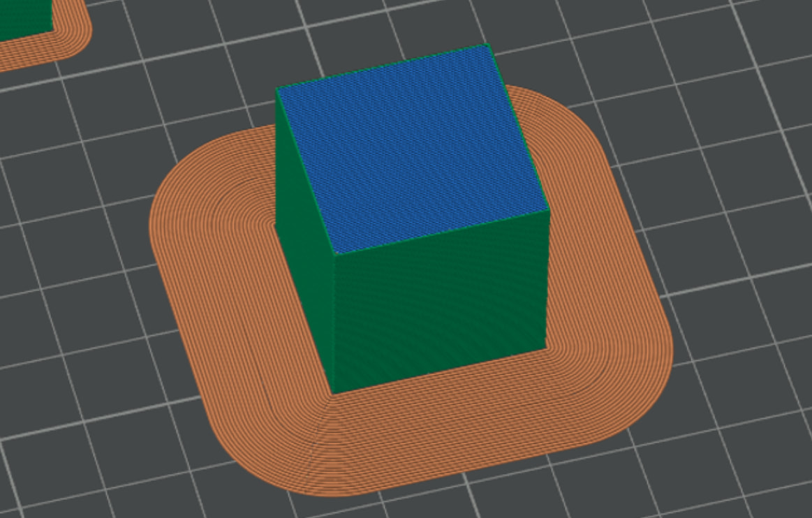

You could add brims - a sort of outline - but the downside is that you’ll probably have to cut them off after printing. In your case, inward - since there’s no room on the outside - won’t solve the problem, but it will maybe reduce it - in your case, that probably won’t help much.

I’m now considering moving the screw holes of that model. They are the primary reason I made the frame this strong since I didn’t expect ABS to be this flexible in first place. Since the topcase has quite a strong lever when attached to this wallmount I assumed it would bend the frame between the hooks and the screw holes. Hence I thickened the frame and increased support. I might just run the screws through the hooks directly to catch the load at its origin. That should allow me to drastically reduce the material for the frame and hence the risk of warping.

I had another try with a much weaker frame and the screw hole running through the hooks. It still warped a little and lifted the plate but the print went through with acceptable quality still.
