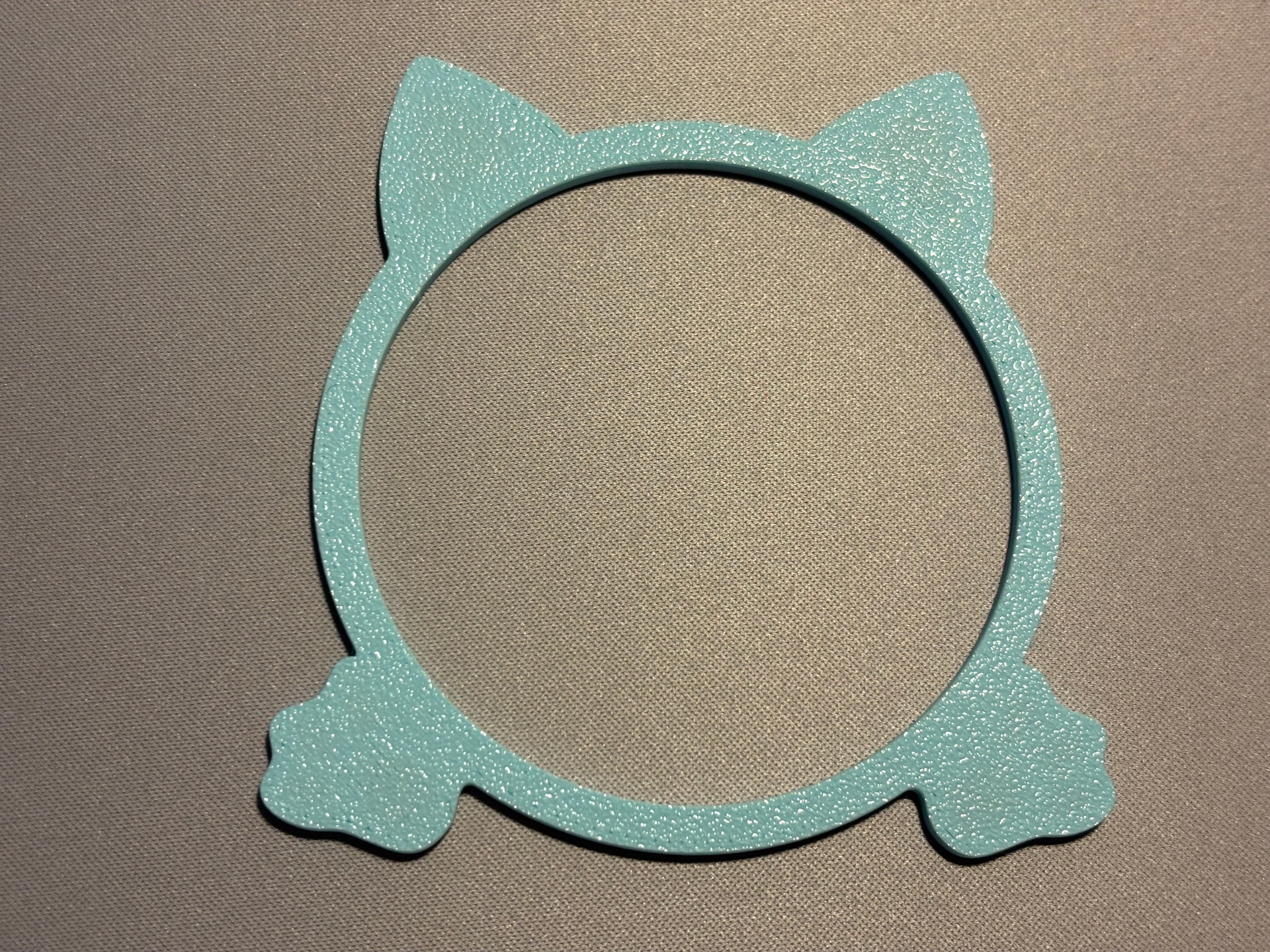

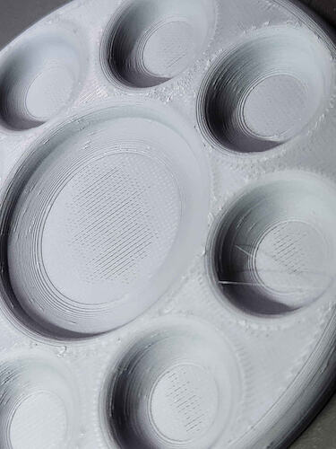

Dear Bambu Community.
I did all the calibration Bambu is offering. I dried the Filament (over 8 hours) . I have tried to print several pieces and still I am struggling with the top and bottom surface. Since I see there holes which should not be there. holes between the lines and also small dots.
I had A1 mini before so I know it can be completely without these signs.
Printer firmware is updated and printer is standing on the floor so no vibrations.
Any advices what I can do ?

I recommend using Develop mode and the top-line manual calibrations menu. (Not the Calibration tab next to Project.) The calibrations menu has a link to the Wiki tutorials for these tests.

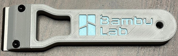

In the first picture, the holes on the bottom surface occur where the nozzle changes direction; that’s a sign of incorrect pressure advance (aka flow dynamics). They are very small, so PA is very close, but not perfect. You don’t see individual filament lines, partly because of the texture, but mostly because the flow rate is good.
The top surface of the scraper shows underextrusion gaps between the filament lines, so the flow rate for that filament needs to be calibrated.

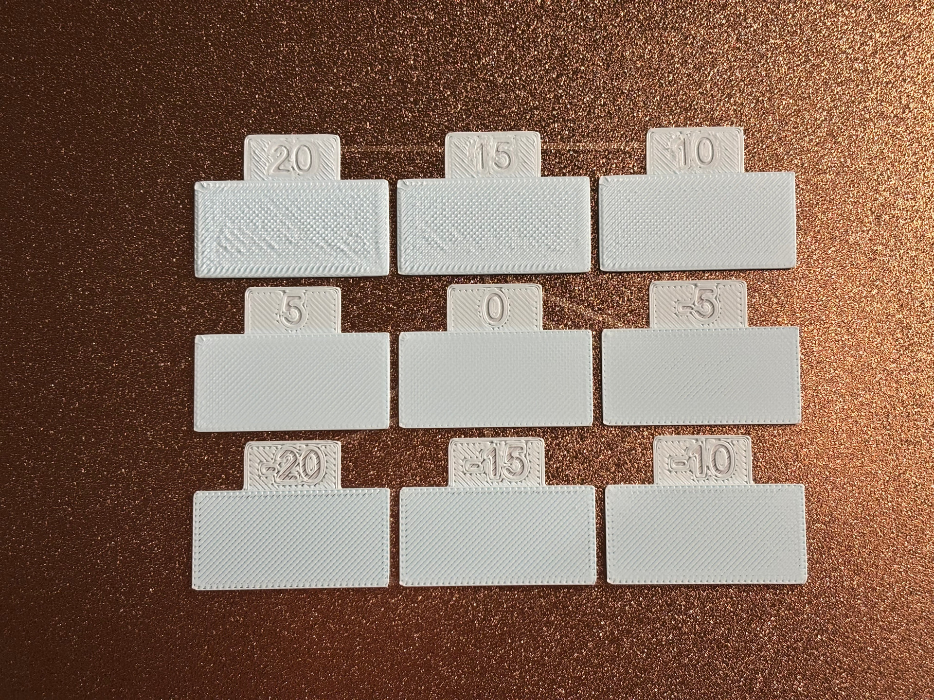

The flow rate samples can be difficult to judge in person and even more difficult to evaluate from a picture. Ignore the edges, look for the smoothest center. In the middle picture, these first-pass top and bottom rows are clearly bad; +5 is slightly overextruded, 0 appears to be the smoothest, and -5 is underextruded. Use the next value higher than the smoothest sample for the second-pass flow rate calculation. In this case, using +5 will create 10 second-pass samples between +5 and -5 to fine-tune the flow rate.

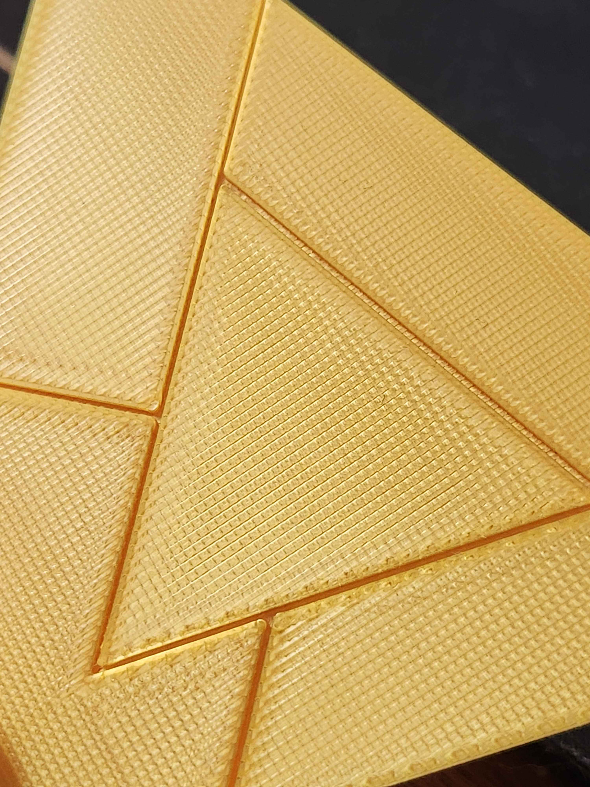

OK so I did additional tests and it seems Z axis is to high, I lower it by 0,014 and first print is fine

Just setup my new X2D and resliced a part I print all the time on my X1C. The ironing quality is awful, it just leaves a crosshatch effect. On the X1C it was like glass.

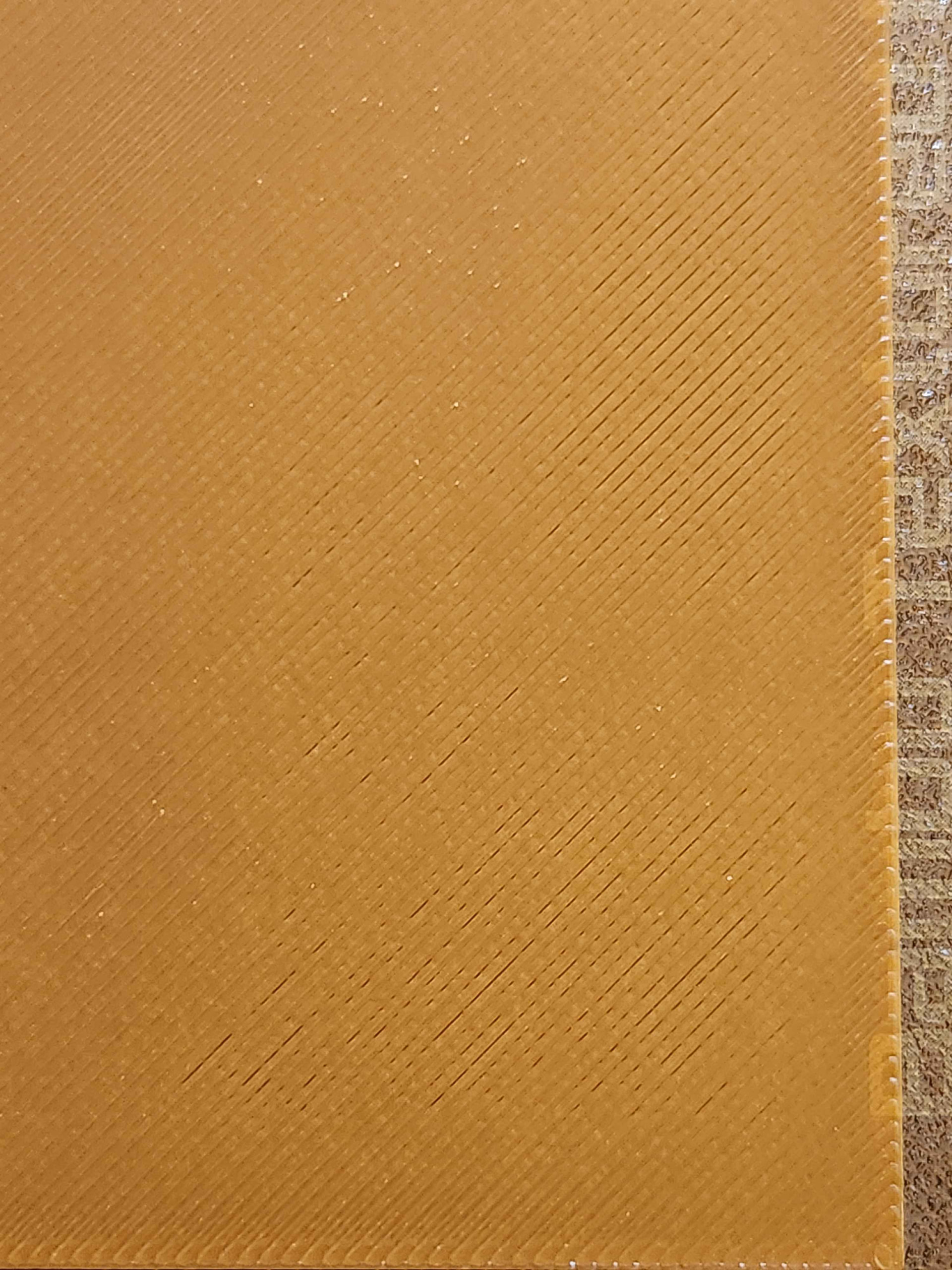

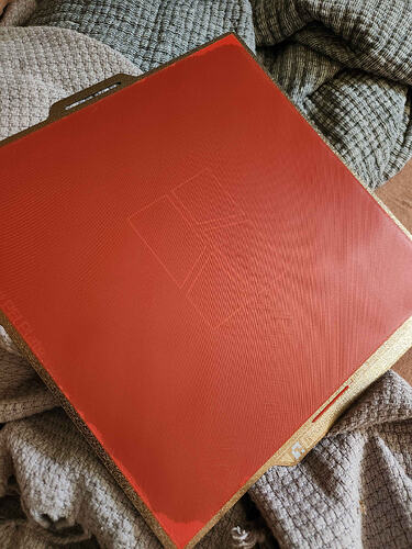

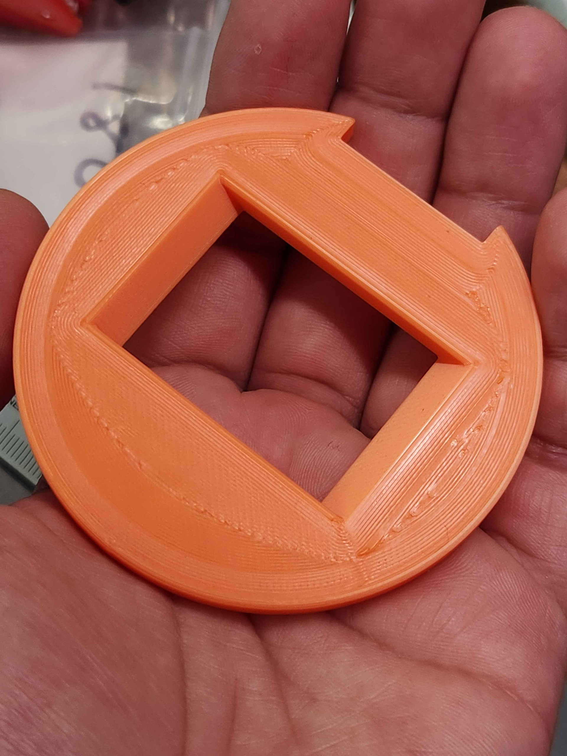

Still working through troubleshooting with support. Right now they are having me manually level the heat bed. Going to calibration and then manual first layer calibration, setting it to -.02 helped some.
Where can this be done?
Any before and after pics? My first layer smoothness is fine, at least smooth as my a1 mini for sure
On your x2d, from the touchscreen menu, tap the gear, then calibration, then look for first layer calibration under the manual calibration section.

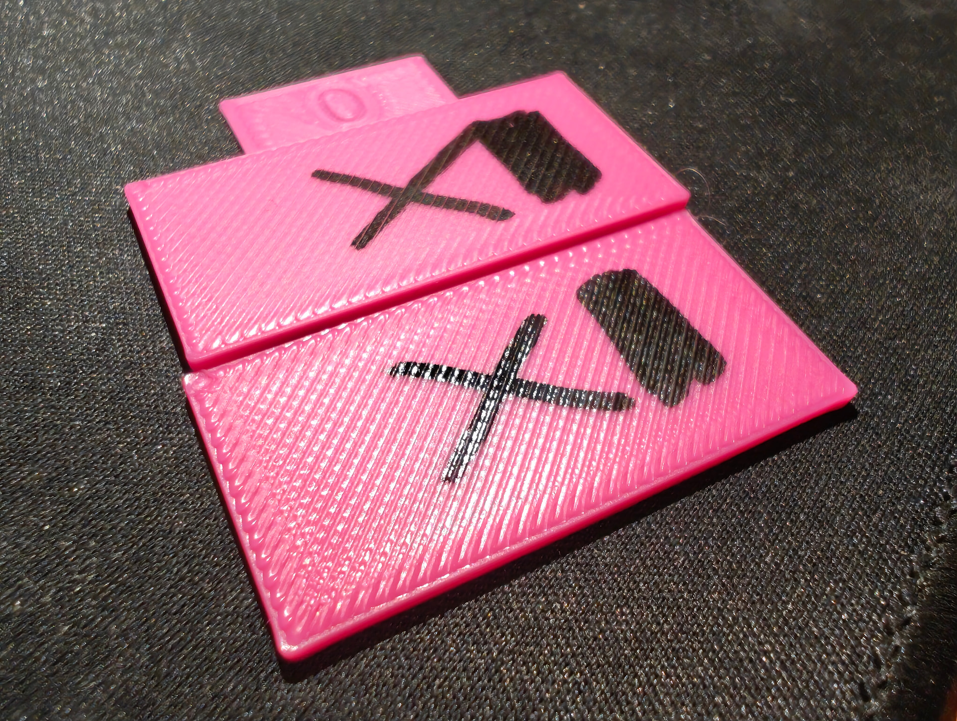

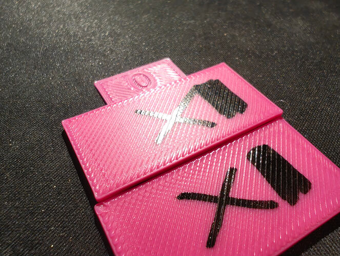

Matte Grey before
orange after changing the first layer calibration to -.02
first layer orange before
red first layer after

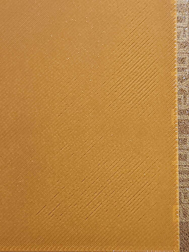

Example of the cross hatched texture printed before troubleshooting in silk+ gold
