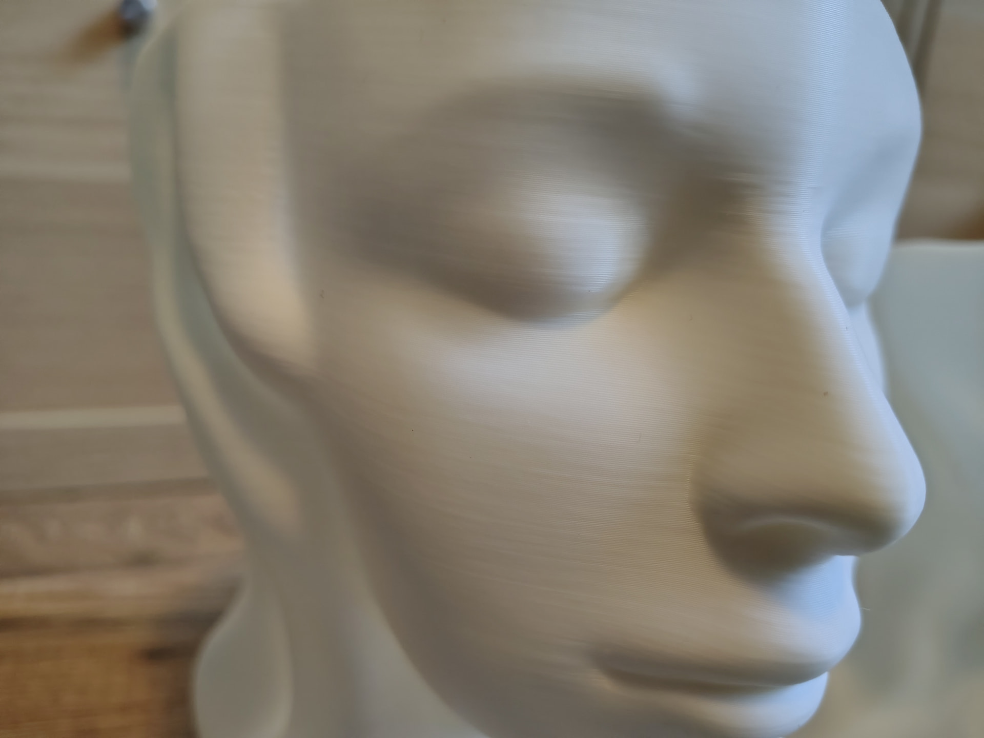

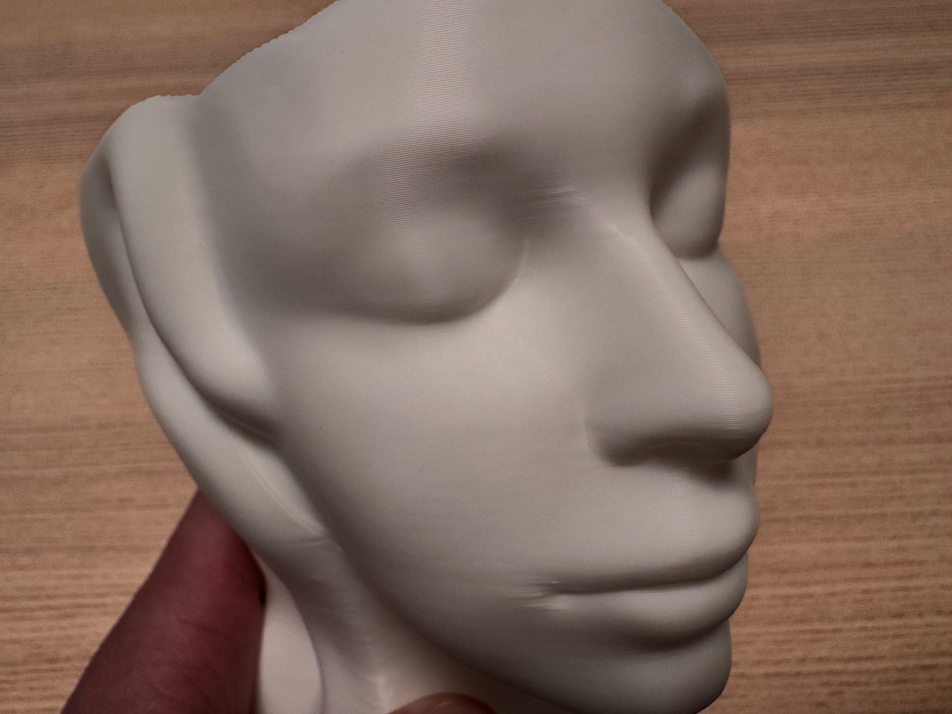

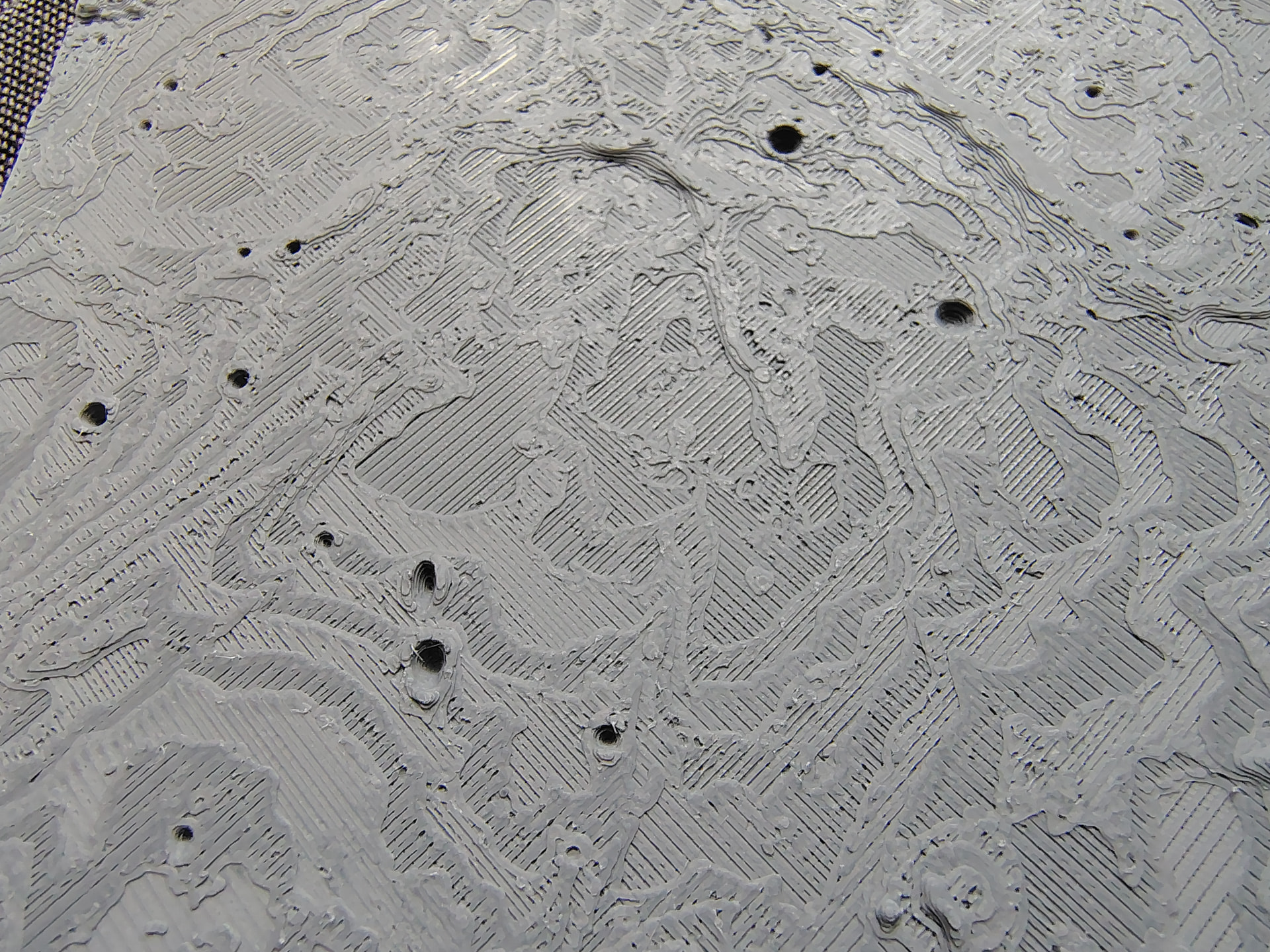

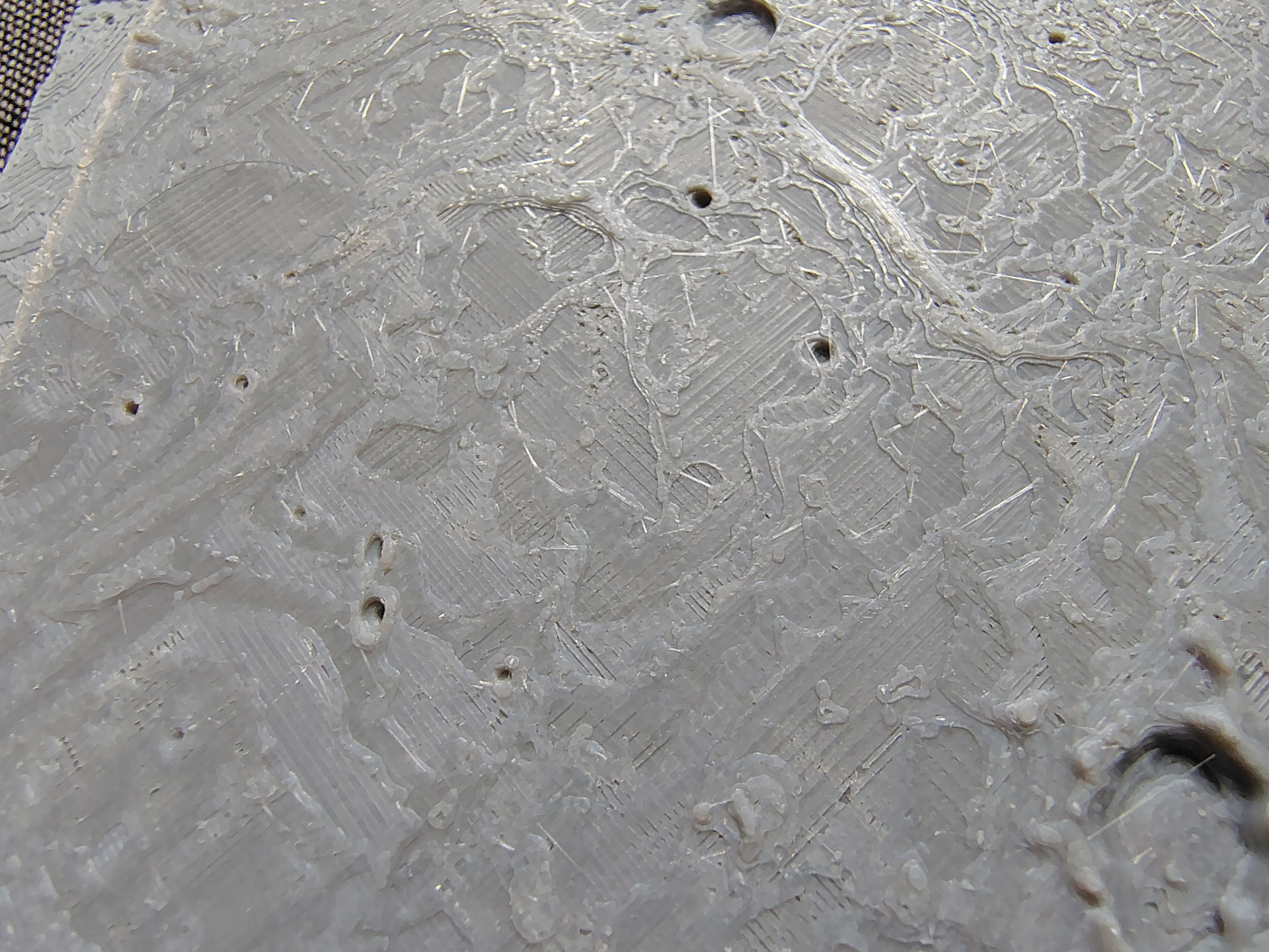

Two weeks ago i’ve bought X2D to replace P2S, as many of us did. Out of the box, printer seems to be working fine but print quality… Well, it’s medicore at best in my case, regarding top layer and outer walls layer lines. To ensure it’s not filament issue, i’ve been usign only Bambu filament. Dried for several hours even though it was new, just to be sure. For the same reasons i’ve done flow rate and flow dynamics calibrations for X2D, just after full printer calibration and of course cleaning build plate. I owe also an A1 Mini printer, so i did some tests to comare print quality. Bambu Lab PLA Matte Ash Gray on X2D for moon project, Kingroon Light Gray on A1 Mini. Bambu PLA Basic White on both printers for planter. Same settings on both machines (layer height, speed, infill type, etc.) to create comparable conditions. Here are results:
Moon surface, A1 Mini on top, X2D on the bottom. Incosistent extrusion, clearly visible layer lines on X2D.
Moon surface 2, A1 Mini on top, X2D on the bottom. Incosistent extrusion, clearly visible layer lines, same as above.
Women head planter, A1 Mini on top, X2D on the bottom. Uneven outer walls extrusion, inconsistent layer width on X2D.
I’ve spent almost full day, running different tests, with different settings and filaments. Results was always pretty much the same - X2D prints were good with simple models (straight walls), but if the model consisted several layers or rounded surfaces, the quality immediately dropped, in compare to A1 Mini.
To be clear, that’s my fifth Bambu printer (P1S-A1-P2S with added A1 Mini-X2D). I’m certainly no expert, but over the years I’ve gotten to know these printers pretty well, the common issues they had, and I’ve tried most of Bambu Studio’s print quality options. To name a few in above case - number of top shell layers, printing inner/outer, speed and acceleration for all moves, infill type and density, top surface layer width, only one wall on top surface option. I’ve printed couple aux fan diffusers to ensure that’s not cooling issue. Manual bed trim done. To be honest, i’m running out of ideas. Maybe it’s the new standard or i’m overreacting, but I simply expected the X series printer to offer at least the same print quality as the cheapest printer in the family.

My thoughts are I can’t really make a judgement because the two comparisons are at different angles, or different areas, and different lighting conditions.
Not saying what you are observing isn’t true. It’s just hard to compare in this way.
The light is the same, areas are pretty much the same. There’s difference in filament on moon surface project but planter was made using same Bambu filament. But what matter most, i think it is quite easy to see the quality issues with X2D printed elements. Unconsistent layers are clearly visible, while in the case of the A1 Mini the end result is much better. Here’s another planter shoot, you can zoom in picture.
As i said earlier, I expected to get at least the same print quality as with its smaller brother. No more, no less.
