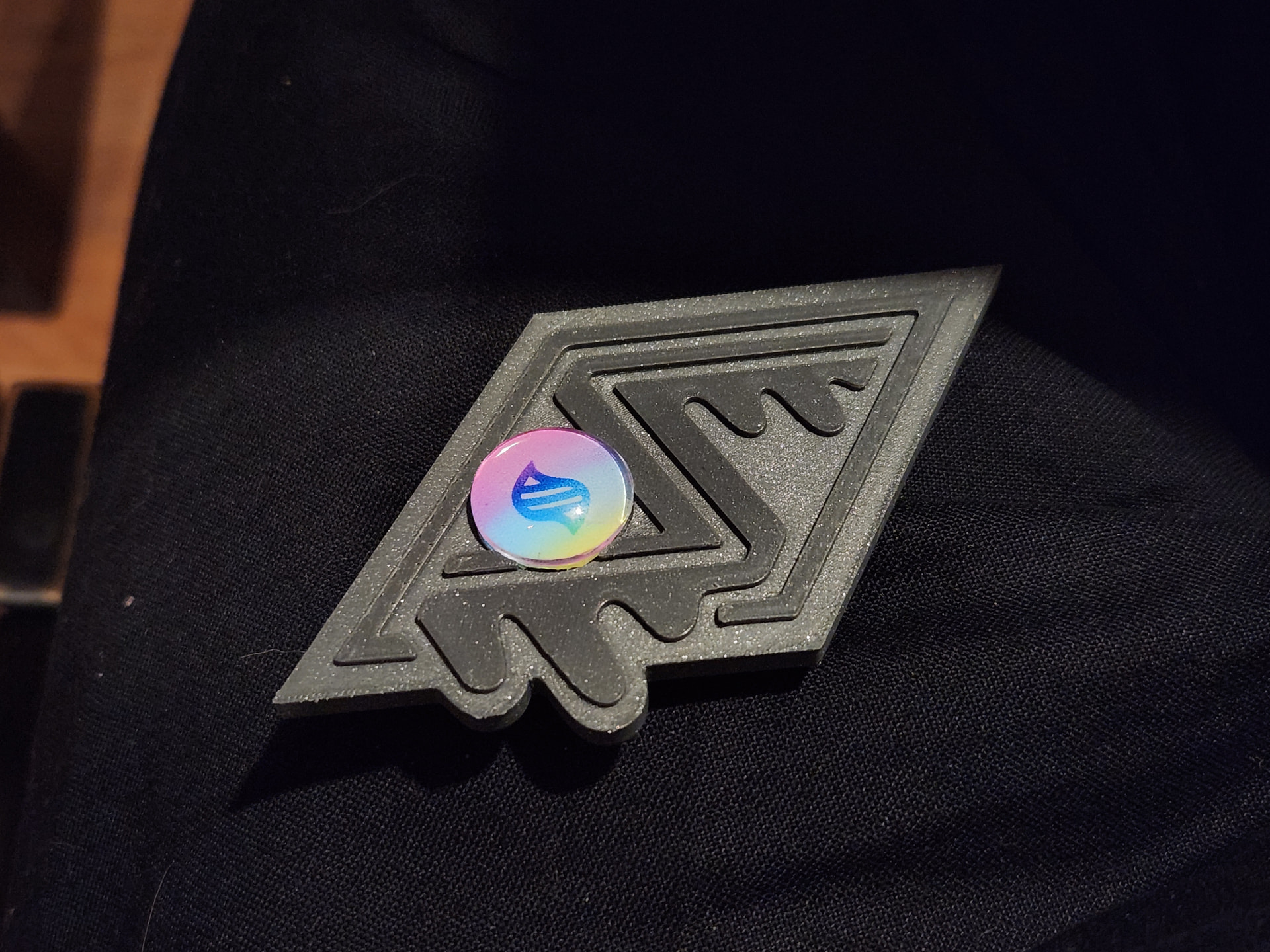

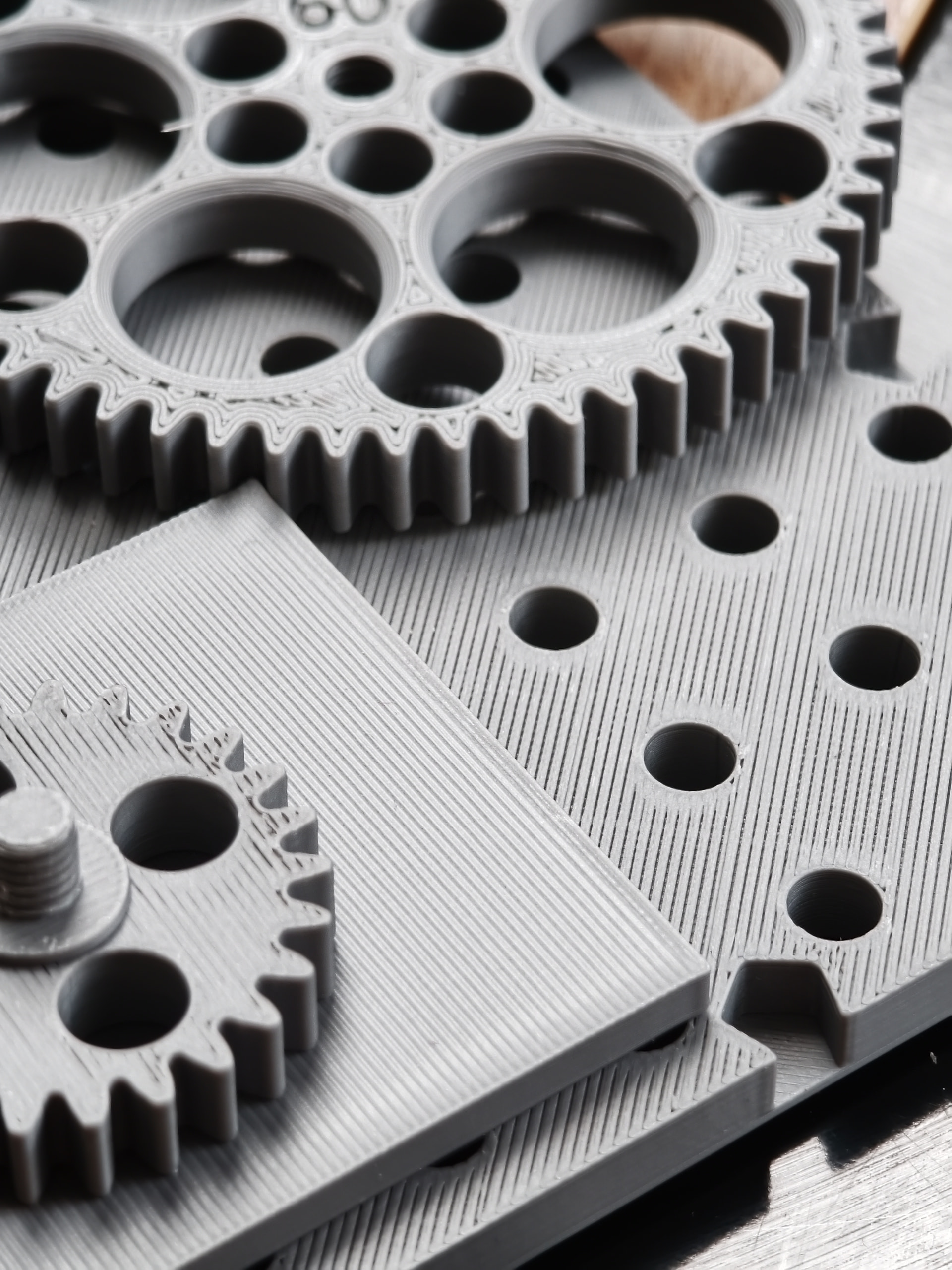

After some tweaking with settings and ironing, its coming out very clean on the new x2d. The old one could not match this. Maybe your machine is an earlier model like my old one.
Finally, after months of struggle, my prints with the X2D are starting to look as they should.
My ticket with Bambu support took quite a long time to resolve the issue with under and overextrusion, and the solution to the problem was to replace my X2D with a completely new unit.

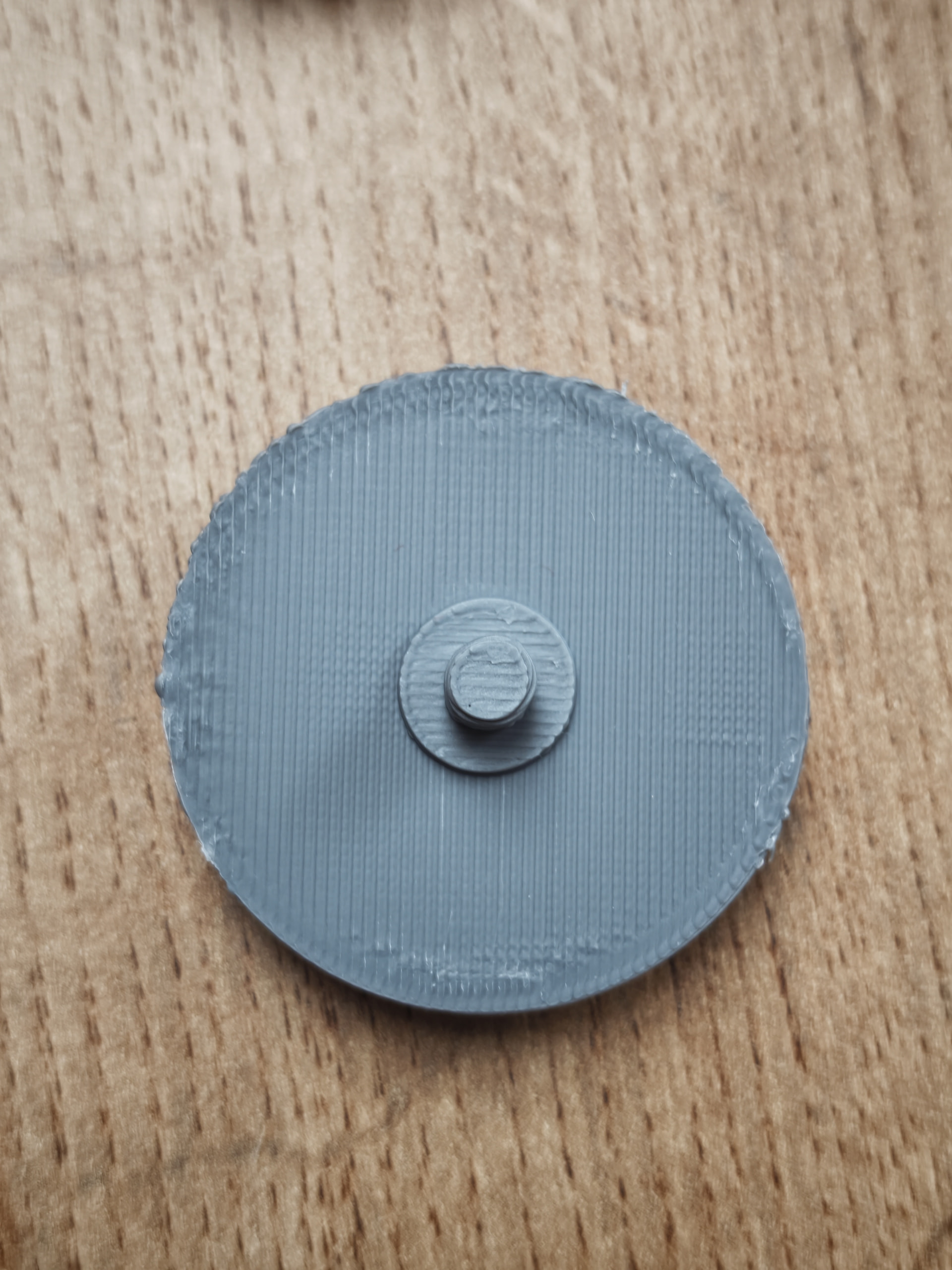

The new one, which arrived just yesterday, produces much better results straight away, and this is how the part I’ve been using for tests looks:
There is still some minor underextrusion in some areas of the print, but I’ll take it as it is. Earlier in this thread, I uploaded the same part printed on the X1C, which to me delivered a better result than this one.

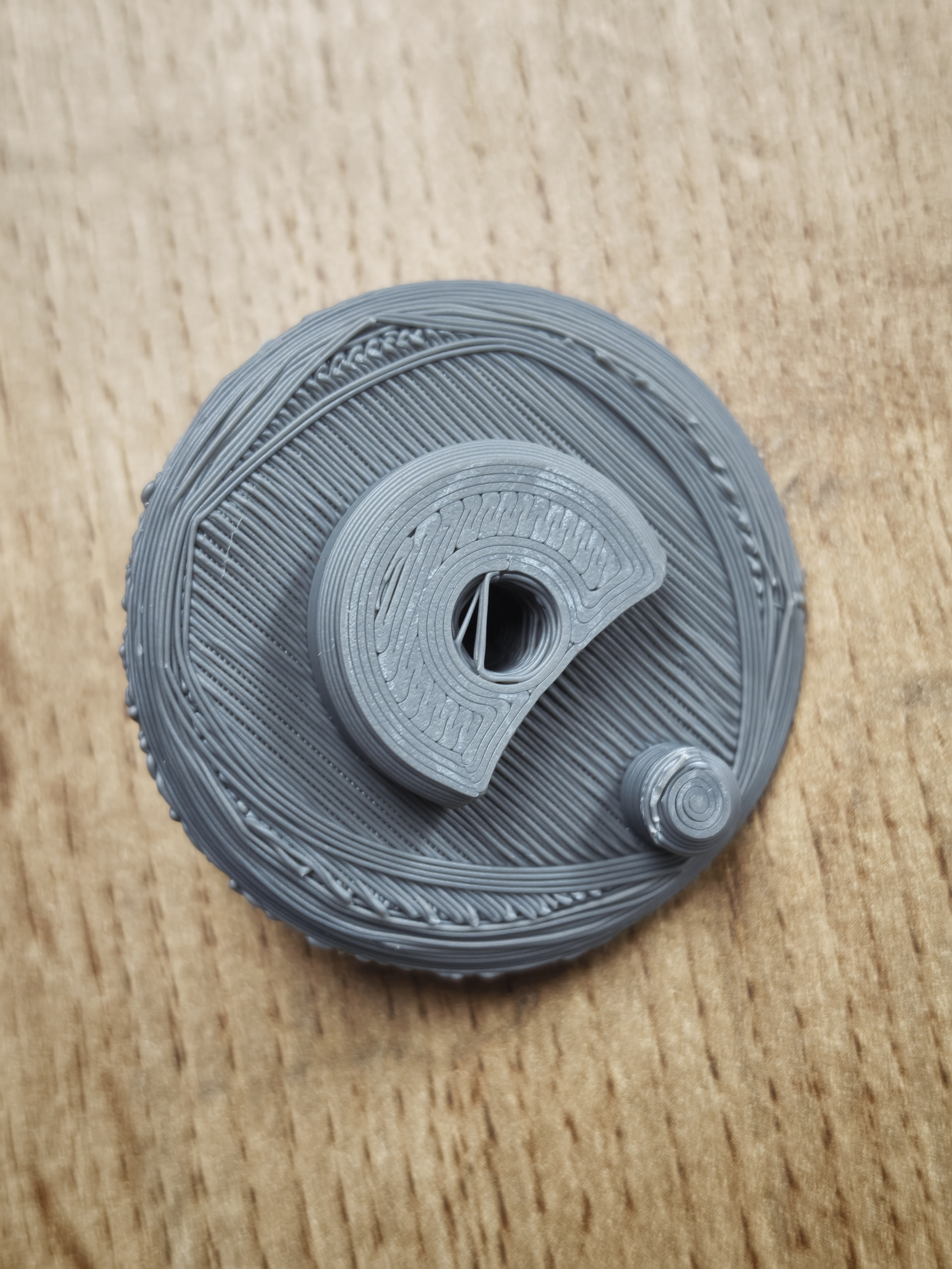

In the last days started to print actively and yesterday tried one prototype. It got horrible under extrusion in the first few layers. This is with brand new BL PLA Basic white, freshly calibrated both advance and rate! And of course this was playing on my nerves and I decided to try some stuff. Played around and reread some calibration and first layer fix topics. Looked in the menu and saw manual first layer calibration. Which give you the option to manually set the Z offset +/- 0.05. I have set it to -0.02 out of the blue and to give it a try. Then gave it a fresh low + high temp calibration, which seems to made a lot of calibrations like 2x times fast and 2x times slow with more precision. Then made a primitive cube 200x200x0.2 and started a print. It again did at least two bed calibrations, not sure why it did more then one, as I have just completed the calibration prior that. I have the auto bed calibration from the print menu at - ON. Then it printed absolutely perfect first layer, which has amazing adhesion between the layer lines, and to the plate! I am not sure if the -0.02 ( should be 10% from 0.2 layer) could make such a big difference, honestly I do not believe so. Or just because I have touched it, it did some internal reset/init, and this time it was able to calibrate properly?
I am try to figure out what was that?!?!?!?!
Currently reprinting the same prototype which had under extrusion on the first layers and it comes out great.
For the calibration for the flow rate I picked 0 patch, which is basically the default flow for PLA Basic - 0.98.
Lets see now how will be the top layer part. WOW

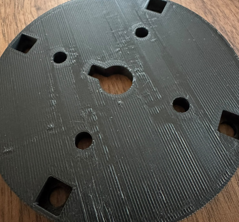

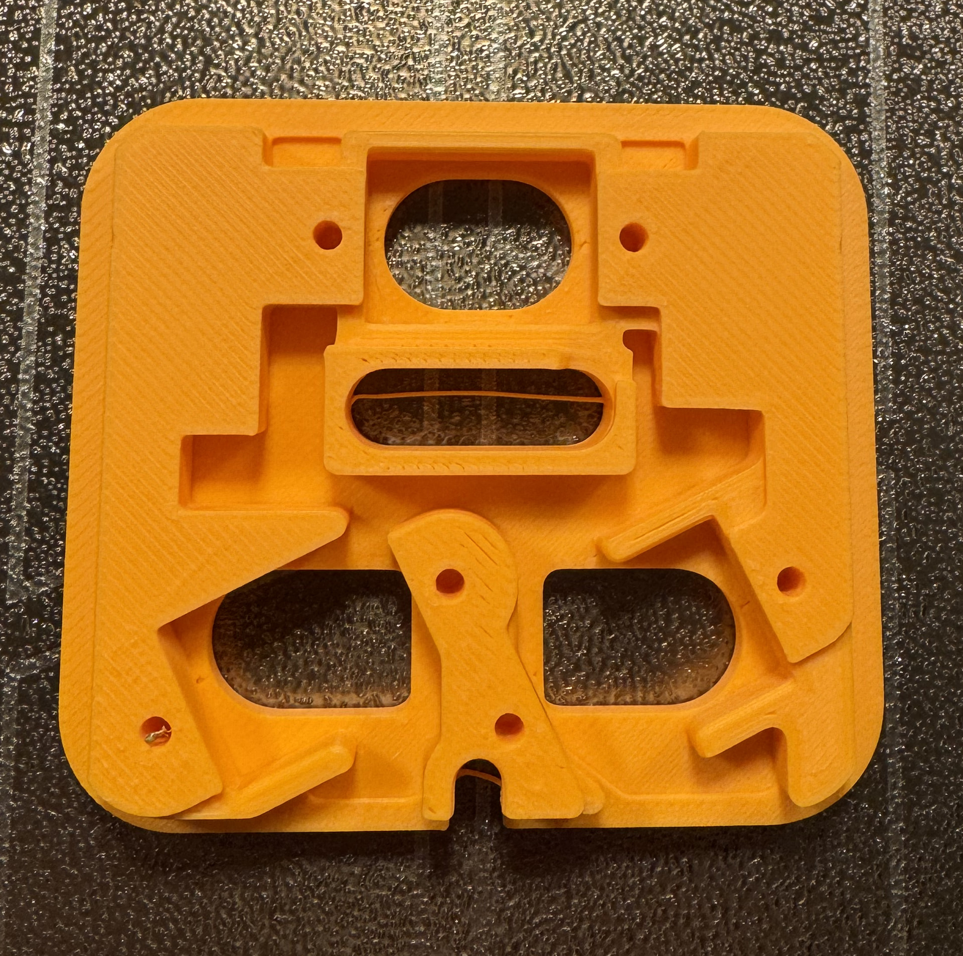

Brand new X2D printer, fully updated, fully calibrated - after a few days started printing horrible looking top layers. Using plain bambulab black PLA. Is there any consensus on how to resolve this? (cant upload images or links but hxxps://i.imgur.com/F4RVw2D.png is a sample)
I will attach it for you:
This looks similar to my issue with the bad setting for the bridges, which make roots like sticking up and break trough over the next layers, And/or make such little hills and peaks. This looks more like bad profile settings, which may be by default! As the X2D profiles are hit or miss.
Try some standard detail like cube or such and see if the issue persist. And you can watch for bridges over the infill if they start to fall down and stick up. There are bridge settings which seems to be messed.

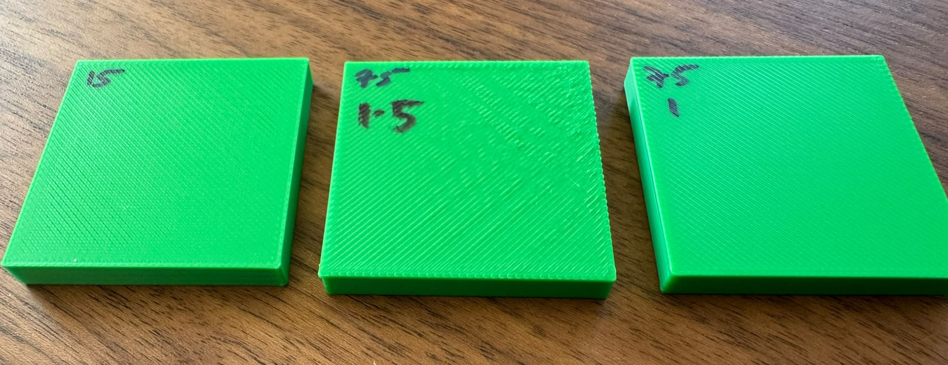

@JamboBambu thanks for the tips. I think I’ve found the problem and solution.
My issues started when using 0.16mm high quality and raising the infill. In these samples we have (left to right) 15% infill which looks good, 75% infill which looks bad with the default bridge flow 1.5, and 75% with bridge flow set to 1.0 which seems to fix the problem.
Great! I think in my case also brining back bridge flow from 1.5 to 1 make it better. But 1.5 was the default value form Bambu!
I can see also some under extrusion in the left most patch. Exactly as mine used to do.

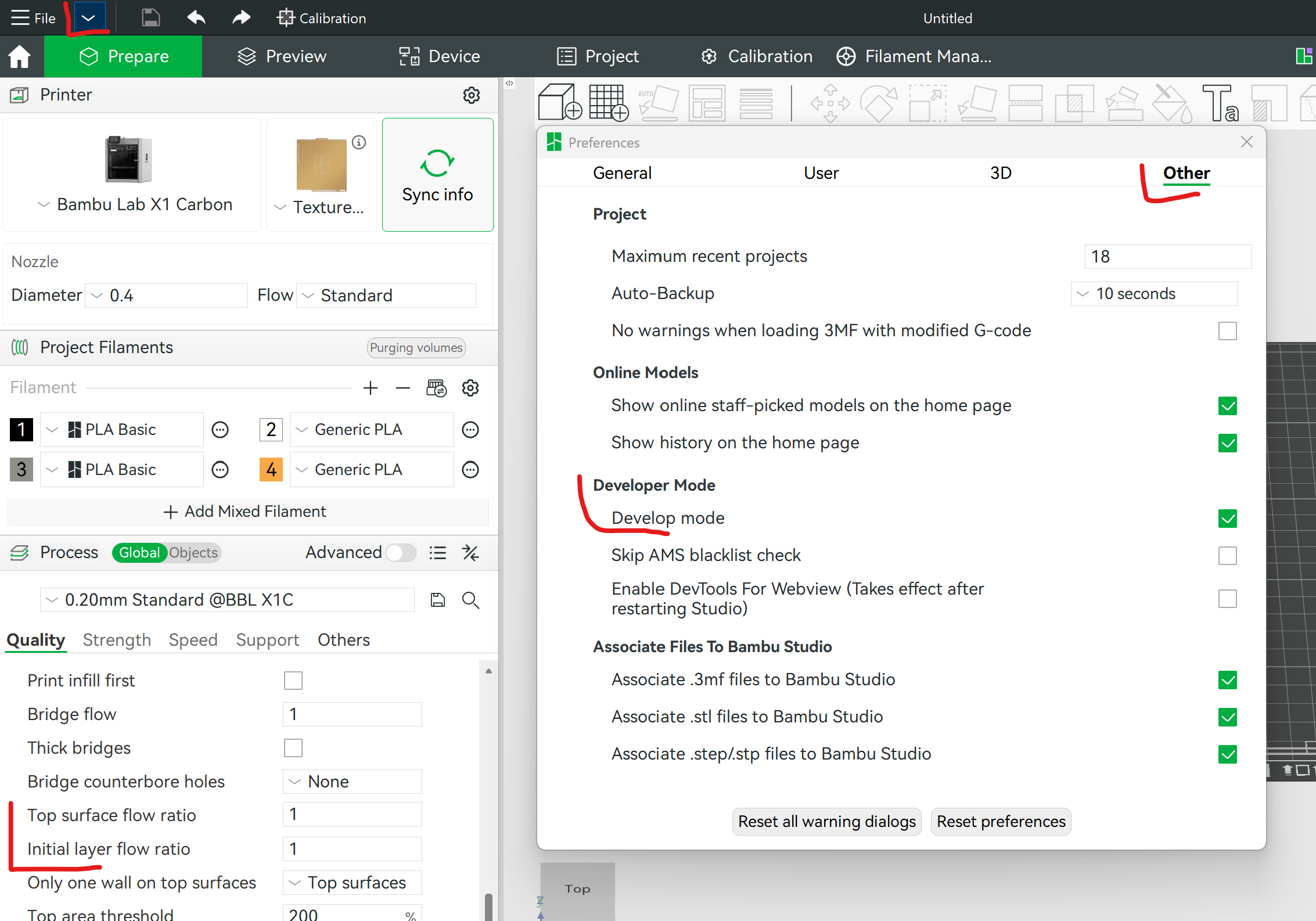

When you toggle advanced settings in bambu studio you will get option to tweak the top/bottom extrusion multiplier. Or maybe to get it there you will need to enable developer mode from the preferences. So you may try to give it a bit more to the top. as you have now the bottom fixed?
So you may try to gave it 1.05 or 1.1 to the top and print some test.
You can create small cube primitive for the test like several layers thick. Then correct or print it bigger for more testing.

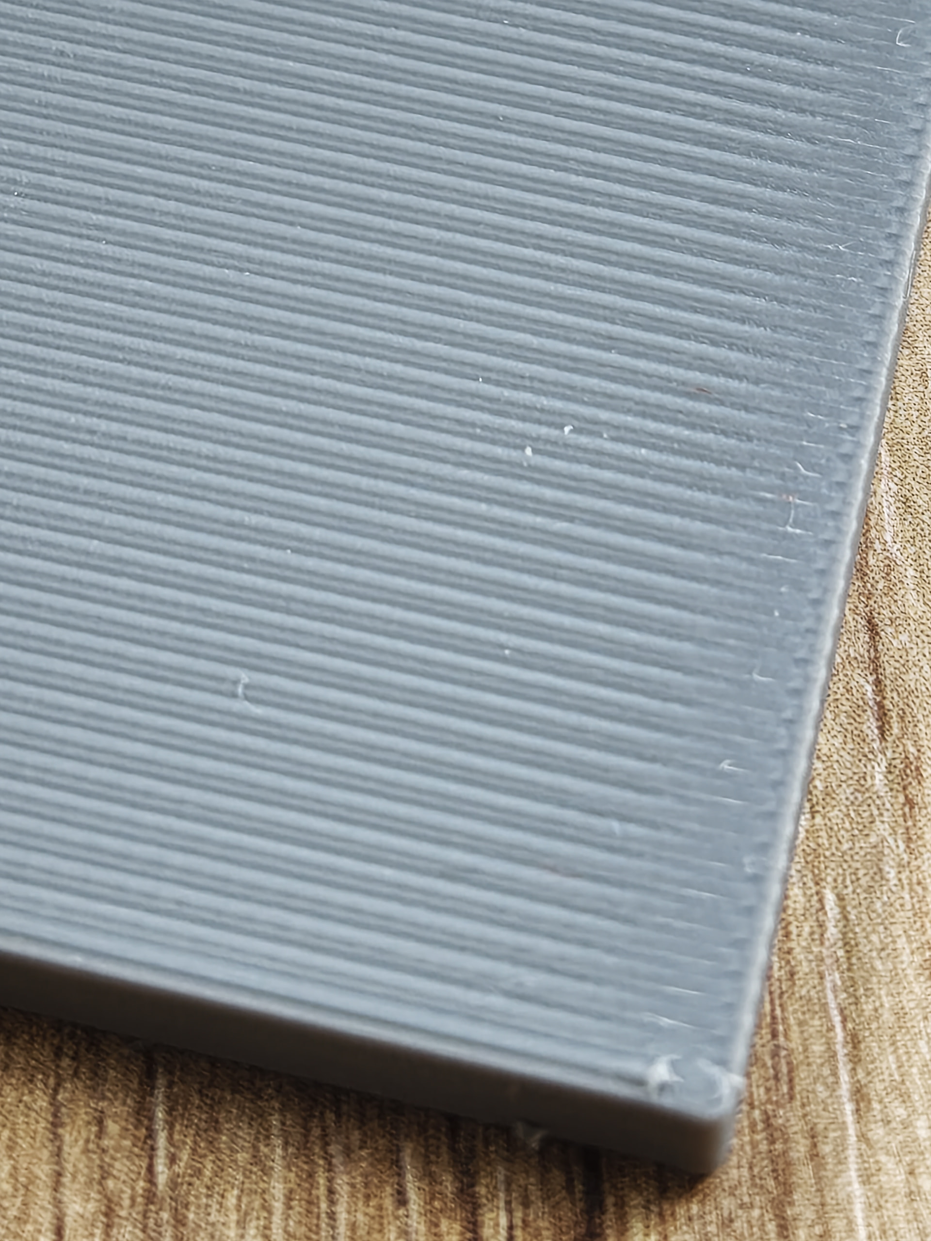

Some results from trials and experiments in the last days:
I think this patch below is the best I am able to get so far from Bambu Pla matte Nardo Gray.
