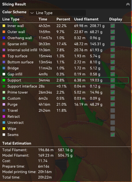

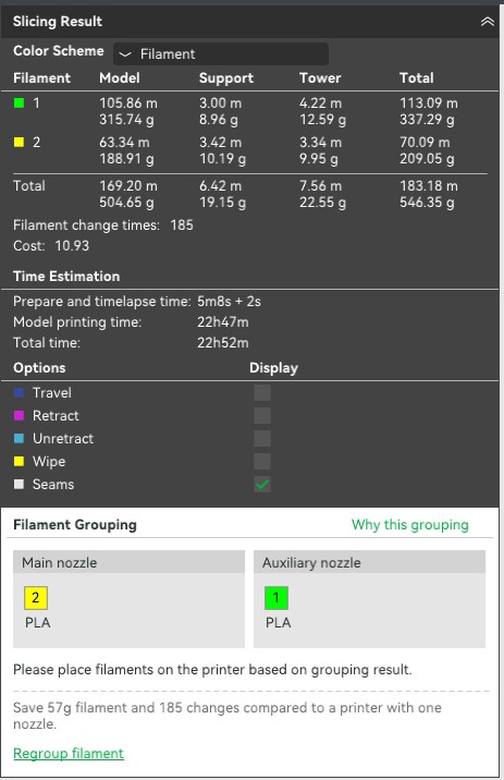

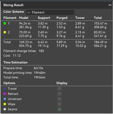

I have a simple 2 color model, which I’m printing 12 copies on a single plate.
pretty simple - I’m getting 556 grams of filament used, with 17 grams wasted on purge, 185 filament changes and ~20 hours total print time.
So I would expect printing with X2D to slightly reduce the filament (by 17 grams) but greatly reduce the print time, as with only 2 colors all the filament changes are near instantaneous… Right? Right? Right?
Apparently not…
In X2D I’m seeing 546 grams of filament used, so only 10 grams improvement (instead of 17). But what’s worse, the print time is now ~23 hours. So it actually takes 3 hours longer to print the models using 2 nozzles with almost immediate swaps, than with 1 nozzle using regular AMS swaps.

the x2d’s auxiliary nozzle prints about 20 to 40 percent slower than the main nozzle, due to it being a bowden extruder.
Are your flush volumes proper? I know sometimes studio likes to change them. It’ll be pretty obvious if they are because the little flush volume icon will be orange or red
You can save a couple hours if you do a custom regroup and put the green filament on the main nozzle.
Both version have the same purging volume coefficient.
Even after this, this is roughly the time of printing with a single nozzle, on a previous generation printer (P1).
I’m not seeing any improvement due to not needing to purge filament on every filament swap…

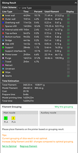

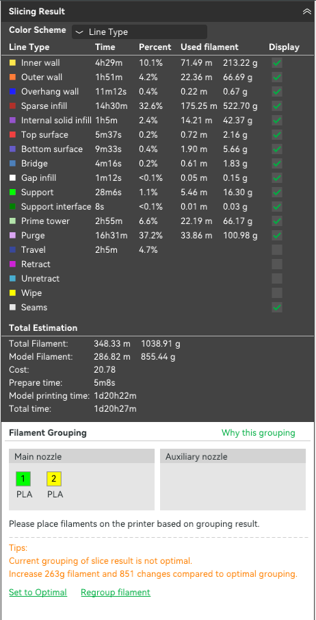

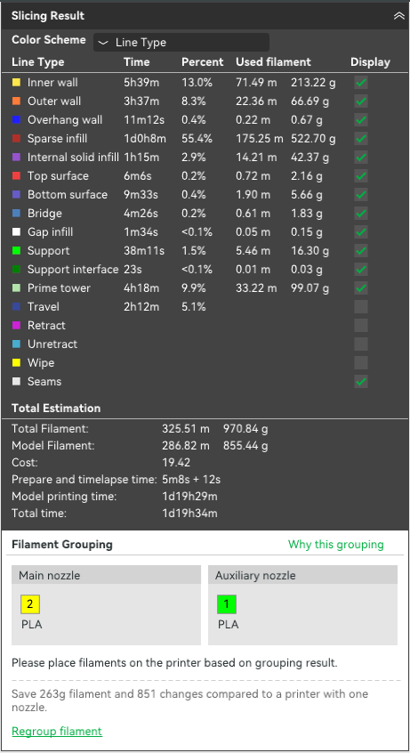

Looks like everything’s slower on X2D with the default profile and purging is not where you are spending the bulk of the time.
P1S first, X2D second.
Single color P1S vs X2D

2 color prints are going to take longer due to the slow speeds and accelerations of the aux side. Do a side by side of a single color print that uses a support interface material.

Seems like it really depends on the balace of how much you save by not purging vs how much slower aux walls and infill will be. For single model, it’s obv quite a bit faster since you are potentially saving hundreds of colors swaps.
It honestly surprised me. I expected the secondary nozzle to be slower & less accurate. But I have underestimated by how much.
The regular color swaps can take ~1 minute for each swap. So it’s potential hours of print time saved not needing to swap (in this print it’s 4 hours saved). I tested first with 8-color models, where the slicer divided the colors between 2 nozzles - there I saw an increase in print time. But that made sense, because both nozzles eventually need to do filament swaps, and the aux nozzle is much slower - so makes sense the time saved by having 2 nozzles, can be offset by the slower nozzle speed. But what surprised me was it’s true even in 2 color prints, with 0 filament changes.

Aux nozzle is much slower - cant do high acceleration because of extruder dynamics, youll note the default profile drops its accel to 1000. It’s gonna be slow on detailed models. Aux, not second

If it’s the same model you had before you still want the bulk of the color (green) on the main nozzle.
But what you discovered with a single big model makes sense. The aux nozzle is slower, so if you have enough walls, infill and top/bottom surfaces, that slowness will undo the benefits of not doing color purges.
