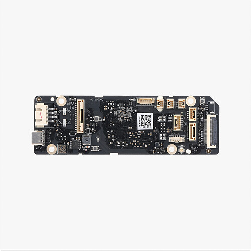

You should not be having general wifi issues with the X2D, unless something is either defective or not not fully plugged in. I would start a case with BL, as you may potentially need some parts under warranty. In the meantime, check the antenna connections:
I would inspect the cables/ribbons and their connections, any cuts or scrapes to these cables could potentially cause issues.
Edit: The AP board is $150 and then front cover is $10, I believe the front cover comes with the wifi antenna. Generally I suggest getting these under warranty and free of charge. For me, time is of the essence, I would probably order these two if I were having your issues, and sell the ones BL sends under warranty, or sell if not needed.
AP:
Front cover:
