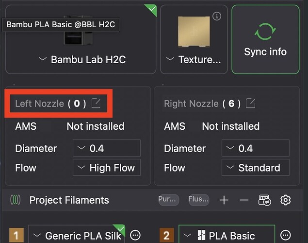

Yes, you can specify “0” for the number of nozzles, still have it installed there and print with one side only.
Ive done a few 0.2mm and 0.6mm nozzle prints while still having the 0.4mm installed on the left side.

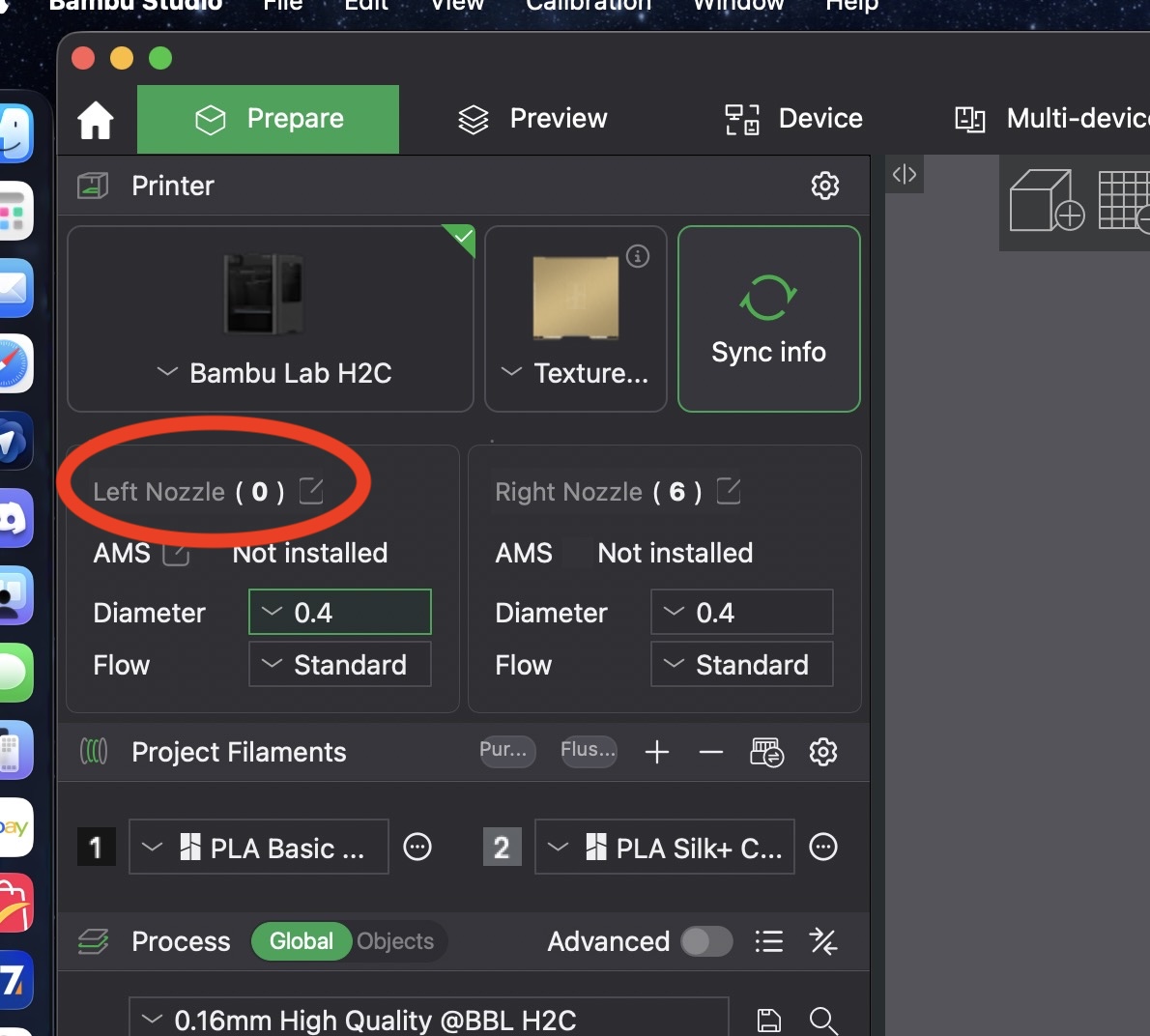

That could also be a reference having two nozzles of the same size installed at the same time. On H2C you can have two different nozzles installed, but set the left to “0”. But I do think that functionality of multi-nozzle size printing will come eventually.
