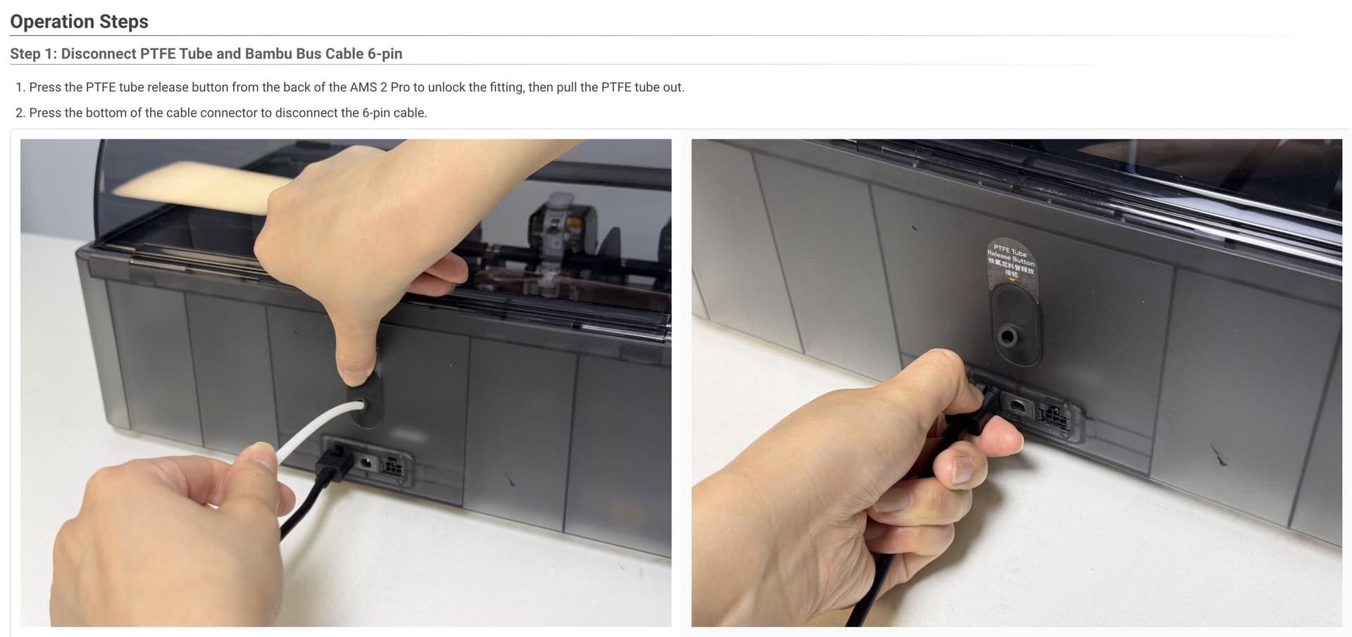

just because it comes already assembled it doesn’t mean it can’t be moved… PTFE tubes are actually consumables, and you might need to change them at some point
it might have been an error during preparation at the factory, i would try removing, inserting until fully seated before going into any further troubleshooting, as that is the most straigthforward step
Alright, learned something new there. It does pull out, but you have to press on the top part of the rubber boot. Done. Made no difference. I even trimmed off a little of the tube even though it didn’t look worn or deformed. Put it back, in as far as it would go, no change.
