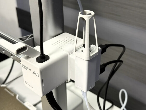

I have a brand new AMS Pro 2 connected to my A1. More than half the time the filament gets hung up in the hub/buffer on the printer. It seems like the filament coming up out of the hub is hitting the side of the PTFE tube going to the hot end. There is some play in the PTFE tube connector and I can wiggle it to get the tube to line up with the filament so the filament can pass into the tube. But left on it’s own more times than not the filament hits the side of the tube and is stopped. The AMS pulls the filament back and tries multiple times, the fails with an error.
I’ve trimmed the tube with a PTFE tube cutter that ensures a square cut. This is new PTFE tubing and when the filament does get into the tube, it moves smoothly without resistance. I’ve made sure the tube is firmly seated in the connector.
Anyone with the A1 Series hub, how much play is there on the connector on top of the hub?
I’m working with Bambu Lab support on this and I’m confident they will resolve it, but I’m looking for assistance from the community that might speed things up.

Thanks for the reply. I’ve only trimmed the least amount off the supplied tubing and I used a cutter designed for PTFE tubing to ensure a square cut. I disconnected the tubing at the AMS end and manually fed tubing through that tube into the buffer. The filament is definitely catching at the point where it leaves the hub and enters the tube going to the hot end. If I disconnect the tube going to the hot end, the filament passes through the buffer perfectly. It’s only when the tube to the hot end is connected that the filament gets caught, If the filament makes it into the tube to the hot end, it moves through that tube just fine and into the extruder, so I’m sure that it is passing through the buffer on top of the hot end. I noticed that the connector on the top of the buffer is not square and it does wiggle. Wiggling can make solve the issue, but even if you get it working by wiggling, the next time you print, it’s likely to get stuck. Attached is a picture showing the top of the buffer.
I’m having the same exact issue. My AMS 2 Pro and AMS hub just came in today. The pic you posted is exactly what the top end of my hub looks like and I have to wiggle it to get the filament to feed. I disconnected the PTFE tube from the hub and the extruder, flipped it around and reseated both ends. Still the same issue persists. I’m seriously considering returning the hub and getting a replacement. It may be a bad mechanism within the hub not aligning the filament.
I got a replacement buffer from Bambu Lab Support and it’s doing exactly the same thing as the original. Since you’re having the same issue, I wonder if there is a bad batch of buffers.
Is the tube pulling sideways on the connection on top of the buffer? Maybe the tube is too short.
(edit) Apparently not an uncommon issue. My setup is different but when I re-configured it in the stock Bambu arrangement with the tube that came with the buffer, the tubing coupler was pulled to the left exactly like yours. My arrangement has a longer tube so I have never had the problem.
One thing about 3-D printing, if there is an issue with the machines you can bet there is a print to fix it. I found this on MakerWorld…
PTFE Guide for A1 Series AMS Hub
… that looks like the solution to your problem.
I think you may have the solution. I tried a slightly longer (685mm vs the stock 600mm) and the filament seemed to pass through the buffer better. I still hear a thud and the buffer extends when the filament hits the side of the PTFE tube, but it does eventually slide in. The adapter you showed looks like it would help and I plan on printing one.

Suffering from the same issue here. I have gone through a few different solutions - the one which had the biggest reduction in filament feeding errors was the PFTE Guide posted above - I specifically went for the version that has a closed top to prevent it from moving laterally more.
I then mounted the hub horizontally which seemed to help a little.
That being said… I’m still having the error come up constantly, as an obversvation, it only seems to be when, what I assume is the buffer (part that slides in and out of the top - the pfte connector to the toolhead) is up.
I hold it down, press resume (no jiggling of filament or pfte pipes) - and it runs fine.

So far with the PTFE Guild, I’ve not had a stuck filament issue and I’ve printed through many dozens of filament changes (judging by the number of pieces in my poop bucket). I like K3ypad’s solution.
I think the real problem is that there is enough space between where the filament exits the channel in the buffer to the end of the PTFE tube that allows the filament to wander off center enough that it hits the side of the end of the PTFE tube. This could be compounded by slight kinks in the end of the filament.
I think the engineers at BL are aware of the problem. If you notice when the filament fails to go into the PTFE tube, the software has the AMS pull the filament back and try again a couple of times, so during the development they must have seen this issue.

Nothing back from Bambu just yet - however, I bought a new A1 hub as I was convinced mine was broken.
Interestingly, it wasn’t - I stripped the original down for an autopsy and saw that everything was fine - and learned about the internals.
It’s really really simple, a spring keeping pressure on the single PFTE connector to the toolhead - with a magnet that presumably is read by the black dot that leads to the 4 and 6 pin circuitry in the dark grey piece.
I’ve put it back together and have been stress testing my horizontal mount config - and so far about 6 prints in (about 20 filament changes each) - no issues at all.
I’m using a 59cm Bambu provided PFTE tube from the AMS 2 Pro to the Hub, then a 50cm Bambu provided PFTE tube to the toolhead.
I have noticed though in testing, if your tubes are too long/short the friction of the Hub’s connector to the toolhead, rubbing against the inside of the Hub itself is quite high - so if the toolhead is at some kind of X axis extremity - it would rub, potentially causing misalignment, as well as not popping out - therefore not triggering the sensor to say filament passed through.

Thanks for letting us know! I’ve replaced my PTFE tube going to the toolhead with a longer one, and printed the adapter linked above and am going to give another 20+ filament change print a shot today. I’ll let ya know if that helps!
EDIT: Both of these totally solved my issues.

Bambu sent me a new hub which didn’t solve the problem. I noticed that quality of filament loading not only depends on having no strain on the tube outlet but also on the tube inlets. I created project A1 AMS Hub Holder with Inlet and Outlet PTFE Guide - Free 3D Print Model - MakerWorld for having a PTFE guide to the tube inlets as well as an unconstrained guide for the PTFE tube outlet. So far, this solved all problems.
