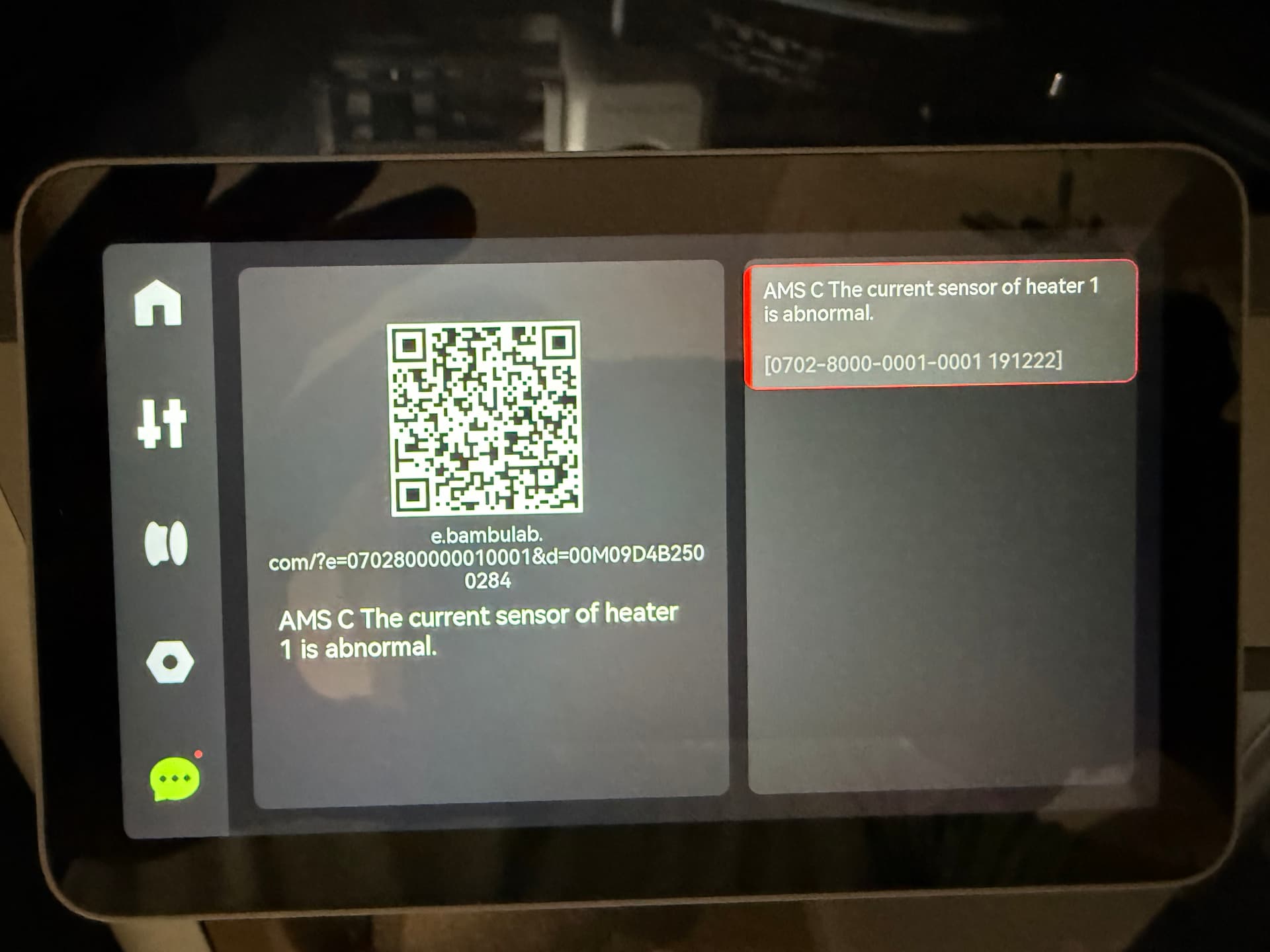

AMS C The current sensor of heater 1 is abnormal
Good afternoon,
I’ve got a 4 AMS 2 Pro setup with my H1C but suddenly one of the AMS started to show this strange error. I’ve searched all the BambuLabs knowledge base for the error code o no avail. The outcome is that the AMS starts the fans as if it were drying but it doesn’t heat up, and the above error is shown in the screen and the APP.
The code is [0702-8000-0001-0001 191222]
Anyone has experienced same error???
I’ve tried the usual ‘fixes’, power cycling the AMS and power cycling everything with no change. The error appears as soon as I start drying that AMS and dissapears when I stop drying.
