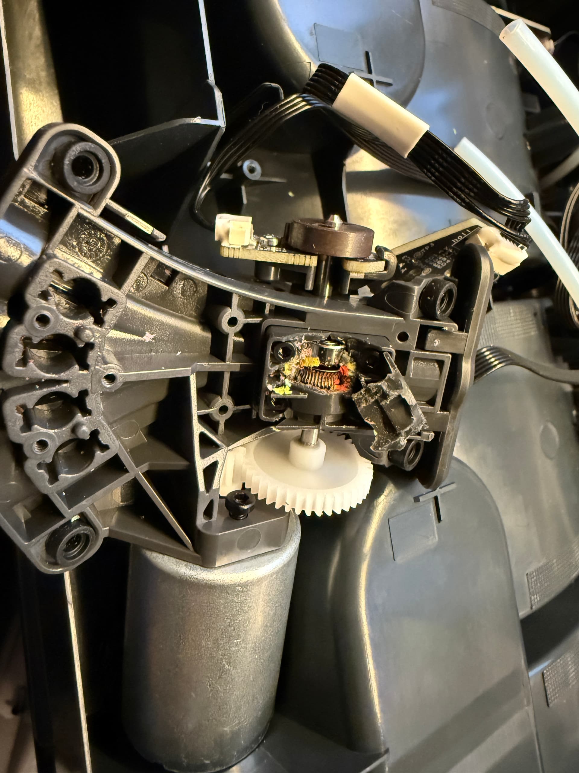

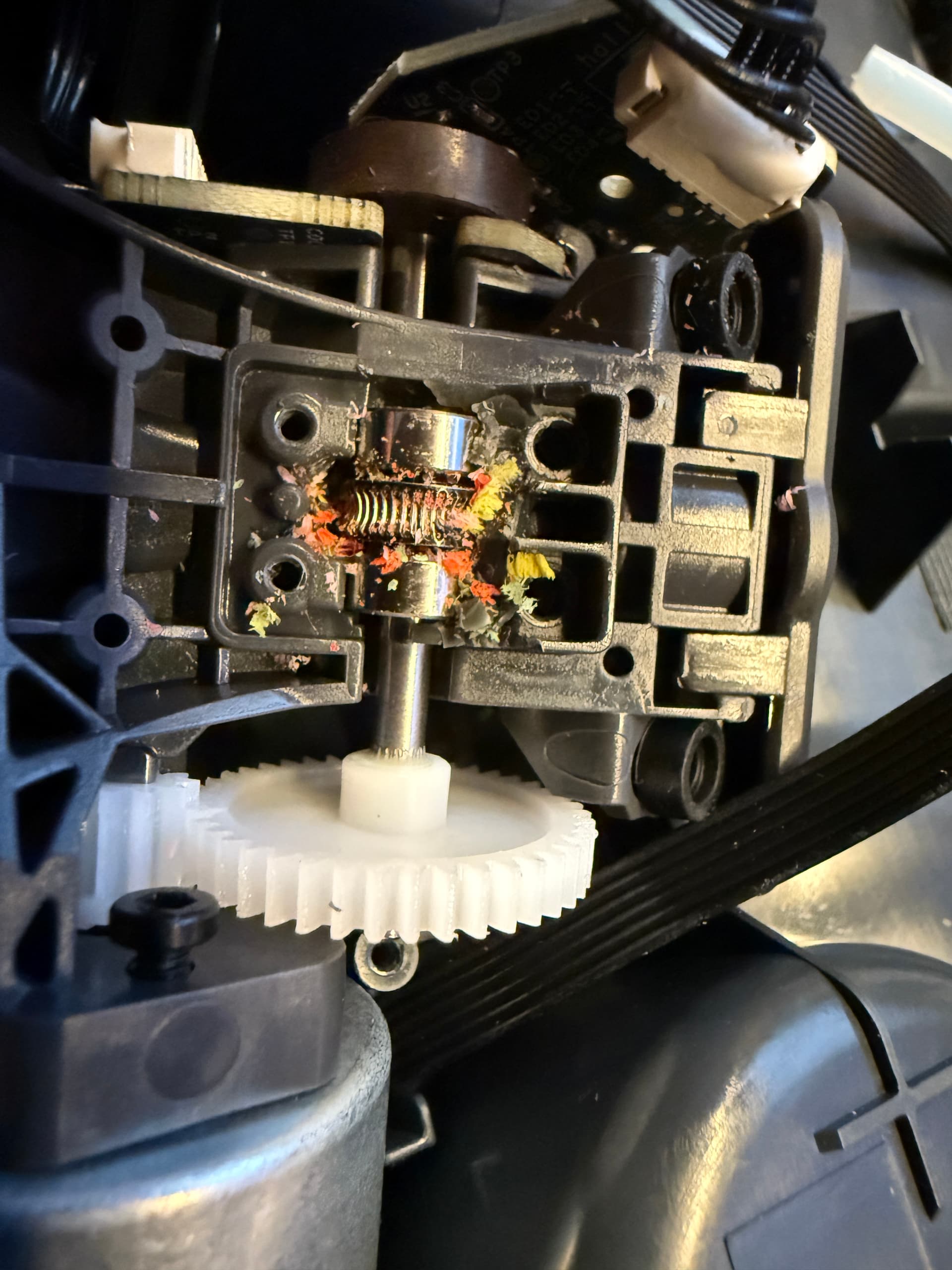

Thank you for starting this thread. My AMS has been acting up for a while now and had to assist it manually to feed the filament. Today I cracked it open cleaned all the feeders in front, but that did not help the issue. After reading on in this thread I cracked the AMS open again to check the rear motor and feeder. well that’s where the issue was. The cover that holds the feeder gear was damaged and the extruder wheel was just cracked on with filament debris. here is some pics. I guess I’ll be ordering the rear AMS assembly if its not covered under warranty (I had it for 6 months or so)
BTW, don’t take the whole assembly apart… LMAO

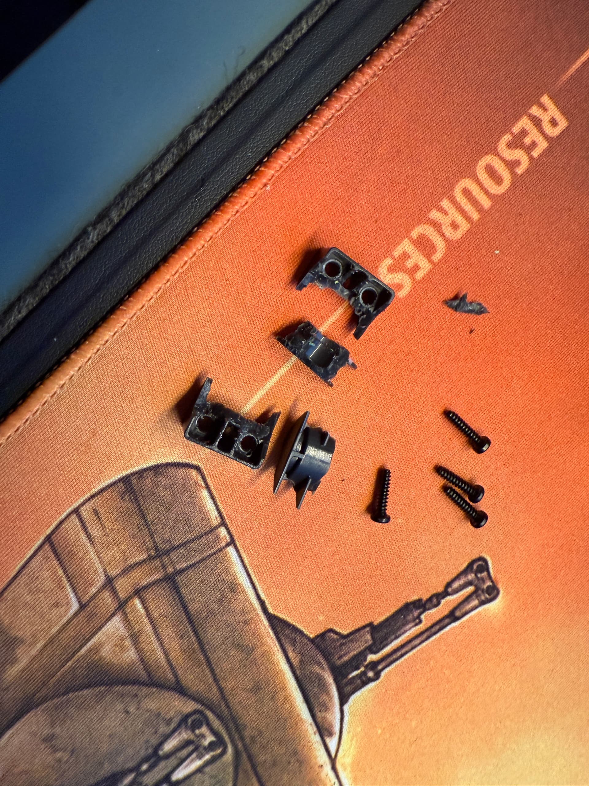

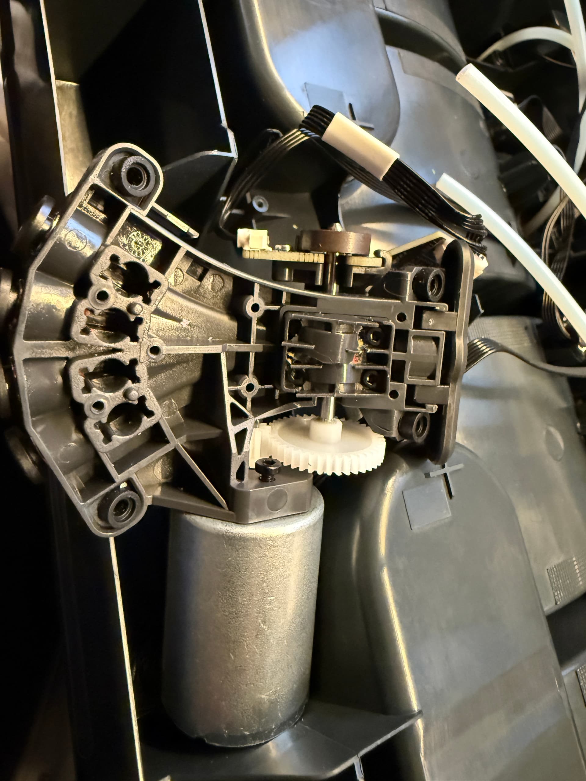

Lightly used AMS and printer started having the feed error during a multiple color print. Did all the internet/forum/youtube checks for solutions. One post said the gears in the internal hub unit can get gummed up with filament debris and the check and clean that. So I opened up the AMS and unscrewed the four screws holding the really thin and small plastic plate housing for the bearings and gear, only to find it split in half. The pressure from the filament going through the hub unit caused it to flex out and not give enough pressure to grab and advance filament. Explains the grinding noises it made trying to feed.
Super glued it back together to finish print and until I can get a new $55 internal hub unit. This is a pretty obvious design flaw and point of failure.
