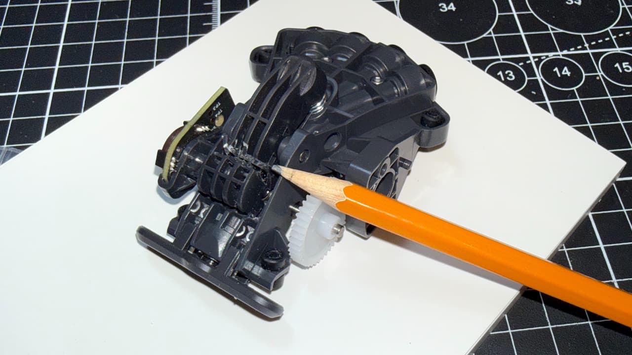

I had a similar problem. Do you hear the hub motor running when the filament stops near the extruder. My AMS internal hub was broken. 3 of the four slots were stalling when feeding to the extruder. I replaced the hub and it is working now.
