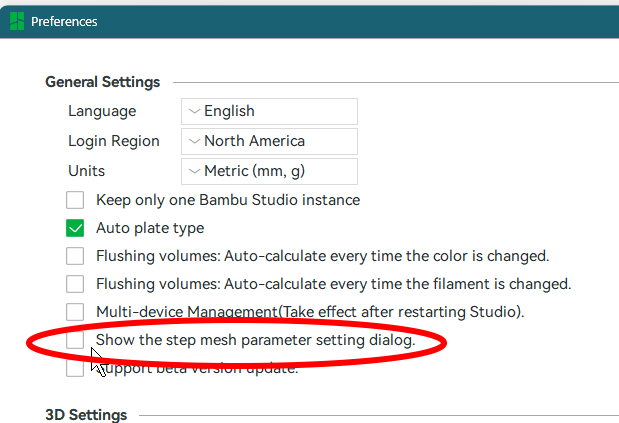

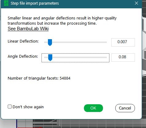

Problem: When adding STEP models v01.10 creates many more triangles than v01.09.
Studio Version: v01.10
Platform: Windows 11
Steps to reproduce: Add cylinder STEP file to v01.09 and it creates 516 triangles. Add cylinder STEP file to v01.10 and it creates 2516 triangles.
When adding a STEP model to Bambu Labs it comes in with more triangles in v01.10 than it did in v01.09. I noticed this because added STEP files in v01.10 had so many triangles that the program said there were more than a million triangles and to simplify the model. In v01.10 everything was slower and the .3mf file sizes were much larger. I was able to reproduce this in both versions by adding some simple geometry to each version and the cube had the same amount in each version but the cylinder has five times more triangles.
The complexity of the mesh created from the .step file is adjustable on import:
If you are not seeing this dialog, you probably checked the “don’t show again” box. It can be reset in Preferences (Ctrl P):
