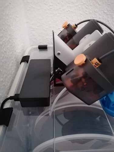

Hey ya’ll, building a dry box for my AMS Lite. Managed to get a large enough box to house the AMS Lite within, but the geometry of my desk requires I place the feeder system outside the box, preferably mounted to the side of the box. Any idea what 12-pin cables are used to connect the feeder systems to the AMS Lite mainboard?

Hey, thanks for responding. I was referring to the two 12-pin cables from the feeder system that connect to the mainboard. I can’t include links or images with my posts yet, but they’re visible in the AMS lite Body Installation tutorial where they take apart the internals. The two longer rectangular connection points at the top.

If you’re interested, extending the cable isn’t a problem. Even the longer tubes are no problem for the AMS. This is what the result looks like. It’s an A1 but that doesn’t matter.
Do you have any more details about your AMS box? How easy is it to change a spool?

I used this one
But this only affects the solution for the AMS. The spools run on threaded rods and ball bearings.
[image]
Changing spools is easy. But in my case it is unfortunately not perfectly airtight. I have ~25% humidity which is not really good. There may be better systems. At least it protects against dust.
I have seen the message about the cable issues. But my cable is ok. In my case it looks worse then it is. It could be better but unfortunately there is no other way. I will still print the cable protection anyway.

My enclosure is actually open at the back. It fits in, but just barely. Look at the 220v power cable. I wouldn’t bend it any more. And the heating bed cable would be compressed even more if there was another plate at the back. Due to the current problems with the heating bed cable, I would advise against using a plate at the back. You can’t push it further forward because otherwise the print bed will push open the front window.
The last photo is with heatbed full extended
Your see there is not much room
It was just a first draft. The edges could be a little more rounded. But it works without any problems.
