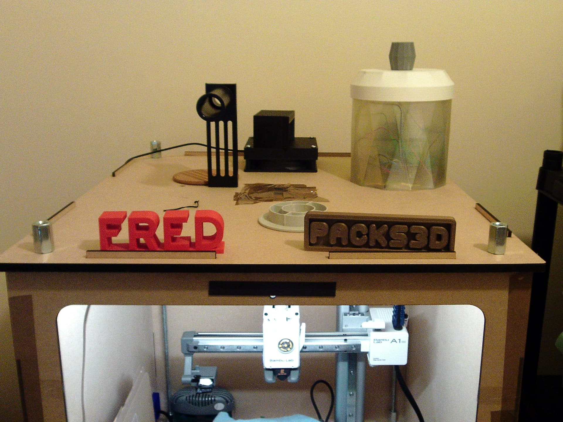

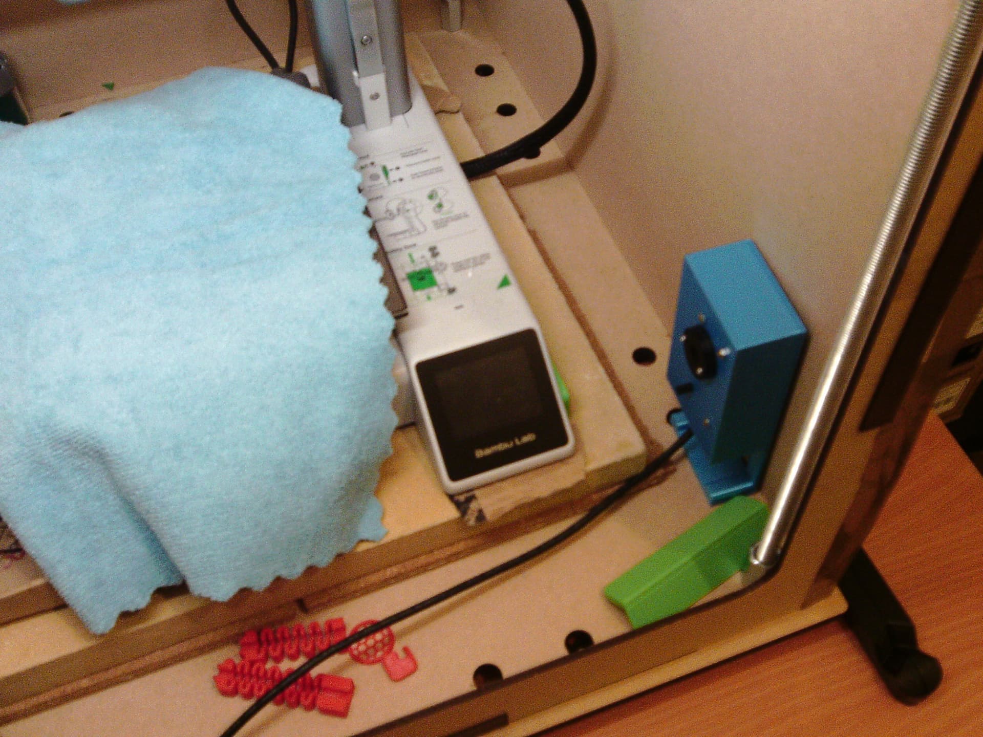

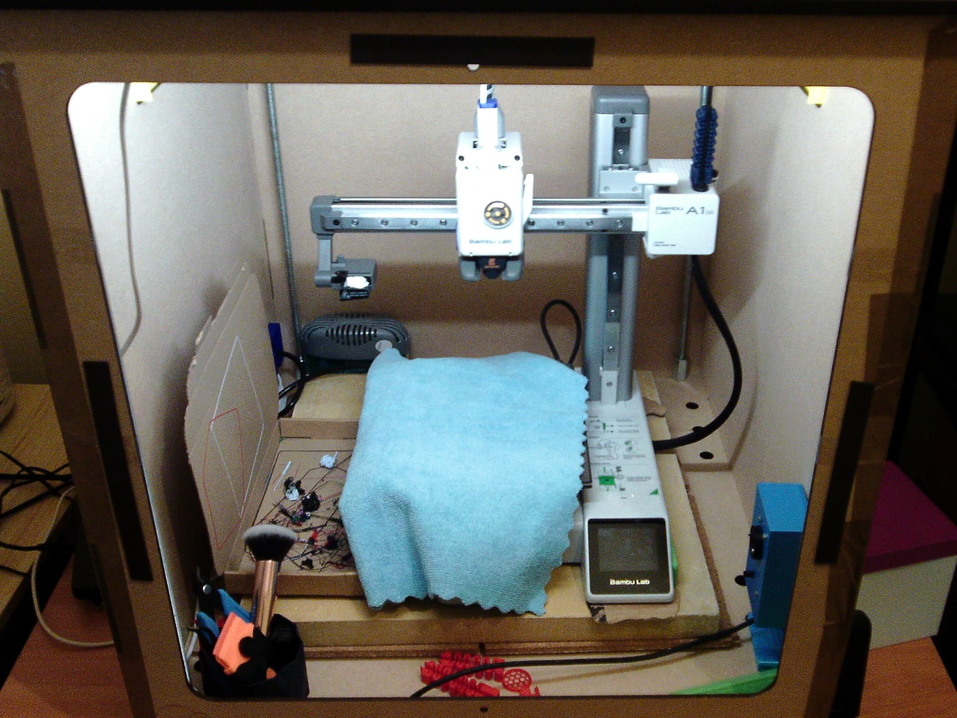

Hi,
I’ve attached some pictures of the enclosure I designed for my A1 Mini (based on the same enclosure I did for my Creality Ender 3V3KE - but smaller).
It’s made from 4mm MDF for the side panels with 9mm MDF for the top and bottom layers - the bottom layer has lots of vent holes around the edge and along with the hole on the top layer (big enough for a 120mm extractor fan) I get a nice chimney effect so the A1 mini keeps at a nice temperature (I’ve not had any issues with over-heating even with the clear perspex door on (attached with magnetic tape for quick removal).
As the enclosure isn’t air tight I just print with PLA but it’s enough to keep dust and draughts out and when the door’s on the fan noise etc. is greatly reduced (it’s so quite I keep on having to check that it’s still printing).
Size wise (internally) it’s 550mm high by 510mm wide by 560mm deep so there’s more than enough room for my low-tech poop collector , Raspberry Pi Zero 2 camera and all the tools I need to keep my printer chugging along.

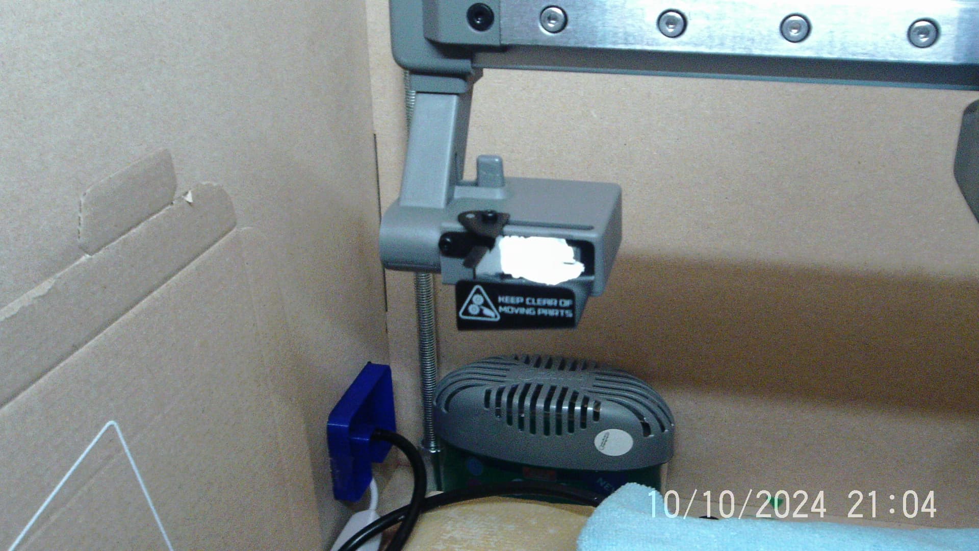

I’ve attached some pictures so you can also see how I’ve mounted my spool holder (an old Creality one) on top of the cabinet as well a close up of the purge wiper (complete with tipex / white out background so I can see black filament being purged).

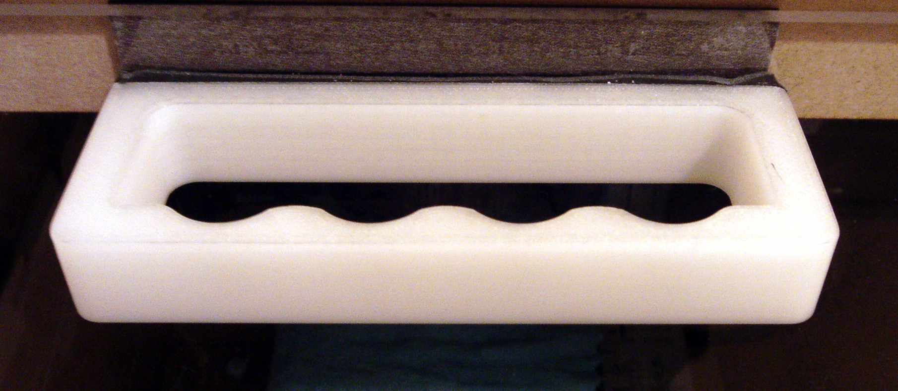

There’s also a picture of the door handle I designed (printed in 3DQF’s clear filament) that’s simply attached with double sided tape.
