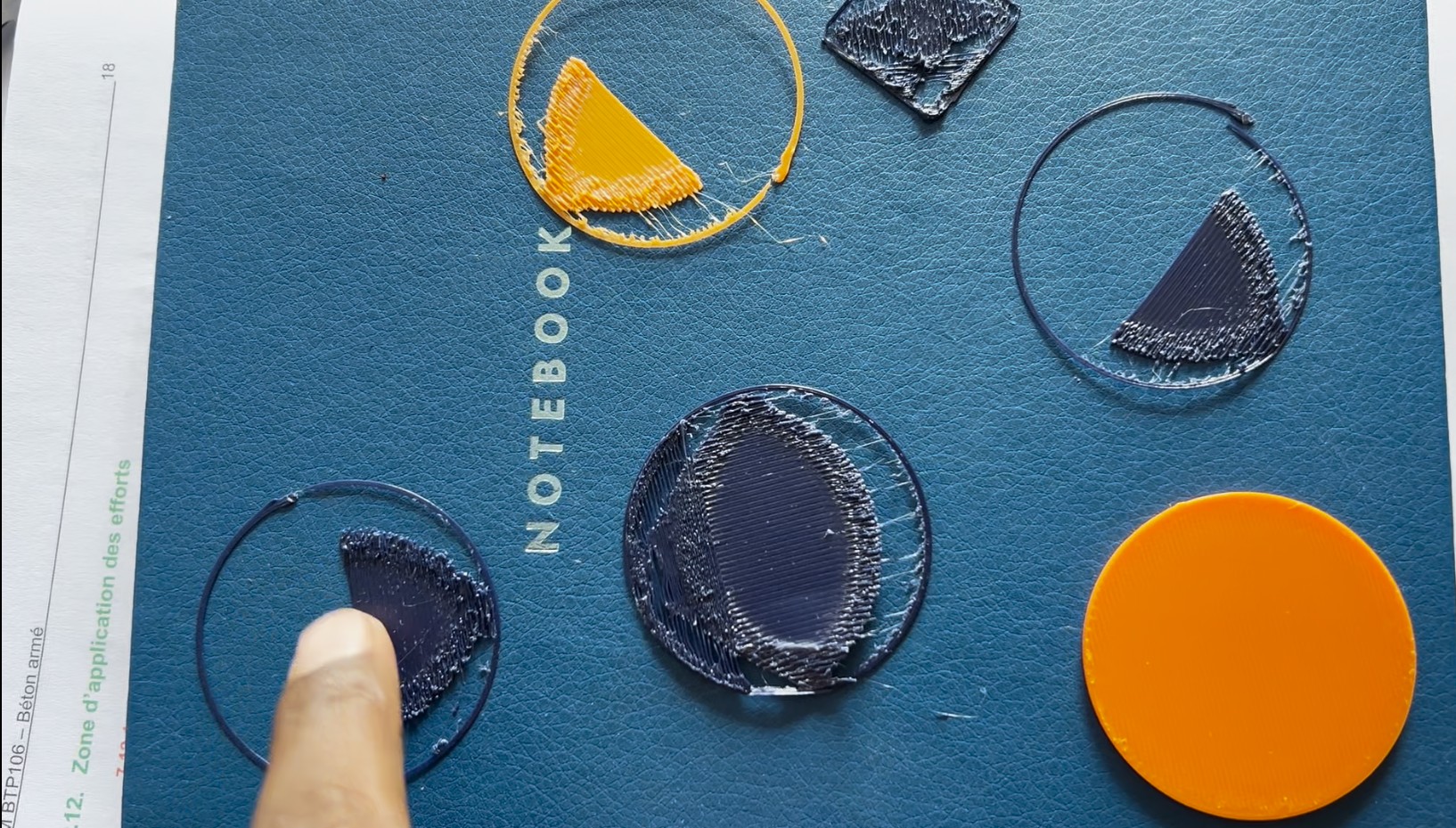

First layer print Failed
Filament used for test : ABS et PLA
Plate : Textured PEI Plate - cleaned well and when printing applied glue for adhesion.
Setting : Basic Bambu lab setting except I changed outer wall speed to 100mm/s

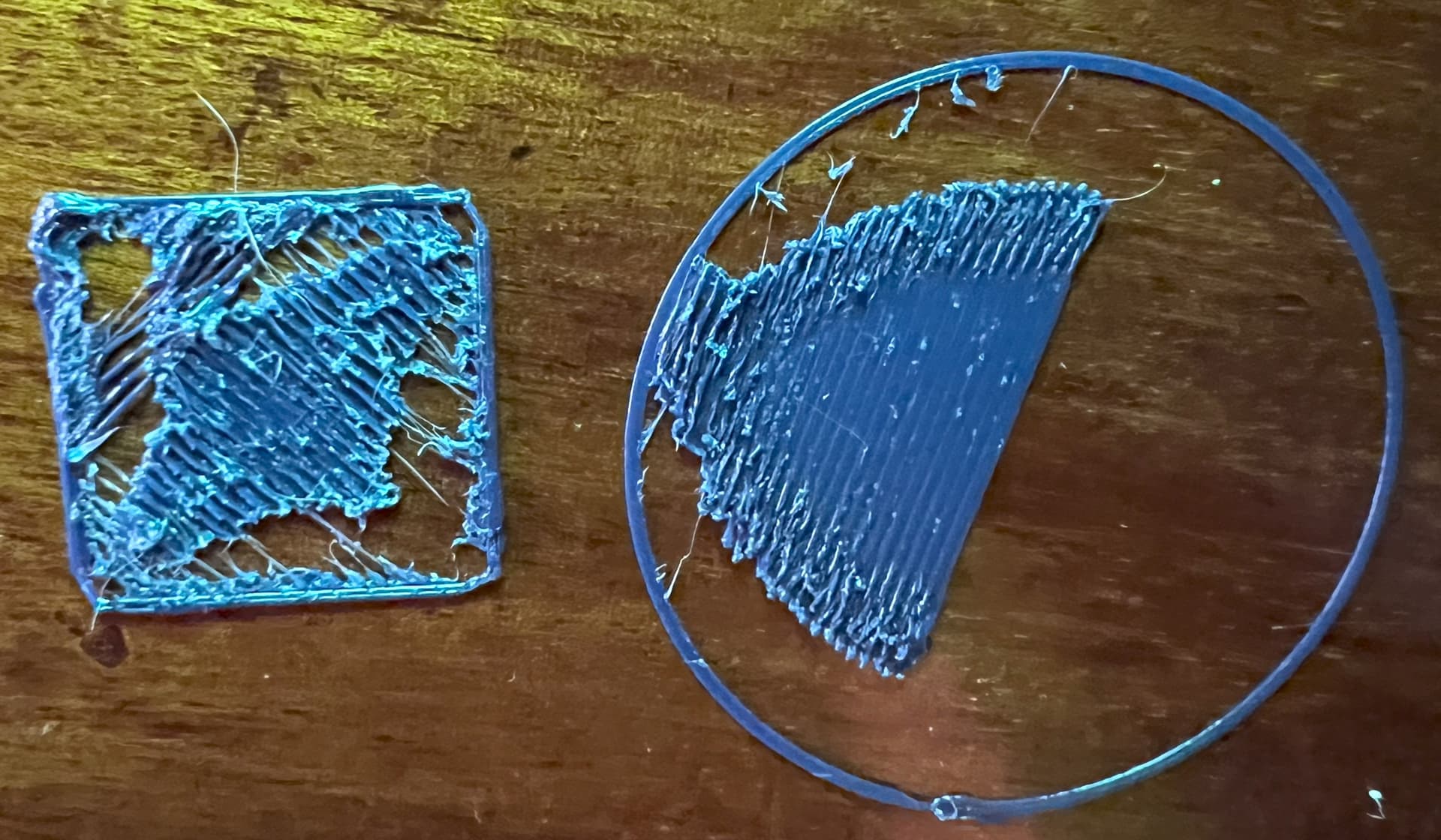

Enjoyed the past 6 months with out any problems with my Bambu Lab P1S. The past two days I couldn’t even print a single one. Print failling from the first layer. I thought its a clog problem, so I did Hot end Clean up (I even changed a new hotend) and checked if Filament stucked on the Extruder gear. But both looks fine and my print still failling from the 1st Layer. (see Images below)
I will appreciate with you support if you have a solution. Thank you all.
A factory reset has solved this issue for others on the forum. It seems like an incorrect flow dynamic value is causing the issue.
Thank you @JonRaymond for you quick response. I will try that now and let you know.
Reference
It works well the factory reset. Thank you JohRaymond and ramcdona for this great tips. Now back to printing after struggling for two days.
