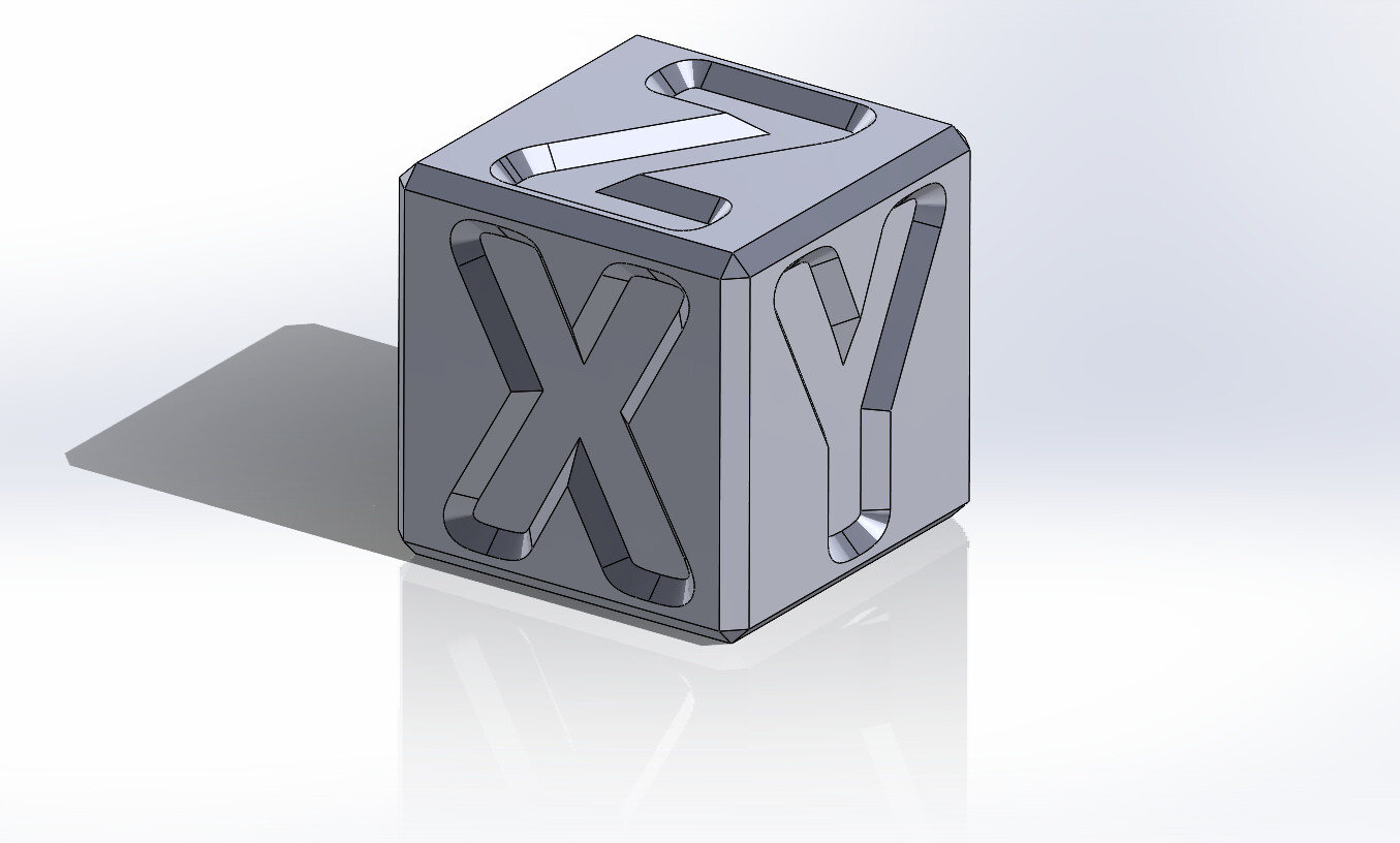

Finally, you can try a calibration cube to make sure the Z steps/mm are correct. Print it, measure with calipers, and calculate the difference. It’s a 20mm cube so if the print is 19.9mm tall then I wouldn’t be too worried, but if it’s something like 18mm then you know it’s way off.

I’ll definetely print the calibration cube and see what happens.
