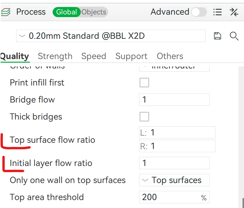

There are flow rate settings for first and top layers under advanced or experimental.
I wonder if that flow rate is absolute or relative to the standard flow rate. It really feels like a slicer issue to me.
In Dev mode there are such settings:
But most probably it will need to be tuned for every object and every combination of materials, nozzles and etc. Which will be madness of testing, and absolutely fail the idea of the Bambu printers.

After running a bunch of tests and inspecting and editing the machine start GCode, I have a much better first layer result on my H2C. This change could affect the top layers as well depending on how thin your print is. I’ll try to sum up my testing and findings as best I can. Here is a picture of one of the final results, I labeled it with R2 for the #2 right nozzle being used for the color.
Above shows some small gaps in the yellow D20 outline, but that is mainly because of how small it is and the limitations of a 0.4mm nozzle. In future prints I’m tweaking settings still to get that a little better, however, the biggest thing is that you can’t see all the lines in the black area and the filament is fused between the yellow and the black. You also cannot see any extrusion lines in the yellow letters.
Short description of Fixes/causes:
  1. Machine Start GCode for the 0.4mm H2C default profile is incorrect. It does not apply any z-offset for the textured build plate.
  2. Some nozzles cause under-extrusion. I believe this is due to a manufacturing issue causing more resistance inside the nozzle.
  3. Slight bed leveling issue (Front of bed has the nozzle closer to bed when printing than the middle or back)
Before doing anything, I made sure to cold pull all the nozzles and wash my build plate with dawn dish soap and ensure it was rinsed thoroughly. I’m also using all Bambu Lab filament (Basic PLA and Matte PLA for some colors).

I then took a look at the Machine Start GCode I was talking about before. I looked at the P1S start GCode and compared that with the H2C start GCode. This is what the Textured plate section of the default H2C machine start GCode looks like in the current version of Bambu Studio:
;===== for Textured PEI Plate , lower the nozzle as the nozzle was touching topmost of the texture when homing ==
{if curr_bed_type==“Textured PEI Plate”}
{if nozzle_diameter[initial_no_support_extruder] == 0.2}
G29.1 Z{-0.01} ; for Textured PEI Plate
{else}
G29.1 Z{-0.02} ; for Textured PEI Plate
{endif}
{else}
G29.1 Z{0.01} ; for Textured PEI Plate
{endif}
{endif}
The P1S section looks very similar, just simplified a little bit because there is no 2nd nozzle. The P1S z-offset for the textured plate is -0.04mm, where this would only be -0.02mm. Also, I have no idea why it is checking for a 0.2mm nozzle in the 0.4mm nozzle printer profile.
Via many test prints and measurements with calipers, I adjusted the machine start GCode to have a different z-offset. I tested this with both a flat plat (Biqu Glacier) and the textured plate. After dialing it in with the left nozzle, i also tested and tweaked with the right nozzle. My final GCode is as follows: ***** USE CAUTION when changing GCode, Use at your own risk.
