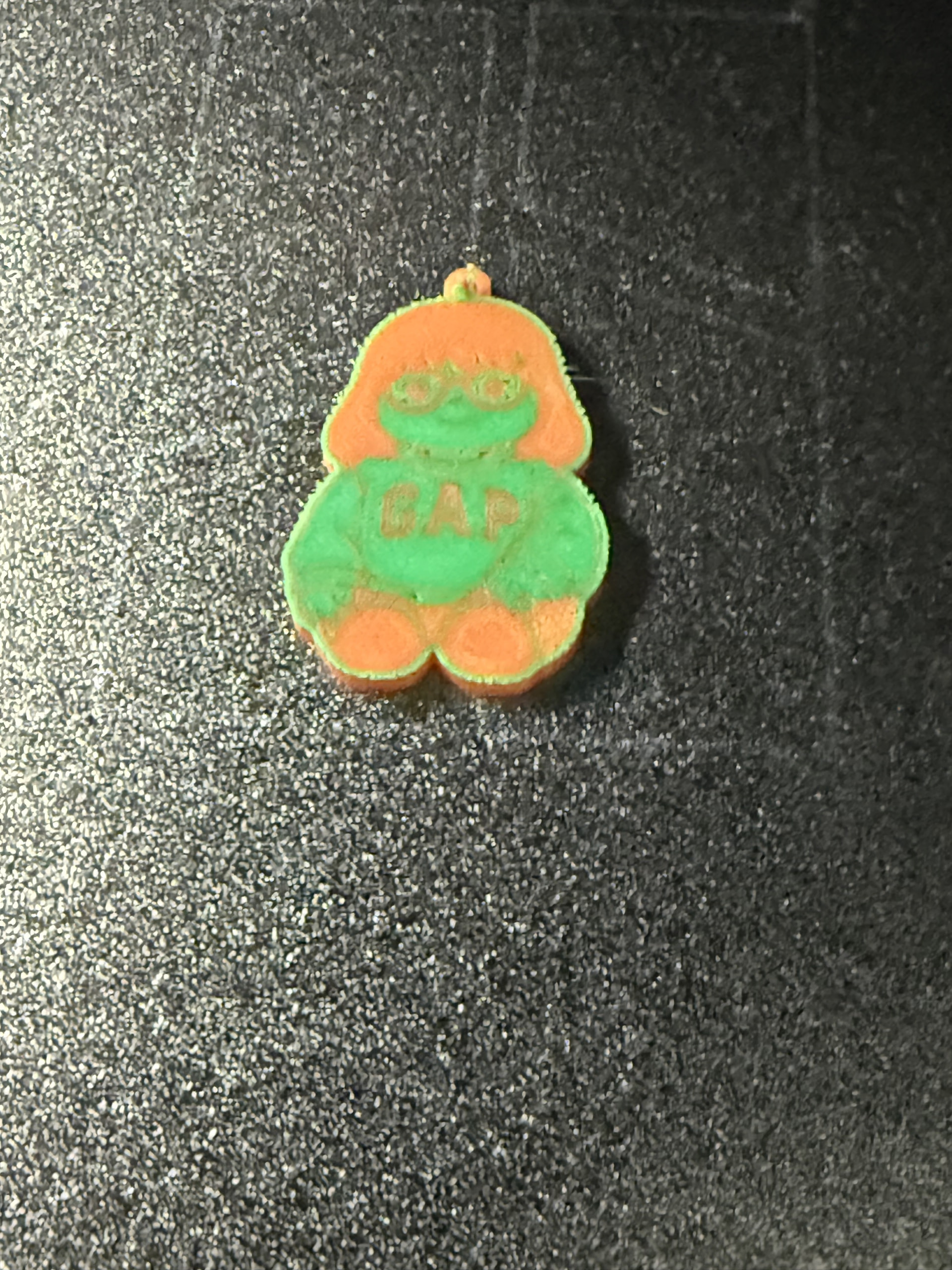

I’m a beginner in 3D printing. I wanted to print a flat keychain, about 3mm thick and about 50mm high. I used a P1S printer, PLA Basic filament from bambu, and a 0.4 nozzle.

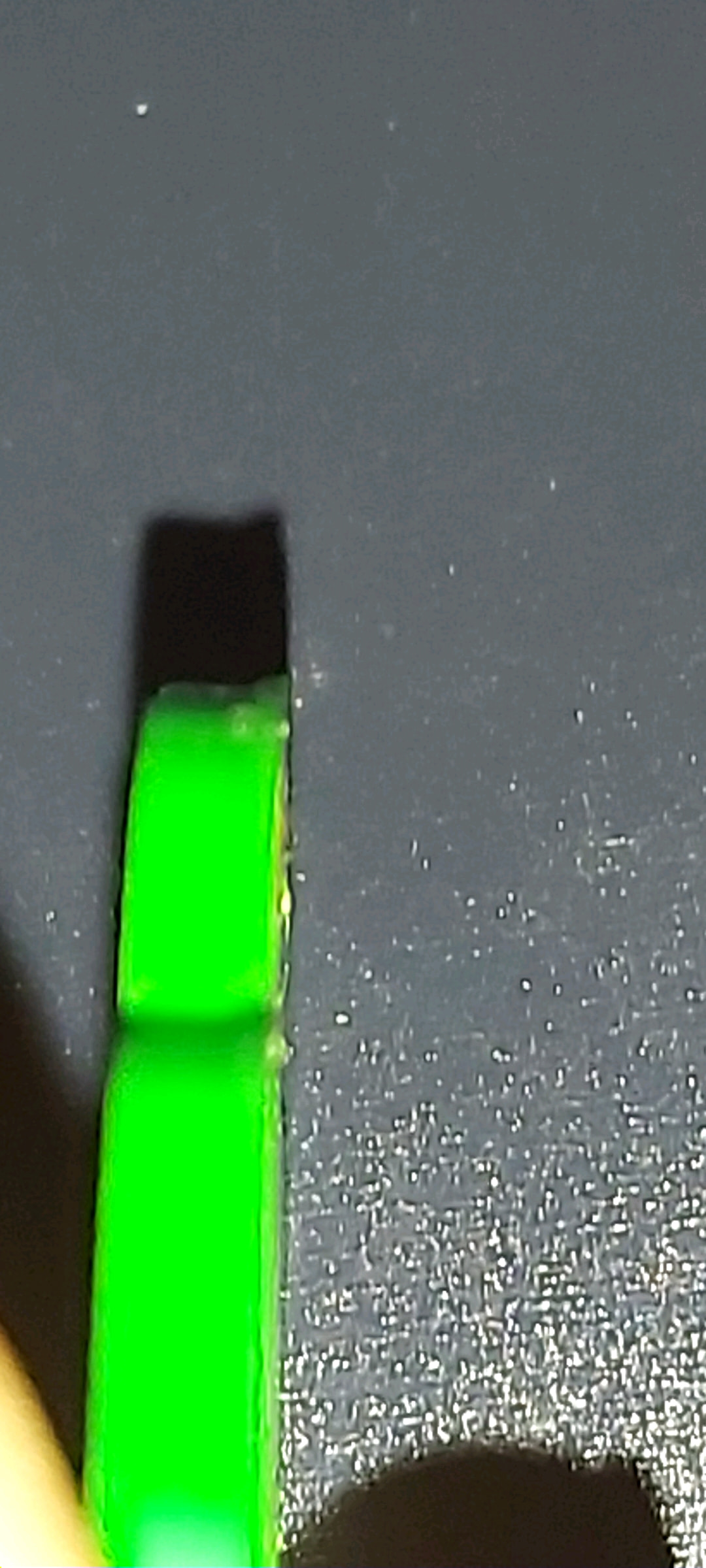

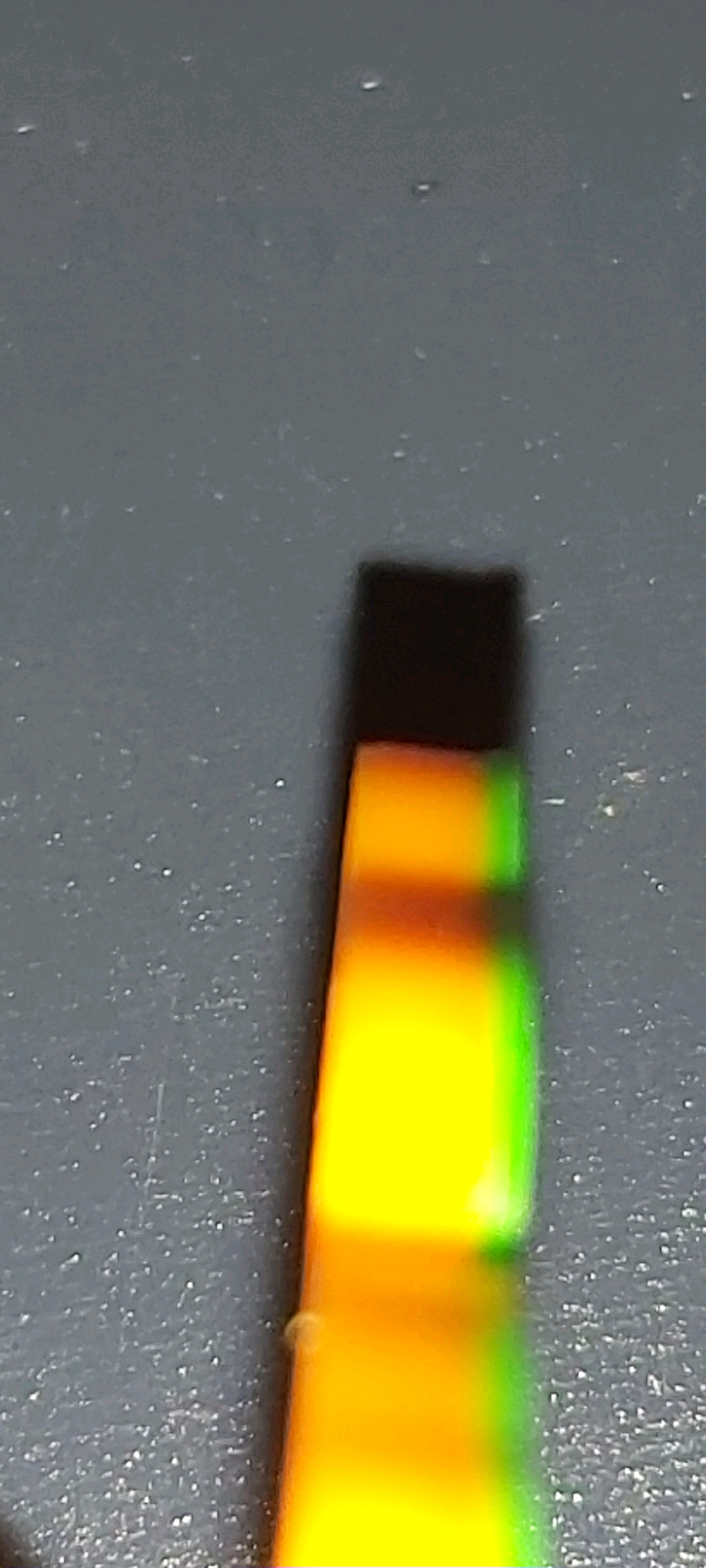

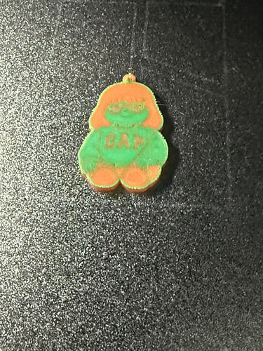

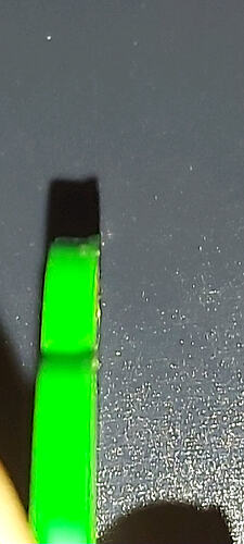

First, I printed with a 0.12mm fine setting and ironing enabled. The last three layers bulged outward around the entire circumference of the printed keychain. For the second print, I changed the settings to 0.08mm extra fine and turned ironing off, but the effect remained. Overall, the keychain printed quite nicely, except for the upper, protruding edges, which are a bit jarring.
no ironing:
with ironing
This is best seen in the shadow cast by the printed object.
What should be set to make the wall come out straight?

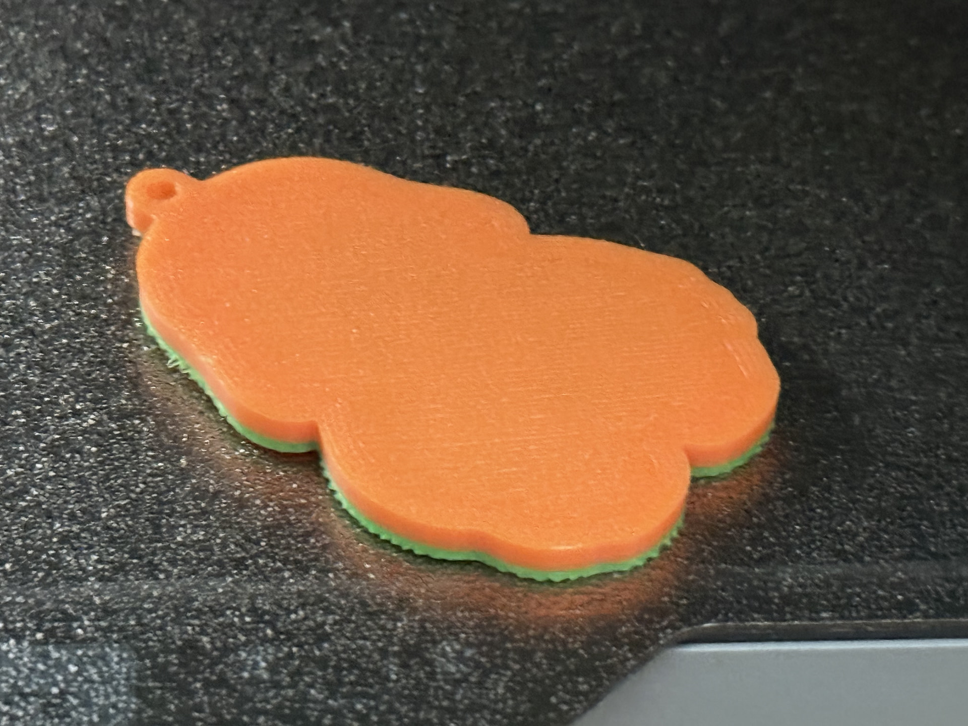

Your model printed without issues, using your settings. Your colour choices make the model difficult (for me at least) to look at it without it doing my eyesight serious damage.
I have just started printing a second version with the prime tower enabled. For my own purposes, as I would like to see if it hurts my eyes less.
I think that is me.
I used your identical filament choices and colours with every setting the same as you had them.
The model had a perfectly flat bottom and a flat top.
