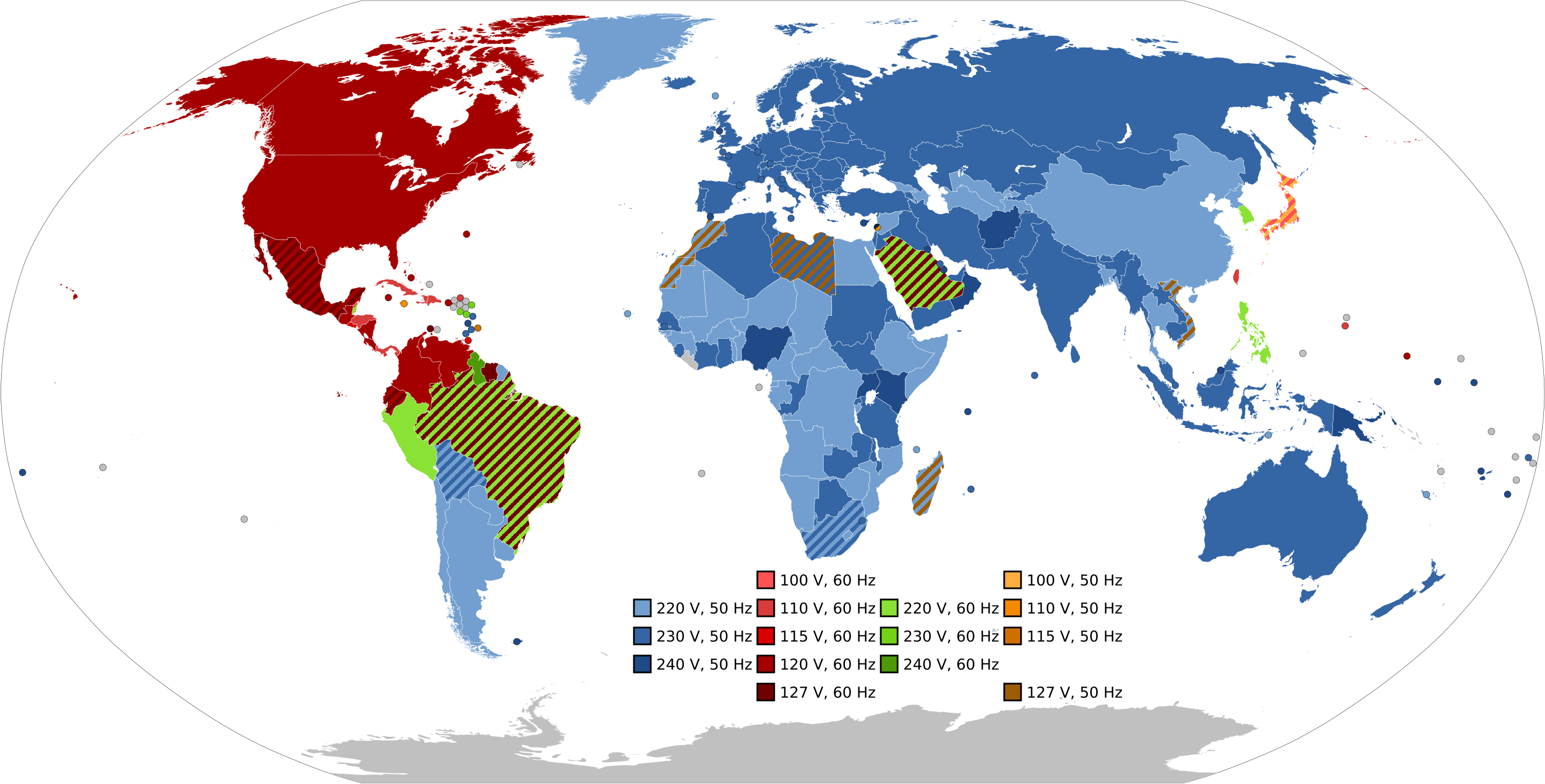

Have we considered the voltage here?
Forgive my Copilot story below, but it definitely changes the max power rating @120V.
The power (Watt) of a device depends on the voltage (Volt) and the current (Ampere). If we assume that the device is a resistive load (such as a heating element), the formula applies:
P = \frac{V^2}{R}
Where:
  • P is the power in Watts,
  • V is the voltage in Volts,
  • R is the resistance in Ohms.
If the device originally uses 1320W at 110V, we can calculate the resistance R :
R = \frac{110^2}{1320} \approx 9.17 , \Omega
At 120V, using the same resistance:
P = \frac{120^2}{9.17} \approx 1570W
So at 120V, the device would consume approximately 1570W, which means an increase in energy consumption. This could impact the lifespan and safety of the device, depending on its specifications.
However, if it is a device with a constant power source (such as some electronic power supplies), the power may not necessarily increase this way. In that case, the current would adjust to maintain the same power level.
And you might want to check if the voltage is not higher during the day when a lot of solar panels raise the voltage even more.

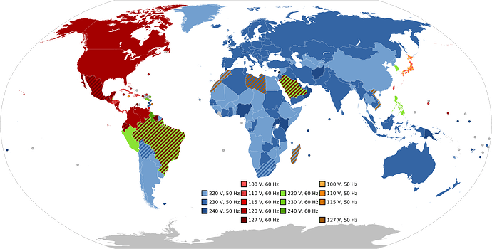

You just beat me to it, I was about to show the calculations based on a 120 V nominal system in the U. S. And there will be certain spikes in voltage if the heating element is on a PWM style controller.
I don’t know why anybody uses a 110 Volts as a standard voltage for US. We haven’t seen that in 50 plus years for most of the U. S.
Here an overview of the world:
There are even regions with 100V.
Yea, I definitely didn’t mean for this to be controversial. I don’t want a feature added that restricts heating for everyone. If you got the power for it like dedicated circuits, or live where 220V+ is the norm then that is great. I wish we would go to 220V here in the USA.
