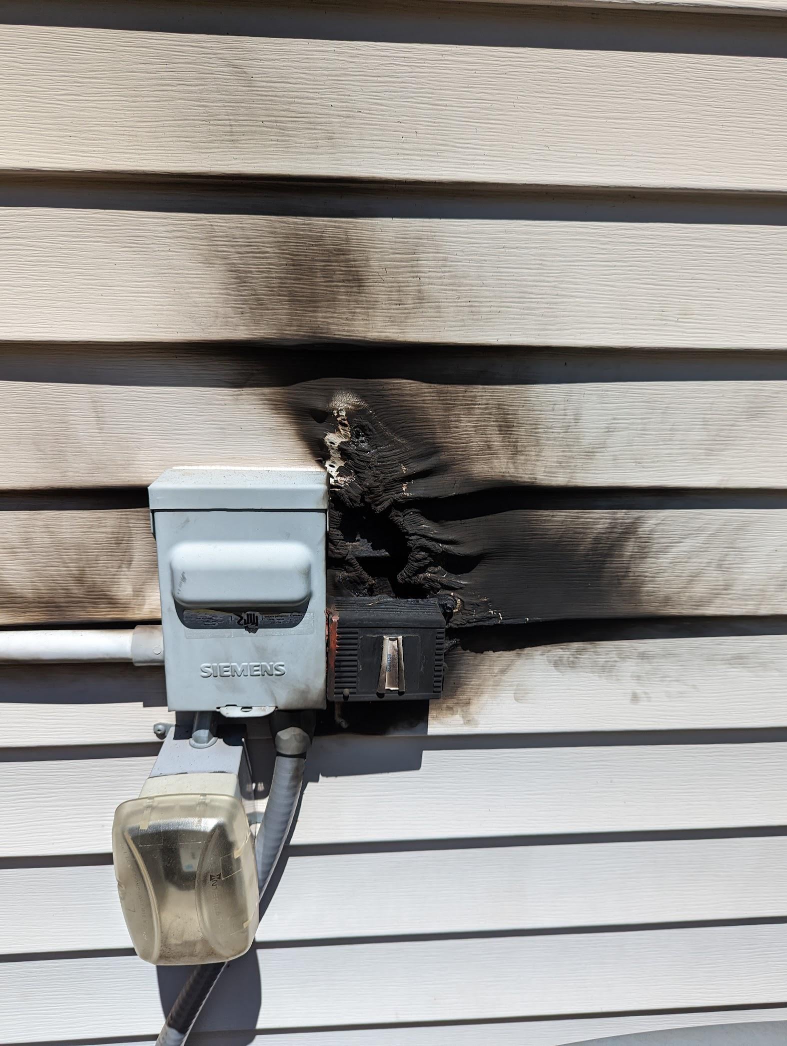

I’m not a huge fan of that one for 2 reasons.

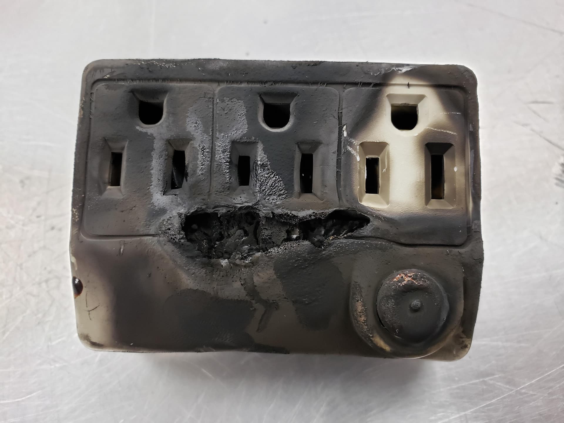

  1. Its in a plastic enclosure. If for some reason, you actually have a very large power surge thats larger than its rating, the components(MOVs) in most surge protectors can explode. So anything that’s serious for surge protection would most likely be in a metal enclosure or be designed to be installed outdoors (whole home surge protecton installed on outside of panel).
  2. I’m not a fan of any surge protectors or power strips that hang off of the outlet. They generally will start to pull partially out once you plug stuff in which could cause compromised connections or start wearing out the receptacle retention springs that hold the prongs in on the plug. The ones that do secure themselves to the outlet with a screw on an old style duplex receptacle are fine, but they generally are at a reduced amperage rating.

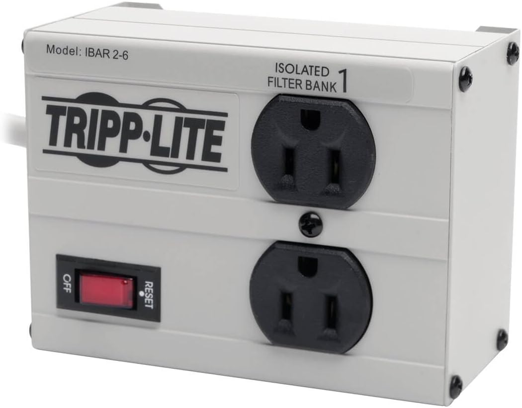

This one from trip light is rated for 12A due to the internal breaker (All components and wire are rated for a 15A curcuit), 12A is the most you’re ever supposed to load up on a fifteen amp circuit(80% code requirement to protect in wall wiring). It has a 12A resetable circuit breaker in it. It’s in a metal enclosure and protects upto a 1410 jule event. If your circuit breaker is working properly, it would be tripping on a constant load that is less than 15A. They trip based off of the trip curve (time and load). If you have a really high amperage draw it will trip fast. If you are overloaded a little, it will take a while to trip.
15A (12A breaker, 1410 jule rating, 2 outlets)
15A (12A breaker, 3330 jule rating, 4 outlets)
https://amzn.to/4mJ4AkE
They also have units with more outlets but cost more.

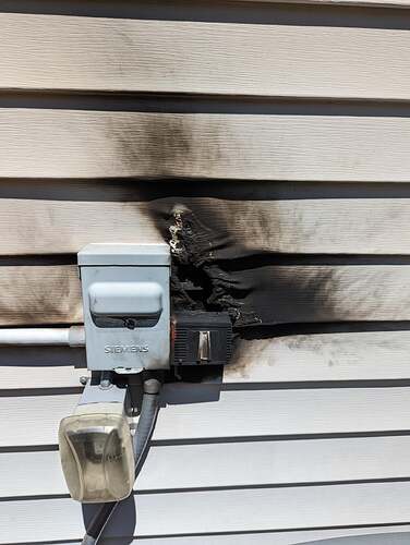

Surge protection works best if you have a whole home surge protector installed at the main panel coming into the house. Then you have downstream surge protection for sensitive devices where they recieve power. This way, the large surge protector will help clamp and reduce the surge going to the whole house. Most large surges will not be completely stopped at the first device. Small ones can be. The smaller device that you then plug your items into will then eliminate(or reduce to a non harmful level) the remainder of the surge in a perfect world. In short, surge protection works best when you have a series of devices inline.
FYI.
This is what surge protectors look like when they blow up from a big surge event.
Surge/splitter combo
Whole home surge protector
Well, I guess that one’s out of the question lol. Unless I only use my EcoFlow for the initial heat up and then switch it back to grid when it drops down. 12A @120V would be 1440w correct? The 80% safe limit. The last 2 warm ups my H2D did were at 1550-1580w. That breaker would pop right away.
That’s one of the reasons I wanted the one I linked, it screws in where the outlet cover usually does for a solid attachment.
The breaker wouldn’t necessarily(but may) trip right away. It depends on the trip curve for the breaker. I actually have that 2 outlet one for my C02 engraver. I can do a high temp print and see what heppens.
I didn’t realize the one you linked had the 2 screws, so that’s a plus. I personally am not a fan of the plastic housing for a surge protector. The pictures I posted above were from the internet, but I have seen a few in the field that looked the same. I do not remember what brand but they were plastic. Note this is specifically concerning a surge protector that’s in plastic, not just a general use power strip for normal items.

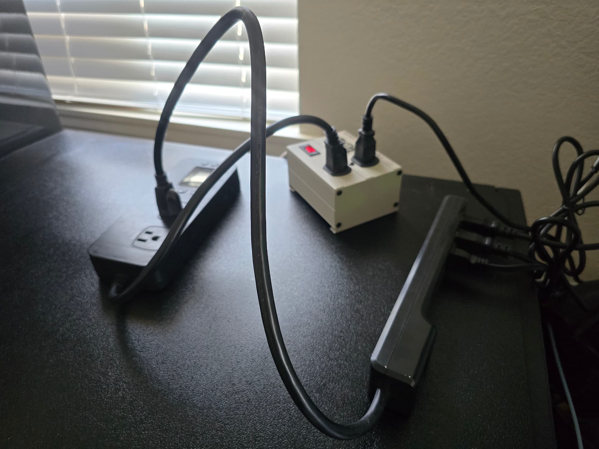

  • Tripp Lite IBAR2-6D (15A, 12A internal breaker, 2 outlet, metal enclosure)
  • H2D printing PAHT-CF, 290c nozzle, 60c Chamber, 100*c Bed
  • Printing from AMS HT
  • 2x AMS Pro 2, Drying PETG at same time.
  • H2D plugged into one outlet
  • 2x AMS2 (Heating), and 1x AMS HT(not heating) plugged into the other with a power strip.
I started the AMS2 Pros heating as soon as I saw the bed and chamber start heating. This way everything would heat at the same time.
From Previous test I know my H2D doing high temp heats up right around 1650 watts for 2-3 minutes. Right now I just tested and the two AMS2 heating up and the AMS HT (not heating but feeding) with external power supplies maxed out with only 165w(combined) of power draw while heating up. Now they are steady at 60-80w(combined). They are plugged into the same power strip/watt meter.
I will keep it plugged in like this for the next day to see if I get a random trip.
This is a setup I would definitely not use with all the powerstips other than testing. Lol
