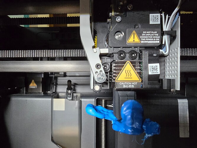

OK so I started a print. I am not going to bore you with how it happened but I ended up with a blob.
I order to solve the problem I turned to YouTube got a screwdriver, took the hotend out and cleaned it. In order to do that I had to use a heatgun to remove the remnants of the blob and the piece of filament that was stuck in the nozzle. I tried to stear clear of the fan as much as possible.
Since I was this far I decided to take the extruder apart because I had the hard metal gear set that still needed to be installed. I wasn’t very complicated. However …
When I had put everything back together again I wanted to calibrate the printer before printing. The calibration stopped. When I had a look at the little screen it said “HMS-ERR-0500-0300-0001-0002”. I looked it up and it said that this meant Toolhead malfunction. Remedy restart the printer. I restarted twice but this made no difference.
So I checked the plugs. They seemed ok but the error message remained. I then took the hotend and extruder out again, inspected them and resassembled. I put all the plugs back again said a prayer and switched on the printer.
No joy the error message remained. Suggestions anyone?

Only a small blob.
