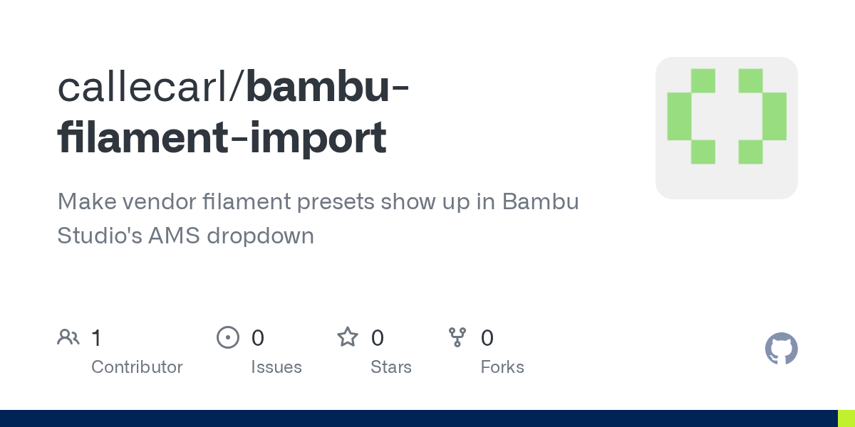

Had the same problem with addnorth’s downloaded presets on my P1S – they showed up in the Prepare tab but never in the AMS list.
Turns out Studio only puts filaments in the AMS list if they were created with Create New Filament. Imported files don’t count, no matter what you do with them.
So I made a small Windows tool that does that step for you: drag the downloaded profile files into it, press import, start Studio – and they show up in the AMS list under the vendor’s name, with the vendor’s settings intact.
Studio needs to be closed while importing, and you need to be logged in with preset sync on. Worked for me on Studio 2.8.2. Hope it helps someone.
