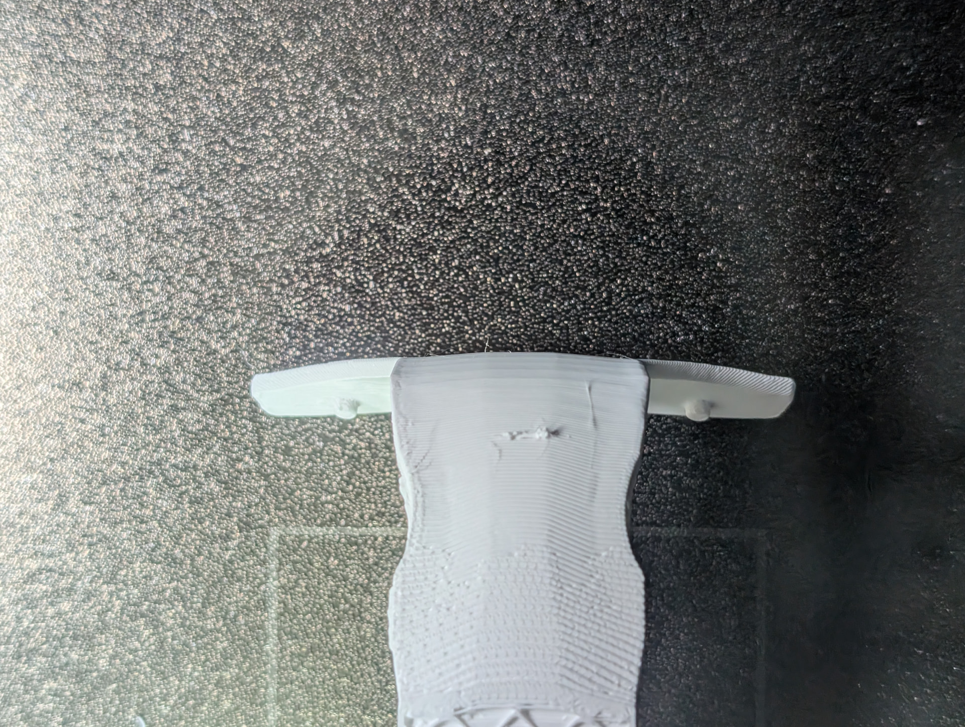

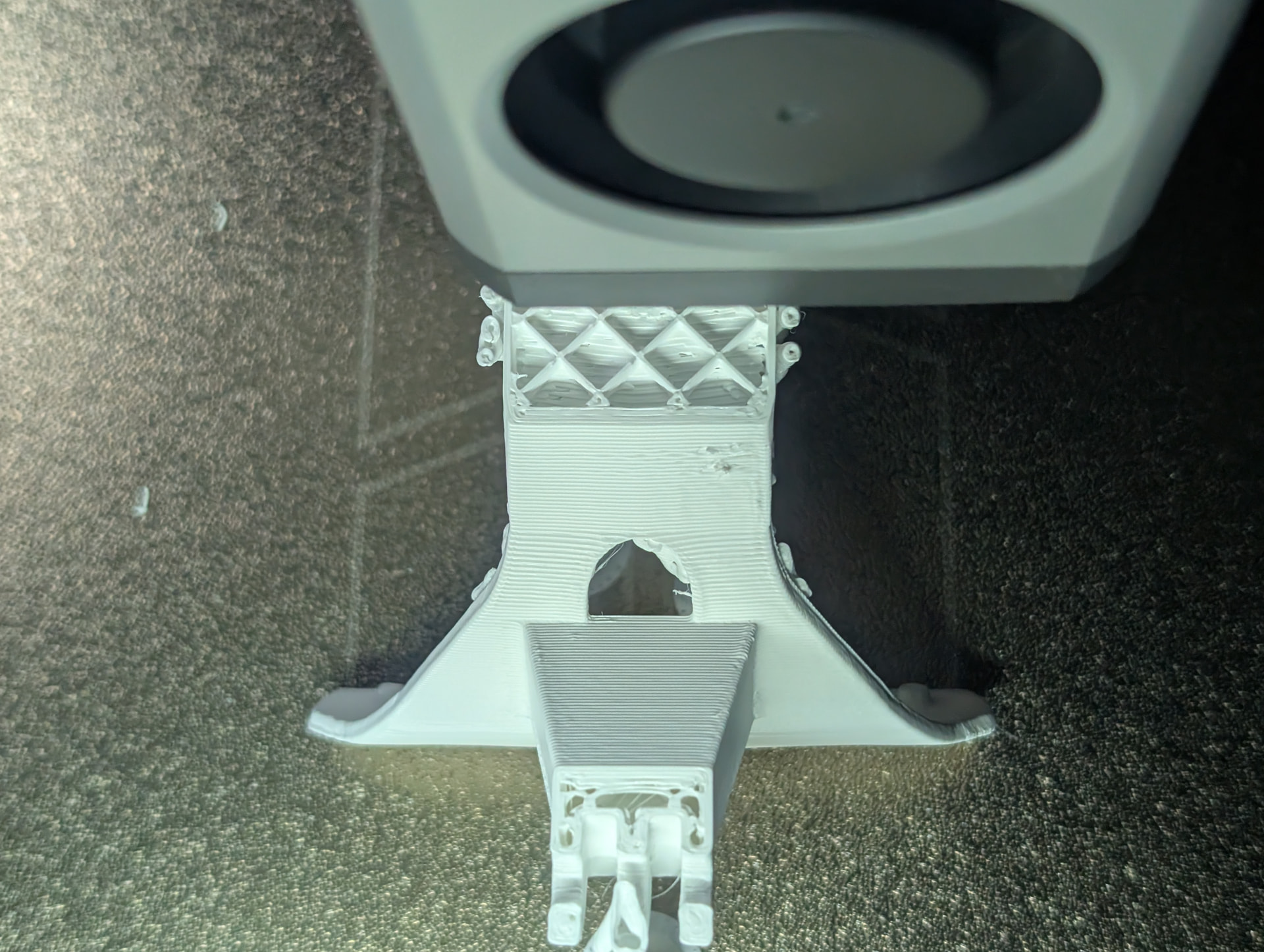

so i did a bunch of cleaning and i still have some of these spots that appear randomly and i dont know what these are
Can someone help me figure this out maybe?
How are you drying and storing it?
i dried it in my AMS 2 Pro 65°C for 12 Hours and its also stored in the AMS
Reason I asked is the photos look something like the issues others see when the filament moisture content is too high. PETG Basic is new though so not much track record to really know.
If you take that spool (hopefully over 1/2 full still) and put it in a ziplock bag with a hygrometer and seal it, in an hour you should have a stable humidity reading. That would give an idea of how effective drying is going and could help narrow down what’s going on.
Just not much info yet on how much moisture causes problems with PETG Basic. I ran the test with PETG HF and found the cutoff for me was around 20% RH with it. PETG Basic is likely similar but can’t say that for certain.

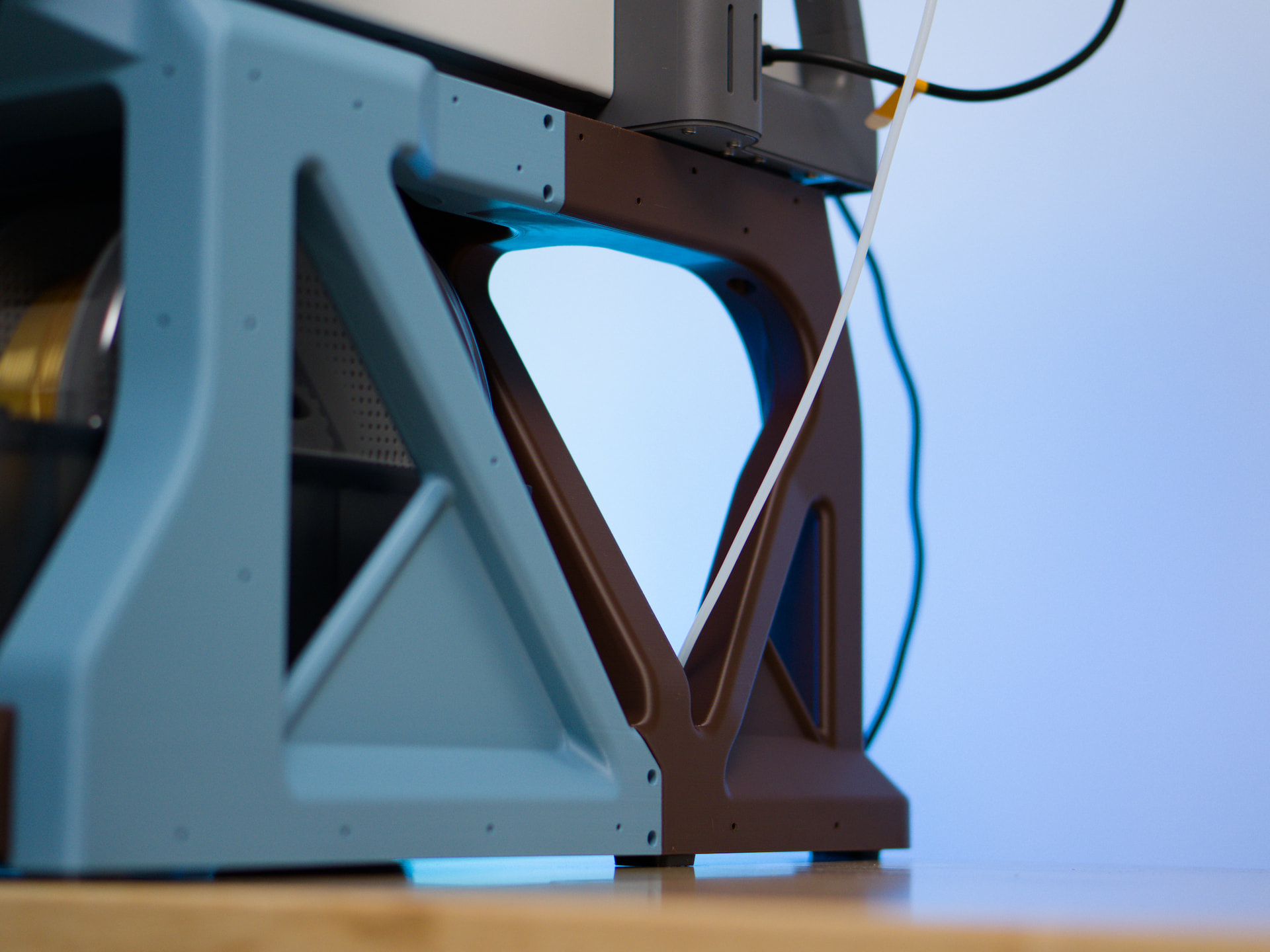

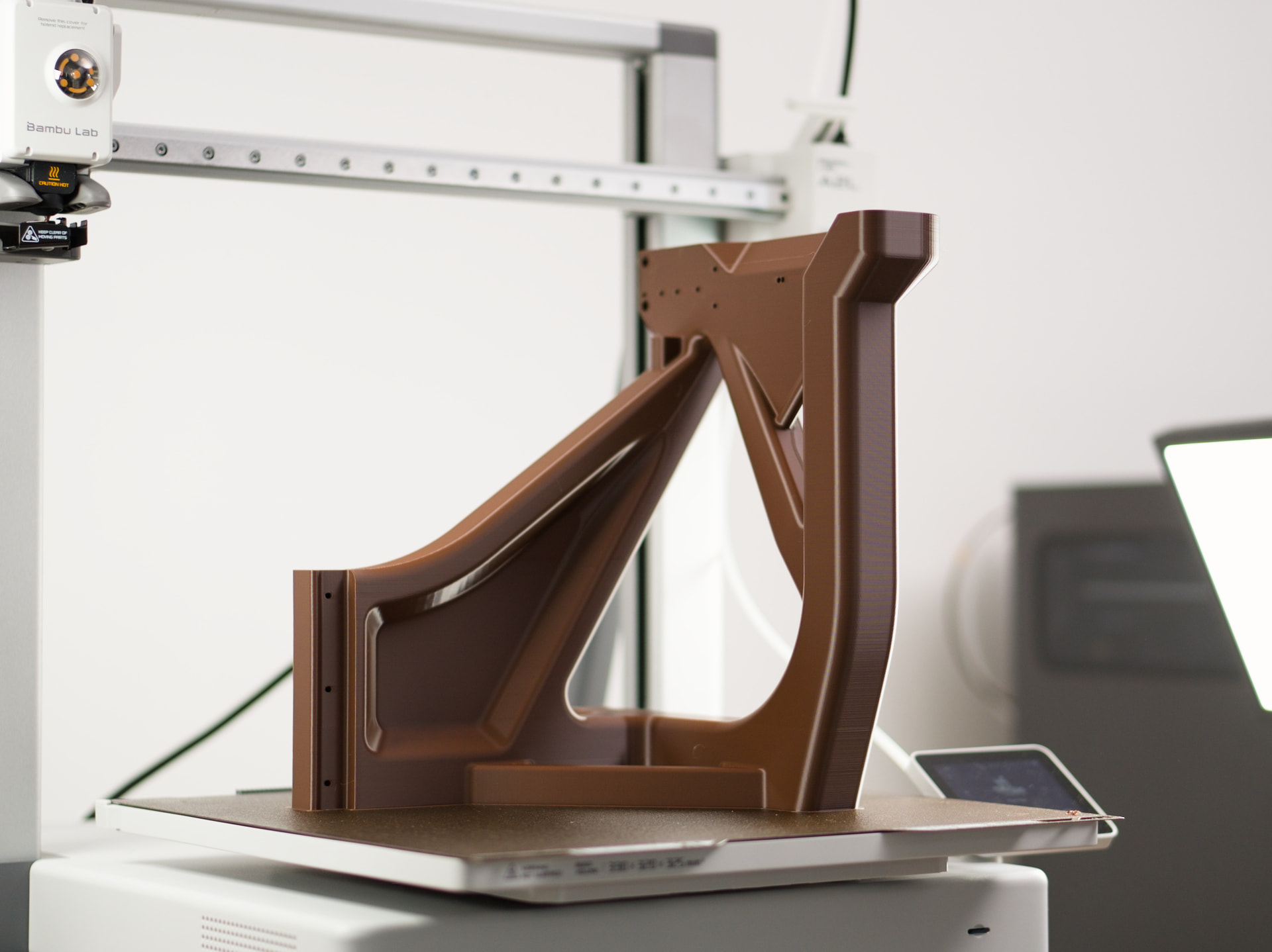

I’m another 2kg into it, and with outer wall set to 70mm/s, the overhang gloss is still more shiny than vertical walls, but it’s pretty close that I wouldn’t notice unless I was looking for it. There was a tiny bit of stringing and blobbing but not more than with dry PLA. Here are more pics. Dark Brown is Bambu PETG Basic and blue is Prusament PETG (Chalky Blue), they seem to perform similarly (in appearance anyways).
