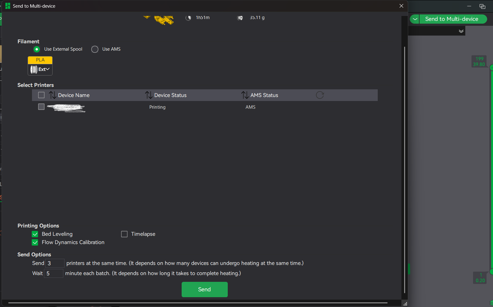

I think this is what the “Multi-device” tab in Bambu Studio was intended to do but sadly it hasn’t reach that point yet. Even sadder is that the H series hasn’t been added to it yet.
Eh? I have my H2C added in the Multi-device tab.

Do you have any X/A series printers showing as well on your Multi-device tab?
I have the same issue as this user (BS 2.4.0.70)
Reference thread.
So interesting update, I added a fresh H2S to the work fleet and it showed up in the Multi-device tab today. The H2D at work hasn’t ever listed. Perhaps the problem is fixed? Maybe I’ll try re adding the H2D. Thanks for the heads up.
Guessing they probably fixed it in a recent update.
I have an X1C, A1 Mini, and H2C
I apparently spoke too soon. In an apparent ironic twist, my H2C dropped off my list while I was typing this out and won’t even show up to be added again.
So now I’m apparently part of the problem club :sweat_smile:

I mean the Multi-Device tab is one of the options available to manage Bambu device prints, which is what you are looking for. Having a discussion on whether it’d work for your H2 series printer or not seems like something you’d want to know? If having relevant discussion to help you find a solution makes you sad, you must be sad often my friend.
Since you want to know about Bambu Farm Manager, you can read about it here: Bambu Farm Manager Quick Start Guide | Bambu Lab Wiki
It’s a client and server solution for managing multiple printers on a farm. The server is not something you’ll want to run on the same PC you use Bambu Studio, you’ll apparently have port conflicts. I don’t think many users are going to want to set up a separate server just to do this, so you may not get the discussion you are hoping for. Though I may set it up at some point since I have the infrastructure at home to do it and it’s probably a way better option than the poorly executed Multi-Device tab.
Alternatively users can make use of this option in studio
Multi-device Management | Bambu Lab Wiki
