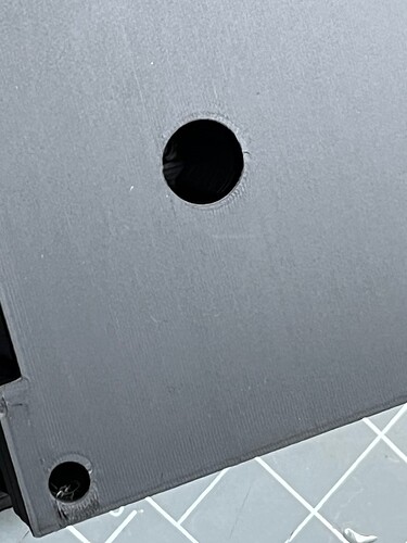

Thank you, you did not need to use this big a sample :slight_smile: You think it’s good? I think it’s awful compared to what I get from my P1S. It’s even worse when you had some thickness to the part and more importantly holes in it.
I think the issues apart from ironing settings are the aux fan which is blowing too much and especially the top panel fresh air entry for the exhaust fan which is giving awful results on ironing. I performed some testings setting aux fan to 50% and exhaust fan off right after printing starts and results are better (still bad but improved).
Here is what I get on P1S vs. the best I can get on H2D (P1S is all default except 30% flow rate).

That second one does look horrible. It also looks like massive underextrusion on the layer before it. Its laying down a bed of strings, instead of smooth sheets. I’ll throw the same filament in my x1c and run it for comparison. Mine look good in person and are buttery smooth but there are lighter and darker areas. This is normal for me. I usually go the route of doing hilbert curve top surfaces, if im going for beauty over smoothness.

Top is x1c, bottom is h2d, left are non ironed and right are ironed. H2d’s PA is off a bit.
Is that just lighting, or does the X1C seem more uniform?
In person, the non ironed x1c (top left) print looks better than the non ironed (bottom left) h2d print at the edges. The PA is off on the h2d. The center of non ironed h2d print looks drastically better though.
For the ironed side, the h2d (Bottom right)looks all around better than the x1c (top right). If you zoom in on the ironed sides, the h2d is more consistant. The x1c has parts that are over extruded and some parts that are under extruded. The h2d could be better with slightly more flow, but this is the standard profile setup on both.
