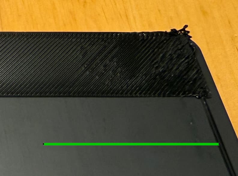

Having an X1 Carbon with 670 hours print time. Recently I have seen problems with under extrusion in the innermost area of the print bed and along the right side.
I haven’t seen it before, although I rarely print in that area. But I needed to print something that makes use of the entire build plate.
I immediately thought: print bed, so I did a manual bed tramming. Then did a new flow and flow dynamics calibration, but it didn’t help.
The filament is Bambu black basic PLA (through the AMS) and using Bambu’s own settings. 0.4 nozzle. The machine is completely stock.
I tried both the cool plate and the textured PEI plate with very similar results. Tried both Bambu Studio and Orca slicer with no difference between them.
I’m not sure how to proceed as the rest of the print looks fine. It’s only the innermost area that looks bad, but it causes bad warping in the print a few layers later.
Any ideas are most welcome.

  1. Does this sort of rippling occur in the same location on the build each time?
  2. How thick is the test sample, are we looking at a 0.20mm first layer test?
  3. Does it happen with all filament types?
  4. Have you tried testing without the AMS and used a direct feed? Does the result vary at all when you do this?
If at all possible, is your camera capable of doing a macro closeup of the ripples? If so can you post both a regular photo and a macro closeup of the same area?
  1. Yes, always the same place on the plate
  2. 0.2mm, first layer test. I printed a real part this morning, that showed bad warping in the same area.
  3. I have only tried PLA and PETG, as it was what I have at home for the moment.
  4. No, I havent tried this yet. I assumed (probably incorrectly) that since the under extrusion doesnt happen everywhere, it probably isn’t the AMS. But increased friction in the AMS could of course create problems anyway. I guess, when the print head is in the innermost areas of the printer, the resistance in the filament path is at it’s highest (bent tubes, etc.). I will try that too.

Thank you for providing close-up photos and answering questions; this detail is very helpful.
There are two possible culprits here and this is what I might suggest as a troubleshooting tests to see which one is more likely the case:
Possible Cause 1: Filament Calibration
To start, I normally don’t trust the factory settings, you may what to check filament calibration. Since under-extrusion occurs at the end of nozzle strokes, it could point to a calibration issue, which is usually easier to troubleshoot. Also note that since you’re system has 700 hours on it, if you are relying on auto calibration, you may want to clean the lidar or disable it to see if it affects the test model. While you’re at it, check to see if there’s accumulation of filament under the silicone sock. Sometimes this can interfere with temp sensors.
Troubleshooting Step 1
It might be simpler to first rule out a second possible cause, which may align with your suspicions. Try using the slicer’s cut tool to isolate the problematic section of the model. This will let you see if under-extrusion persists with the model section when printing a smaller area. If it does, a mechanical issue becomes more likely.
Possible Cause 2: Mechanical Issues
An easy test here is to switch the first layer’s flow pattern to circular. By using a circular pattern instead of linear, you’ll observe if under-extrusion occurs at the same points. Consistent issues with a circular pattern suggest a mechanical problem.
If you’re unfamiliar with changing the flow pattern, here’s how: In your slicer settings, set the top layers to 0 and bottom layers to 1 for the concentric pattern to take effect. In the example shown, I’m using a 50mm square on the first layer to make nozzle stroke changes more visible.

The order became a different one. I tried your suggestions first:
The cut version showed no clear improvement.
The result of the concentric pattern test was interesting though. Although the result isn’t perfect, the improvement is huge. The far right corner still shows small issues, but everything else looks fine.
The pattern looks a bit funny though… I hadn’t expected to see what looks like seams in so many places.

Those are very interesting results; however, I don’t think they give us enough data to draw a conclusion. When I mentioned cutting out a section, I meant to include part of the model that was smooth as well. Sorry if I wasn’t clear. Here’s what I meant:
Expanding the section to include both the clear and distorted areas helps determine if this issue is mechanical. Look for size changes in the distortion, did it get bigger or smaller? If there’s no change in size and the areas with good and poor flow are the same in both dimensions and location, that’s more conclusive. If the extrusion problems recur in the exact same location, this likely rules out the nozzle running out of molten filament due to travel distance and points us back to mechanical issues.
Another point—the circular test here doesn’t show the full travel pattern. Sticking to a symmetrical model print in circular pattern, like before, may yield better insights. This missing notch makes the test ambiguous and loses its value as a test.

I understand. I have done those tests again, but the results are not entirely conclusive.
  1. New print containing both the “bad” area in the corner, but also an area that was good.
  1. New print without the cutout in the corner. Maybe still not good enough as the print is rectangular due to the unprintable area in the ourer left corner of the build plate.
The interesting thing now, is that both prints look completely fine. I can’t understand why…
Only the tiniest signs of scraping, but that’s kind of normal.
The temperature looks fine @35 degC. There is only a difference of 0.2-0.3 degC over the whole build plate. @55 degC I see about 2 degC lower temp in the corners. @90 degC it doesn’t look good, with 10-20 degrees lower temp in the corners and half of that along the sides. That would likely be a problem if printing ABS or nylon, but for PLA it shouldn’t be of any concern I guess.

I just printed the full first layer rectangle again (linear pattern) and the problem is back. The right corner looks ok, but more or less the whole inner side is of poor quality.

The extruder gear is fine. It looks like new. No visible wear at all.
The images don’t do it justice.
Replaced the hotend with a new one while I was at it.
No luck unfortunately. I have done all the maintenance, cleaned the extruder, replaced the hotend. The result is better, but not good. It looks fine everywhere except in the right corner.
I am considering to feed the filament directly into the extruder, skipping the ptfe tube, to see if that helps. The tube is at its most bent state in the right inner corner.
Apart from that, I have no more clue on what to test. I do think this is mechanical.
