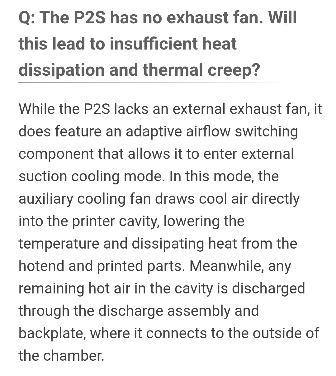

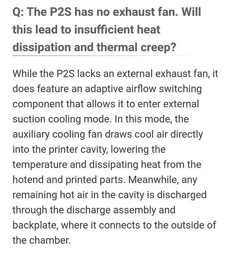

Here’s a detailed explanation of everything related to fans, cooling, etc.
But in your case, it doesn’t make sense to turn off the fan: If your room is for example 35°C, then the chamber is also that temperature before you turn on the printer. The printer adapts to the room temperature. You’ve made a huge logical mistake there. That’s such a huge logical fallacy that I don’t know how to explain it.
Whether you turn on the fan or not, it can never get any cooler than room temperature!

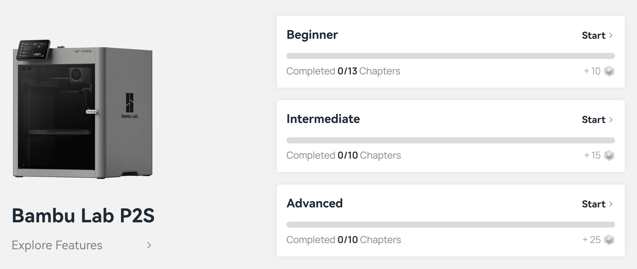

Yeah, of course not - it’s just physics. I’d really recommend taking a break and checking out Bambu Academy - it explains a lot about the topic. :grin: :+1:

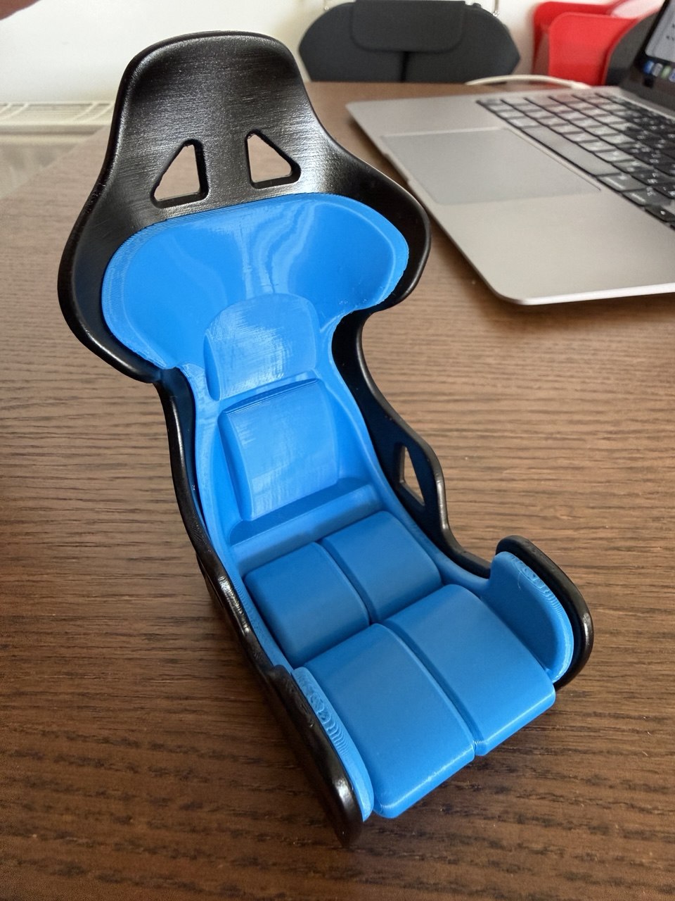

I’ve printed one miniature with PLA and one somewhat more complex shape (besides simple parts) with PETG and happy with how both turned out. PETG has been extremely simple to use so far, just load the model and click “print”.
The figurine below is about 5 cm high, printed with PLA, 0.4 nozzle 0.08 layer height.
The “chair” is PETG, black part is moderately sanded, primed and painted (as the plastic used to be of different color), the blue part had no surface post-processing whatsoever.
