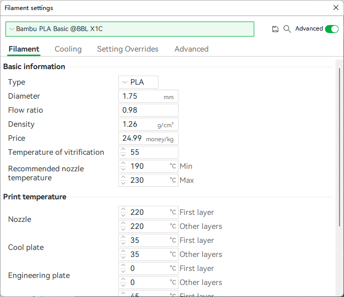

As far as the “it just works” (with BL filament) the BL printers and filaments and the RFID code on the AMS are intertwined and that runnability is the reason. It reads the RFID and every single possible setting is loaded into the printer and that is important to understand when using other brand filaments. Lots of people use other brands of filament but there is a fundamental difference you have to be aware of and test to find the sweet spot.
Non-BL filament is sort of “Jack of all trades” filament meant to run on all different brands and types of printers.
Aftermarket filaments you will see bed temperature and it will have a range, not a value. These will be random numbers as I do not have all the settings memorized
Aftermarket pla spool will have a label with a nozzle temperature RANGE of +/- 10°C and a similar range for the bed that it is dependent on you to validate. Spool says 200+/- 10° means you have to figure out if it is 190° or 195°, or 205° then you have to save those settings. For example it might be Elagoo .4mm nozzle PLA Profile" and click save.
BL filament in Bambu printer they have aleady done that for you and it is built into the default profiles. You set the nozzle diameter, RFID gets read and says " Okay, let me take every single setting is plugged in.

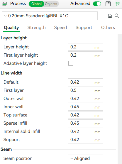

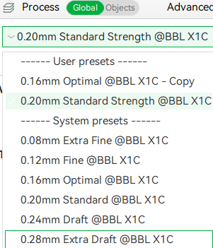

The nozzle size is set locally and then you choose .2 standard strength as in the first picture. All the setting in the bottom picture set by Studio. You see “System presets” and “User presets” in this fist picture? System presets represents what the engineers have already decided are the best settings and those are PRESET by the system (Studio). THAT is why “It just works”
You decide to use Protpasta filament, which is absolutely your choice, it is on you to validate every setting. Find all the ideal settings in your Protopasta PLA you have to save it in User presets. Maybe “Protopasta .2mm nozzle optimised” finds a home in User presets. Sinse no RFID each time you stick Protopasta PLA in the AMS so it relies on that User preset to be there.
