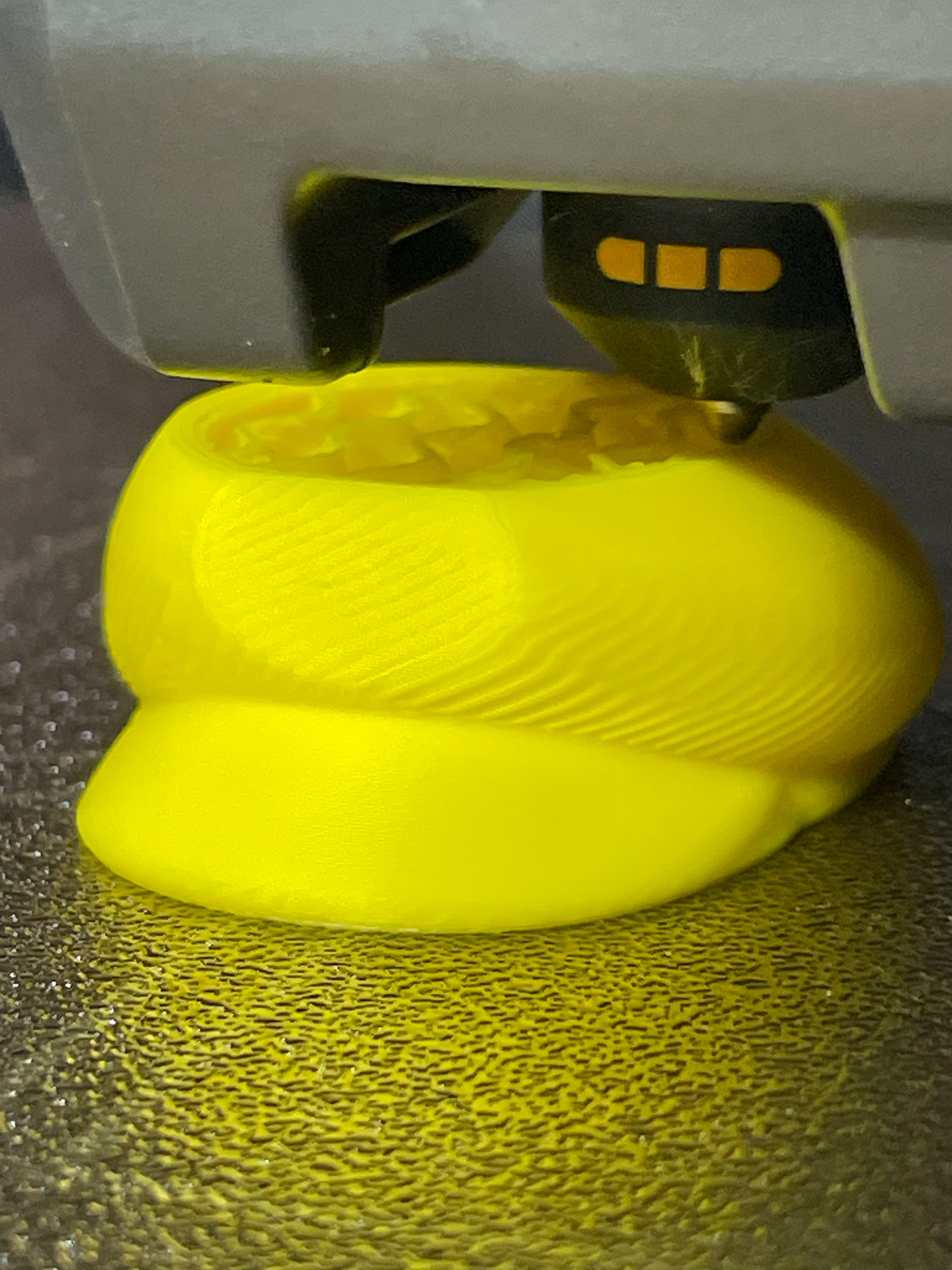

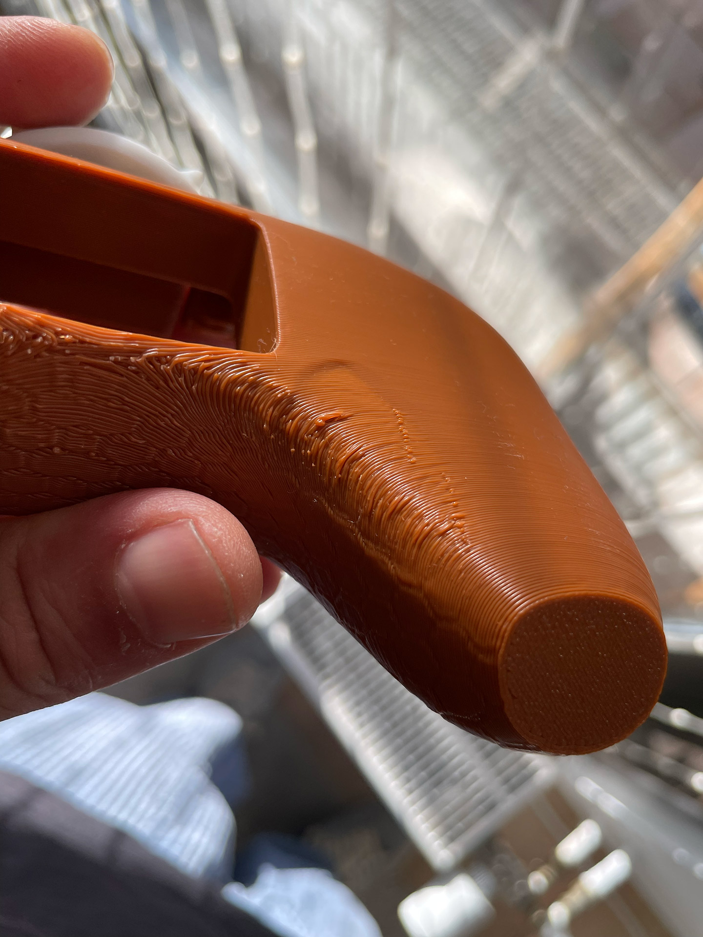

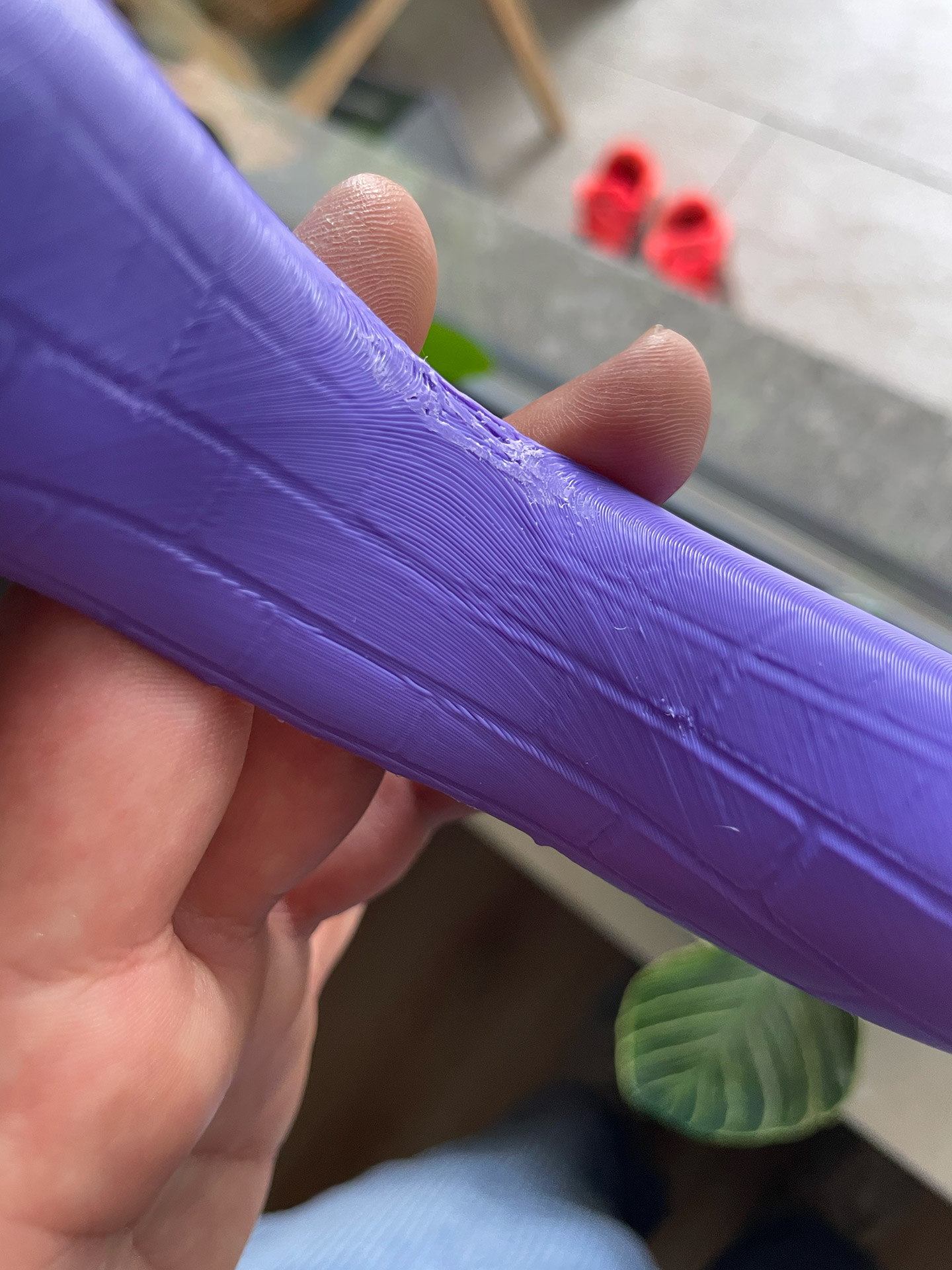

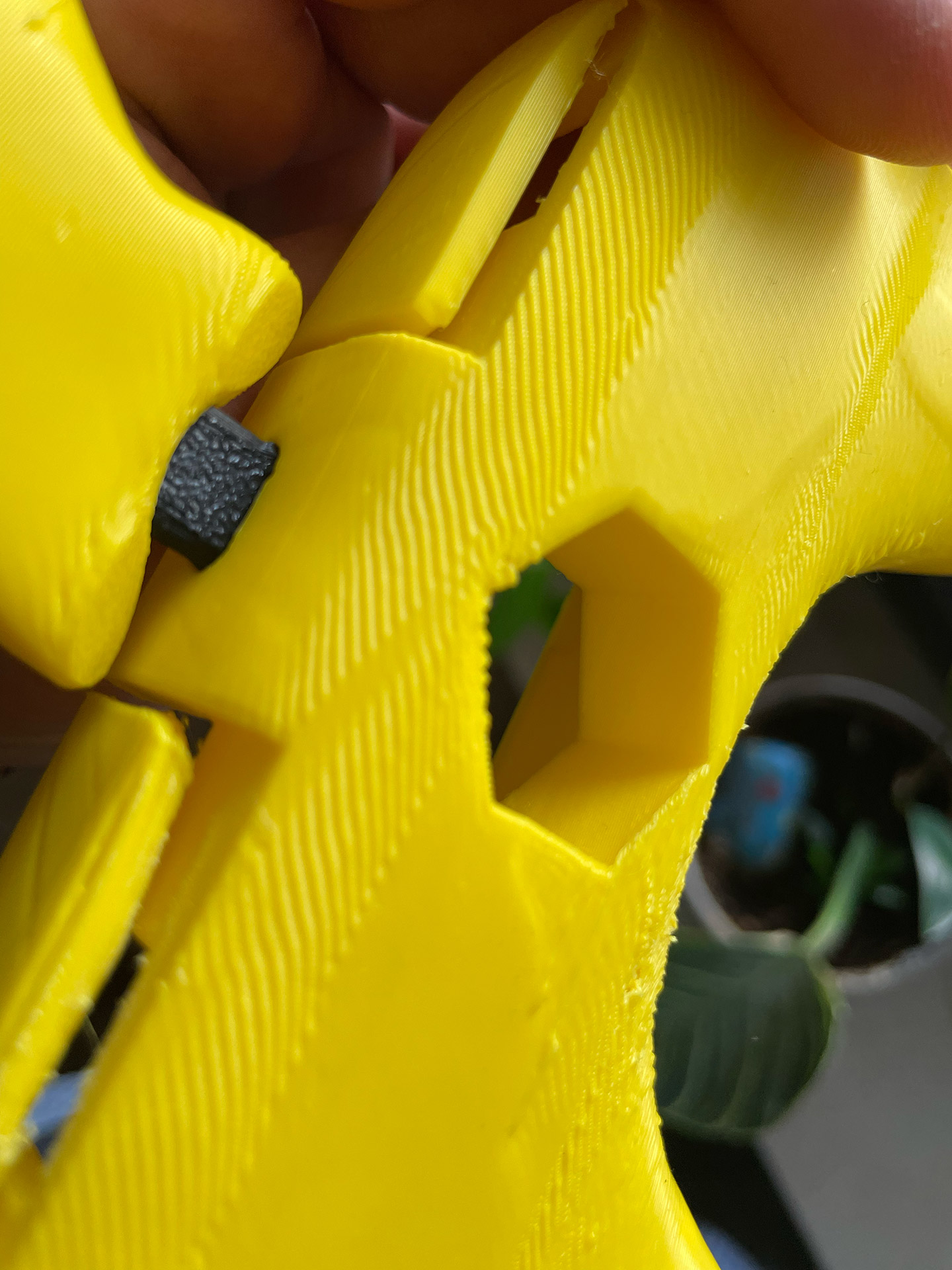

First attempts with PLA+ when the aux fan was forced to heat mode because “softening temeprature” in filament settings was set to a value above 50. No deflector on the fan at that time. Chamber was about 45 degrees. Printer completely closed (Door and Lid).

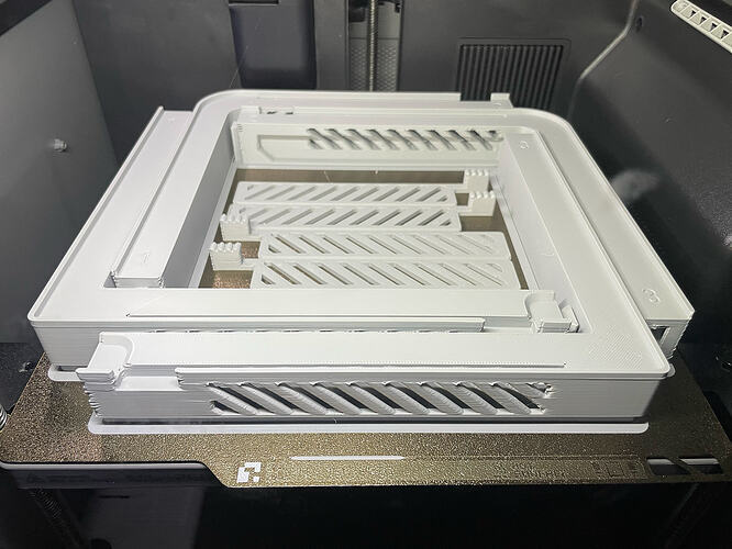

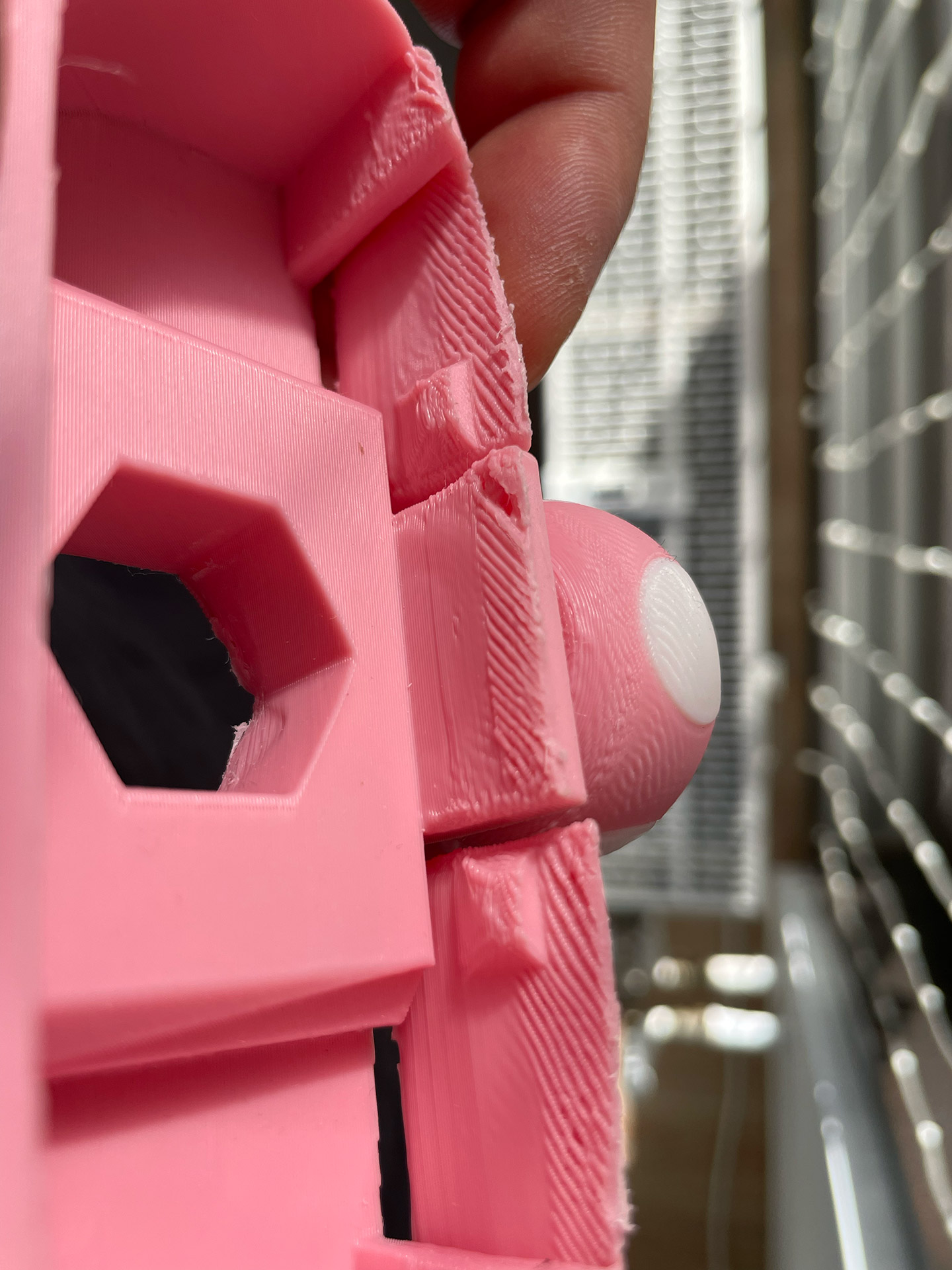

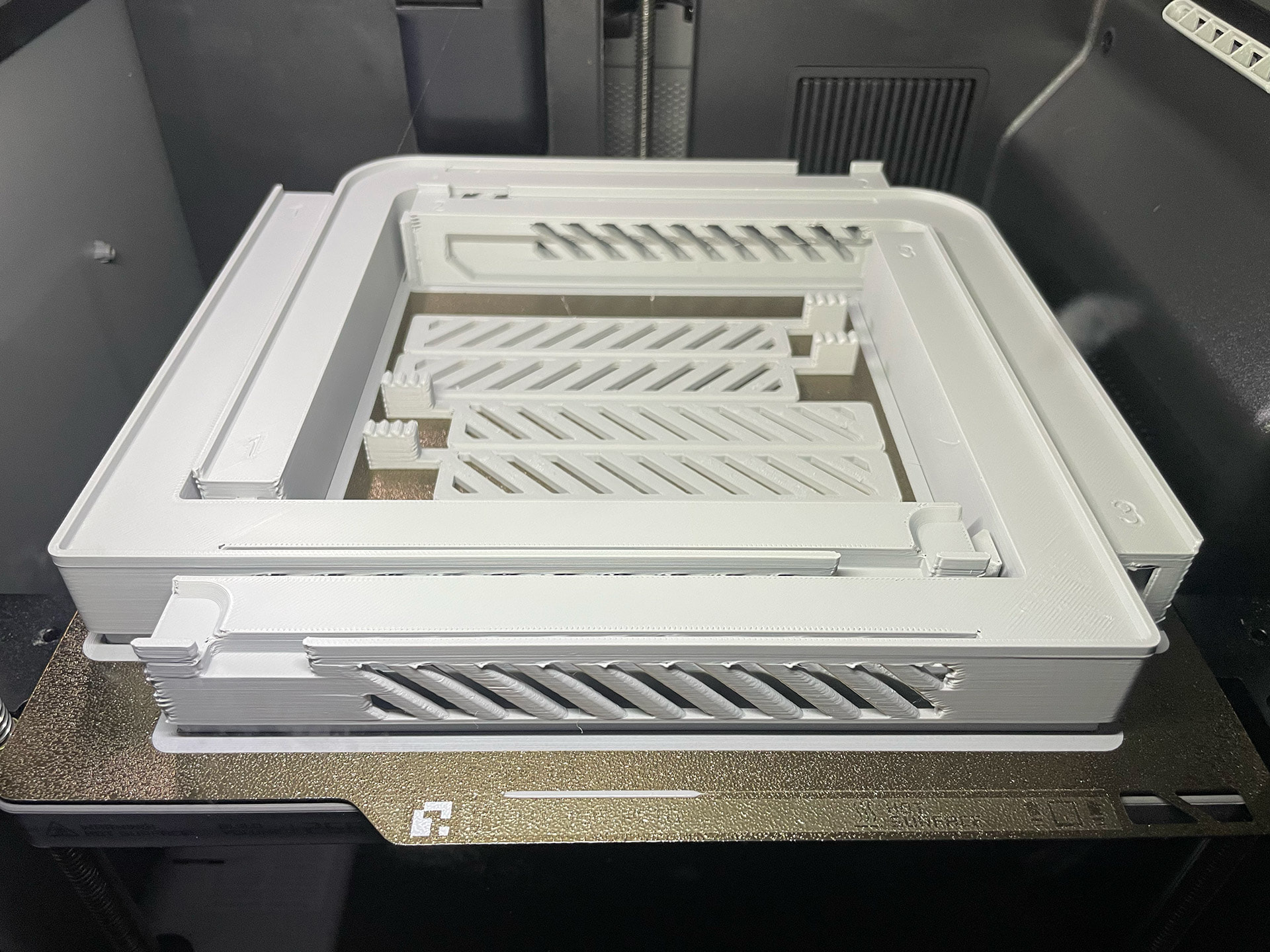

I was printing a riser with ventilation because I thought that would solve thermal problems.

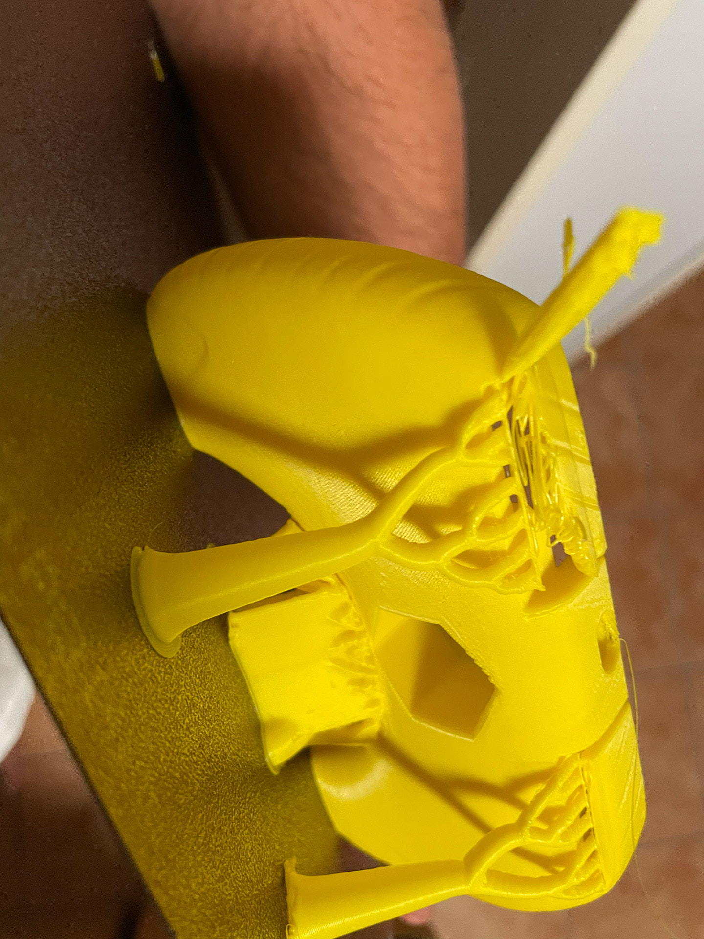

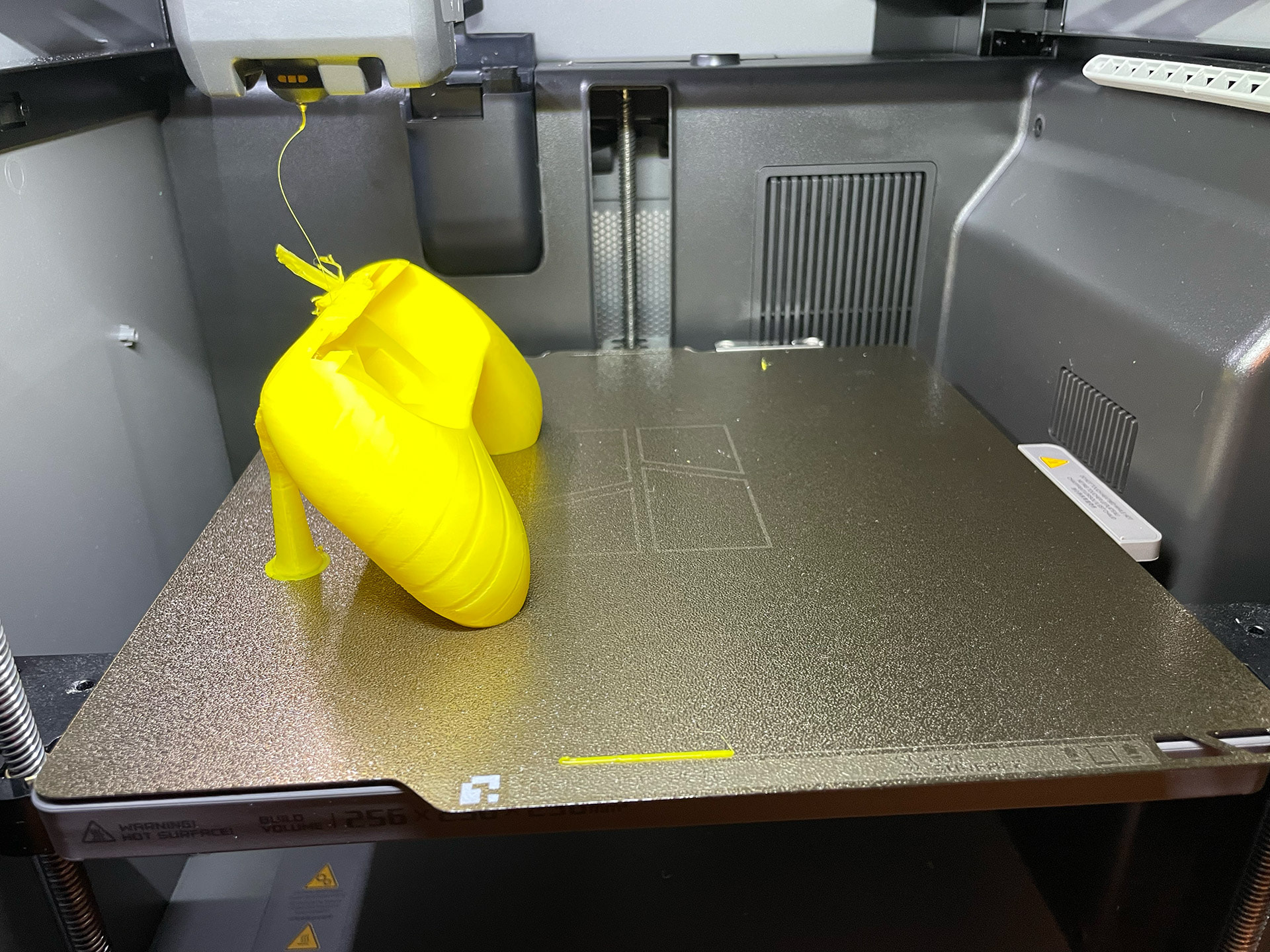

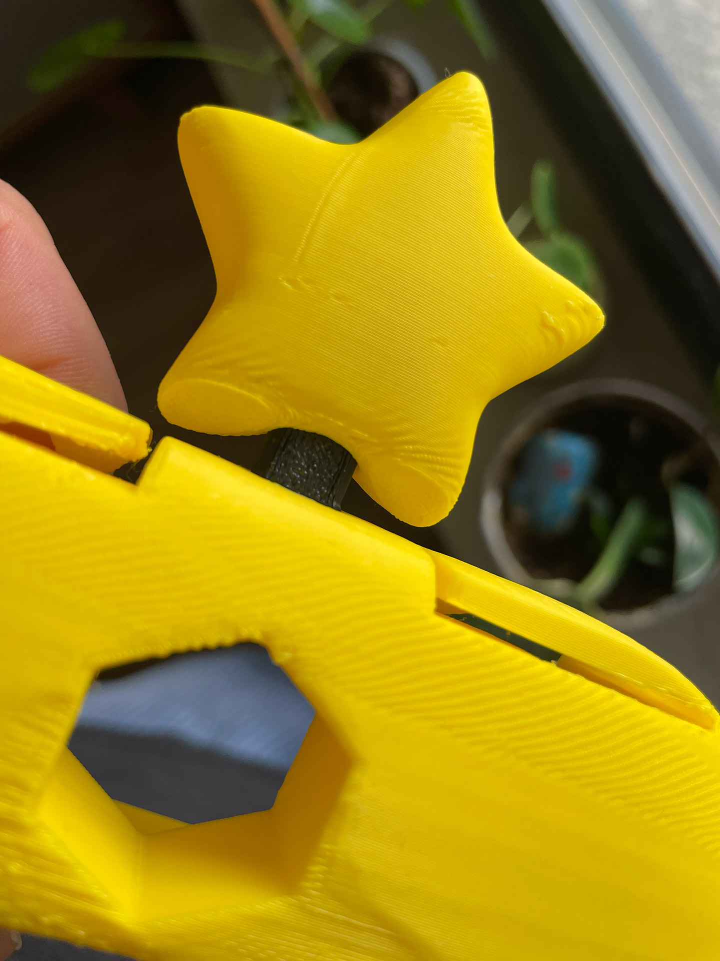

PETG-HF from bambulab. With standard filament settings aux fan was forced into head mode
(wether this is a bug or a feature is open to your personal preference).

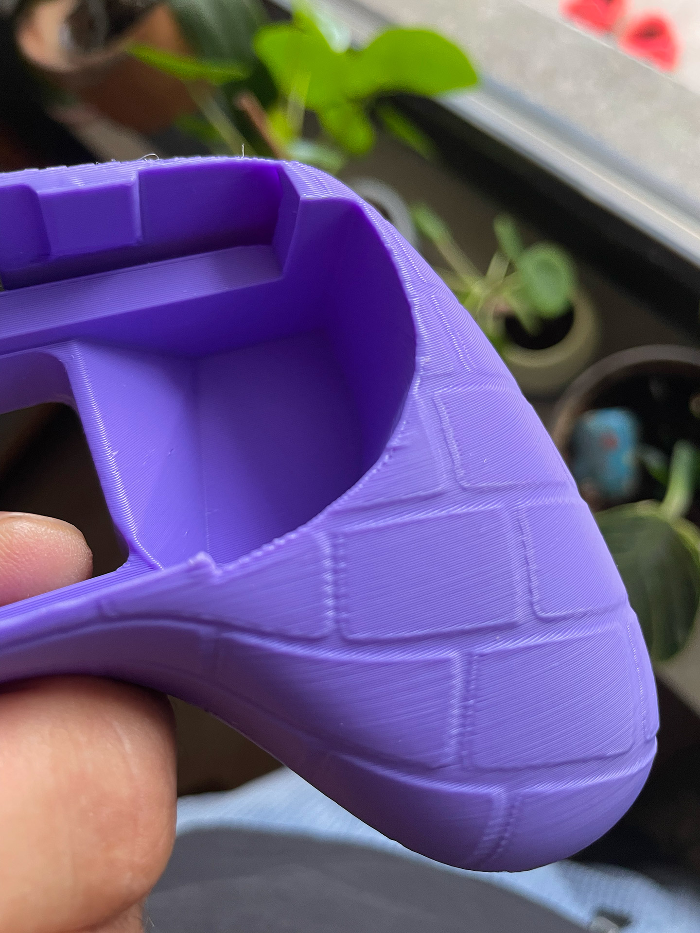

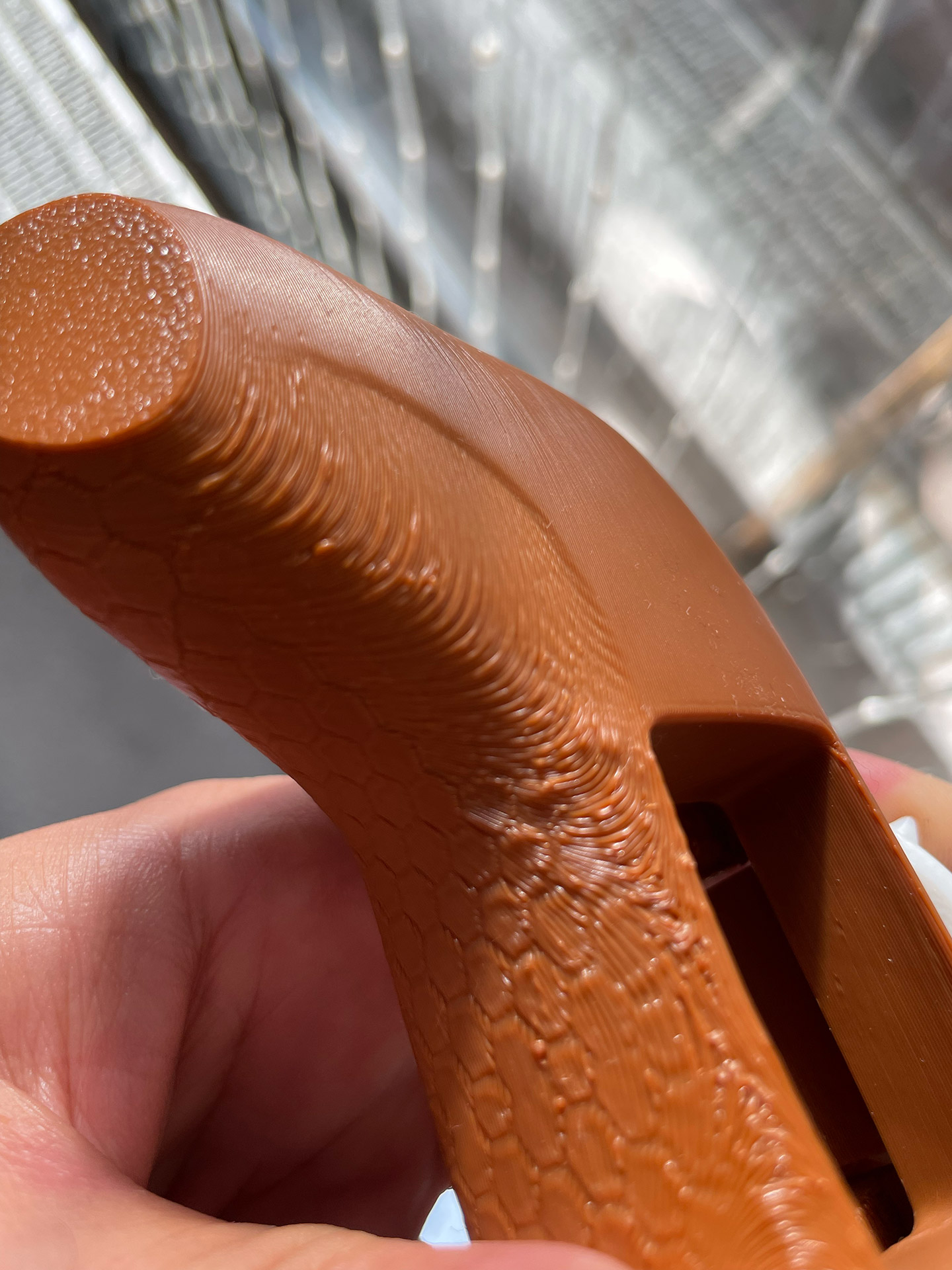

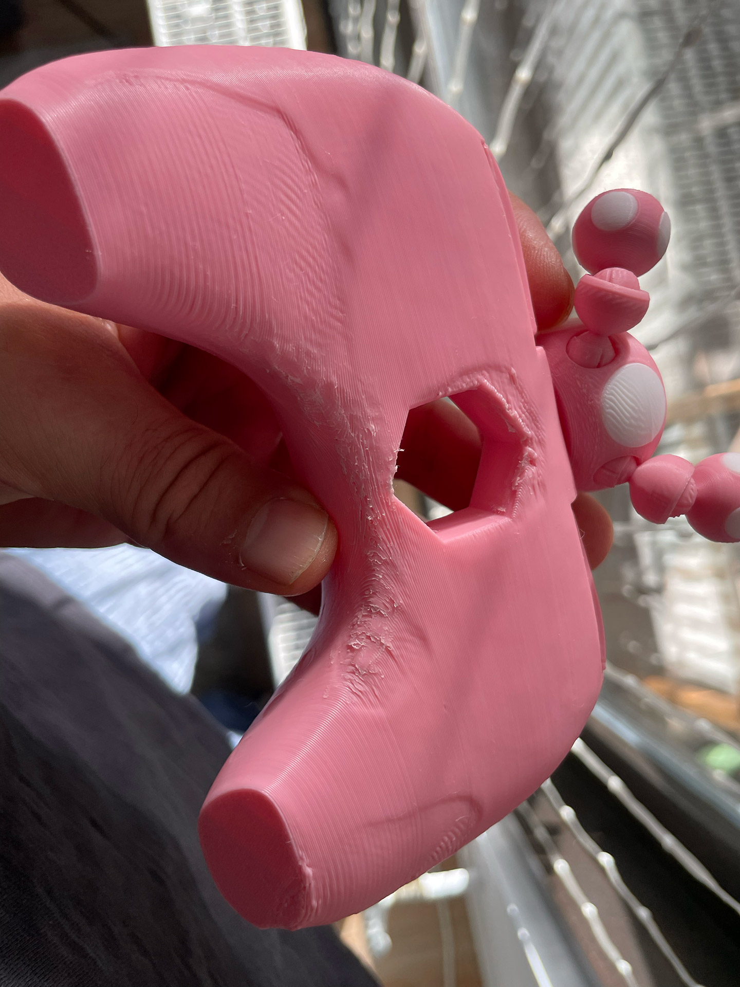

My latest print. It seems that ringing artifacts have gone (I retensioned the belts). Heat chamber issues are no longer my main concern (aux fan running on 90% with a chamber temp of constant 36° to 37° while door is closed and riser ventilation is open)

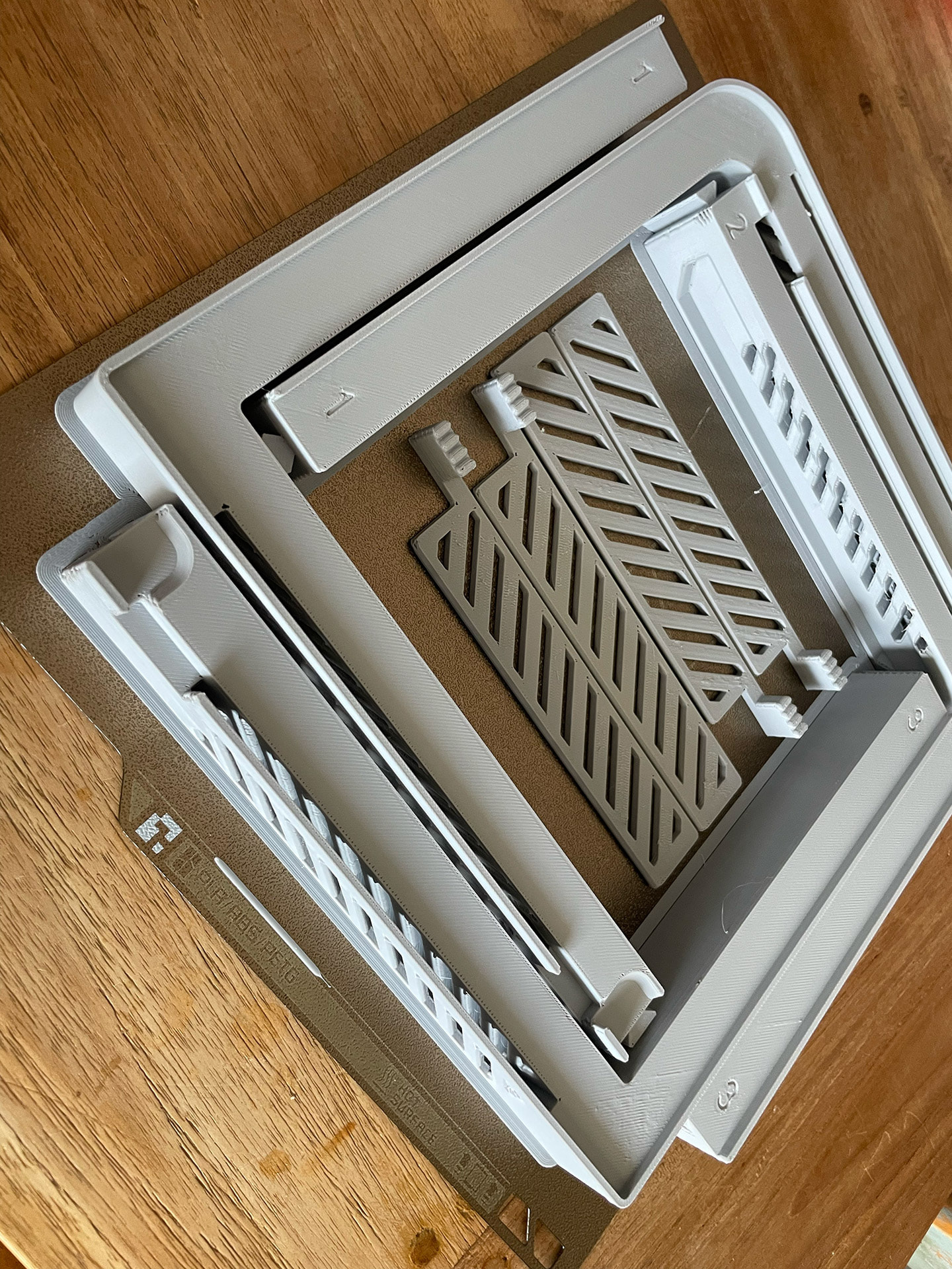

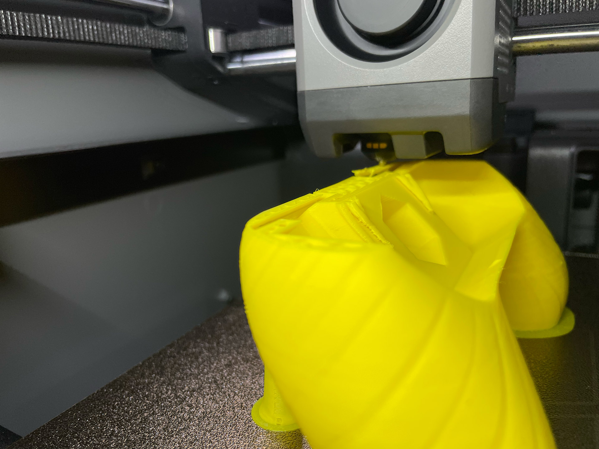

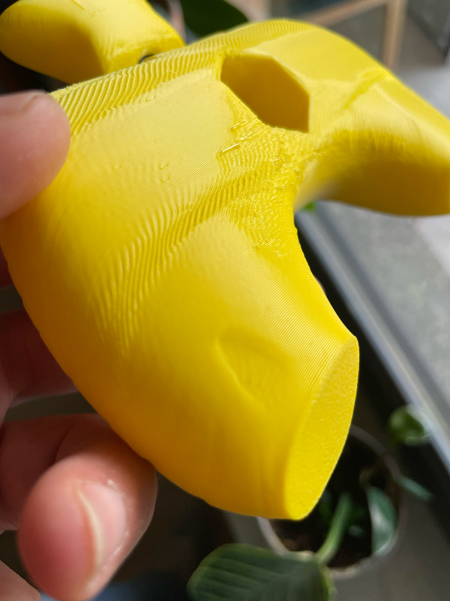

This was the first print, I had neither rinigng, warping, melting artifacts,

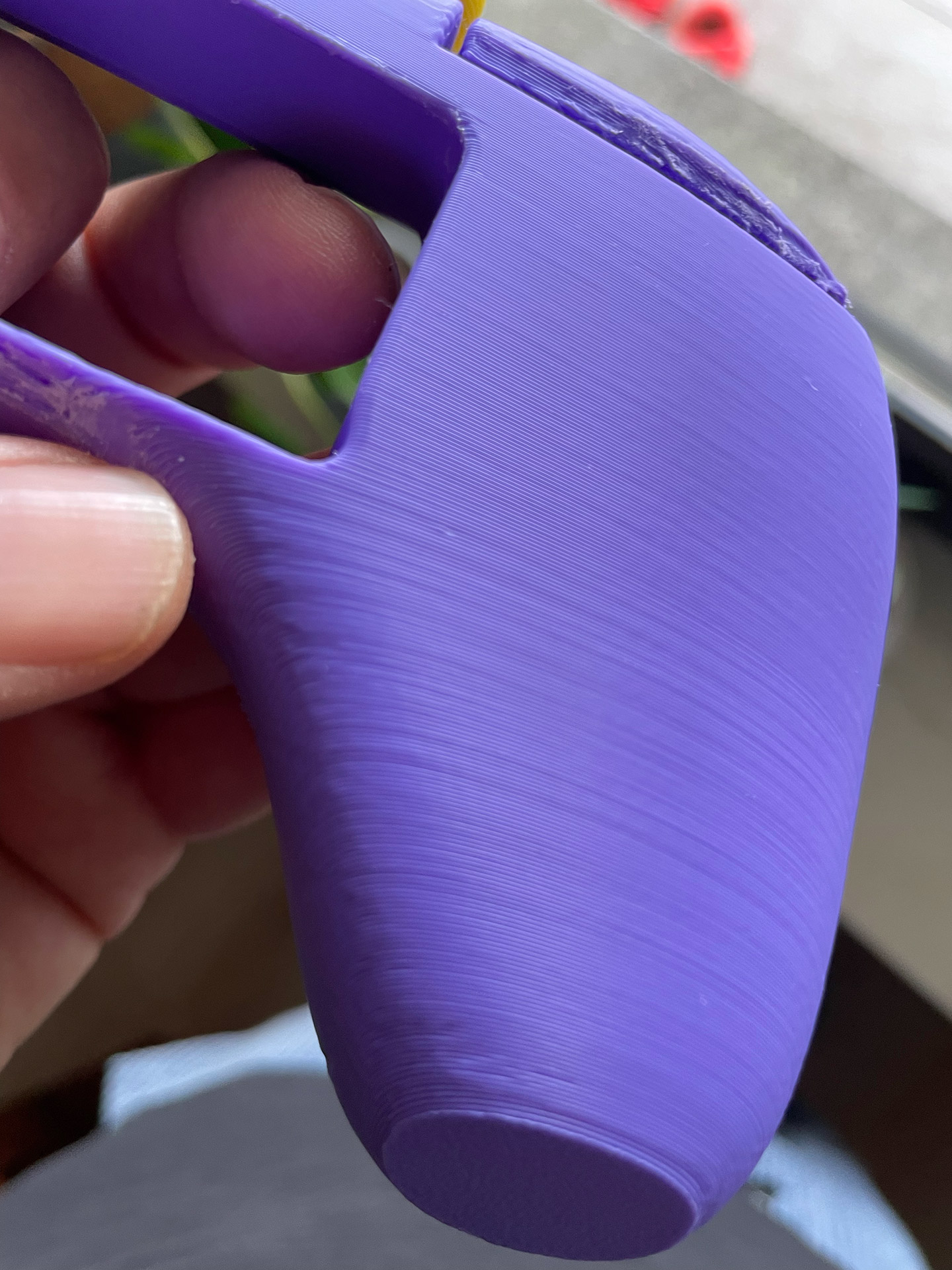

Surface quality is another story. Propably a settings thing.
(last quarter of the model was printed with 50% speed)
