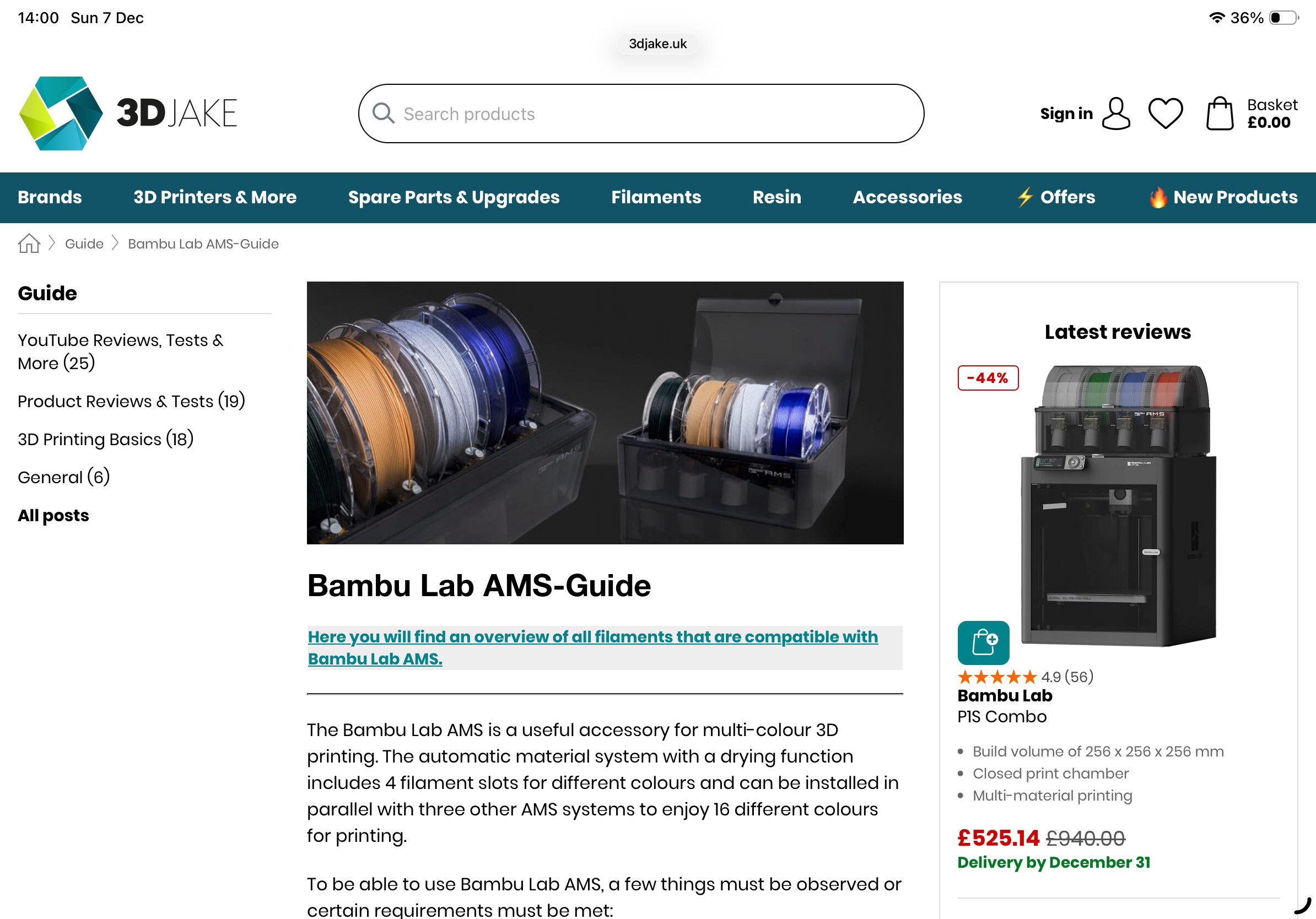

Can anyone tell me if, for example, 3DJAKE filament rolls can be used with AMS 2 PRO? Of course, RFID does not work with them, but can these filaments be used for multicolor printing through AMS2 PRO?
Don’t know about 3DJAKE, but I’ve used Polymaker (cardboard spools), BASF Ultrafuse (plastic spools) and cheap SMART Filament PLA (plastic spools) and they all work well in the AMS 2 Pro. I’ve done some 4-colour prints, with mixed brands, including Bambu Lab, and the only thing different is that the Bambu spools give an indication of how much filament is left on the spools. So multicolour printing with mixed brands (of the same material) is no problem.

3DJake have a list on their website of all the filament rolls that are compatible with the AMS. Check it out.
