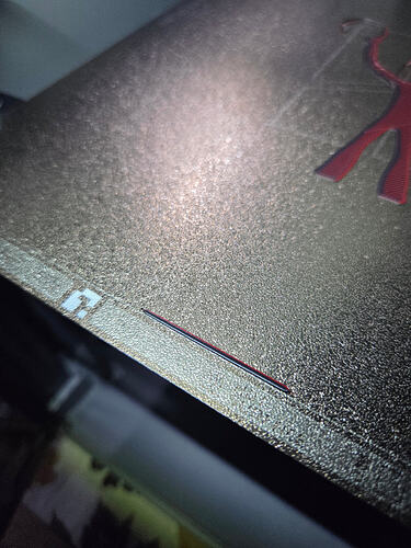

My printer is now having issues printing a first layer for every print. I am attaching a few pictures and a video. This happens with PLA, all manufactures, all colors. This not a filament or color issue, as this happens with any brand, any type and any color. As you can see, the calibration line prints perfectly fine. I have tried the following solutions:

None of these solutions fixed my problems. These issues came out of nowhere. I was printing just fine one day, and the next day, my printer can not print anything at all. My machine gives no errors at all. This issue happens no matter where I initiate the print. The problems happen from the handy app, Bambu Studio, and prints initiated from the machine itself. This also happens on every model I try to print, even the stock benchy.

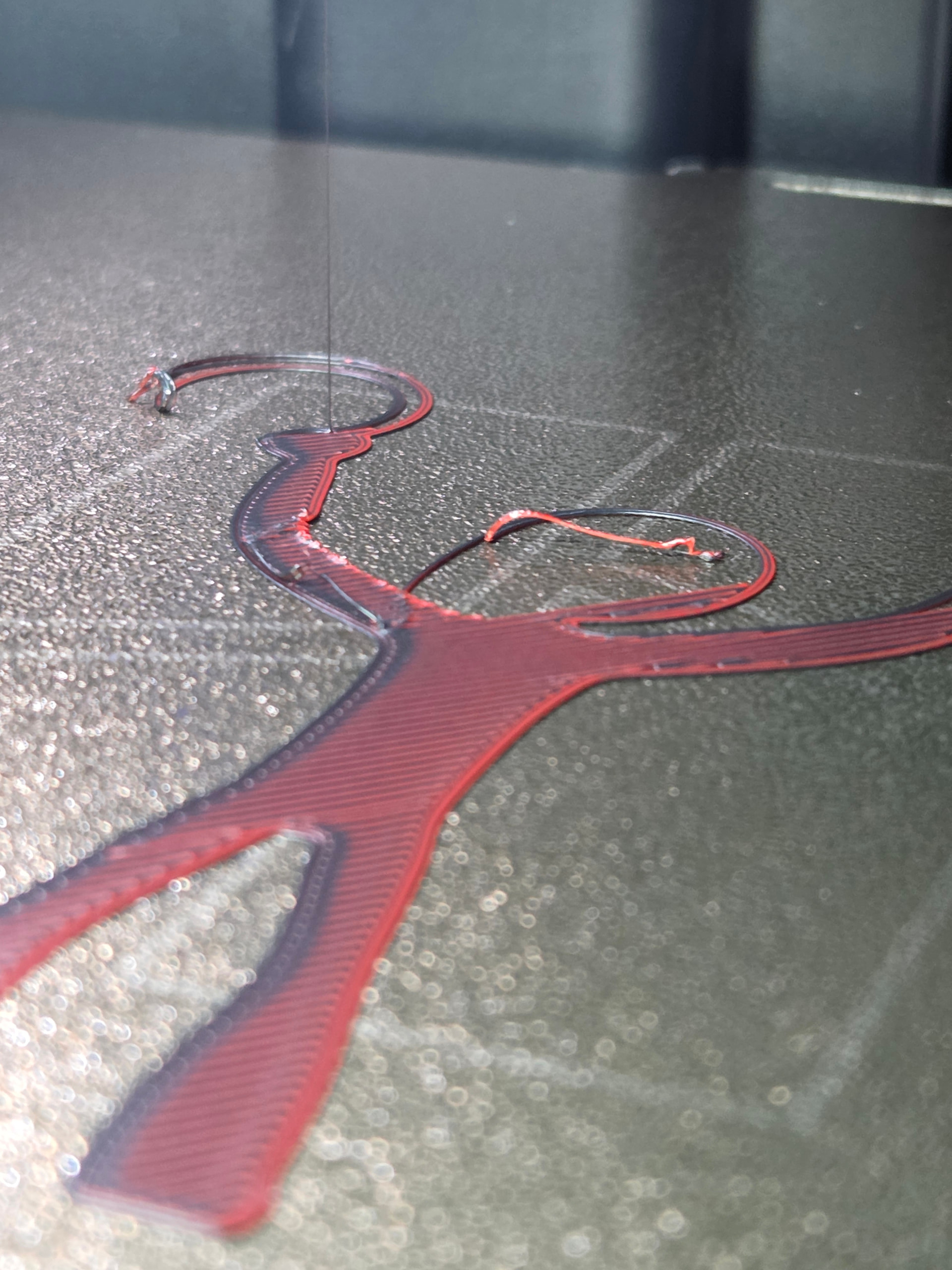

I actually did try to wiggle the nozzle, and I even checked the screws in front AND behind the nozzle. They were all tight, and I still had the failures even after the checking of the screws. Unfortunately, I will not be able to provide a picture of the second layers and beyond, as the nozzle picks up and drags the print around the plate before layer 2 is normally reached.

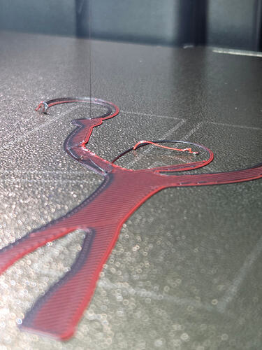

Hard to tell considering your filament is a mix of colors, but it just looks like bed adhesion issues.
pressure advance could cause plowing etc., but if you have a good first layer, it shouldn’t pick it off the bed.
If the build plate is truly clean, I’d raise temps a bit and see if if doesn’t stick better. Add 10 degrees just on first layer (where the issue is obviously happening) on both the nozzle and the plate then retest.
It may have a few strings. It may not. But if it finally sticks to the bed, there’s your sign.
As far as any filament calibration tests, there’s models all over you can download to test / fine tune with.
Edit: Just watched the 1st part of your video. Clearly the filament is not sticking to the bed. Definitely add some heat on the 1st layer and try again.

I am attaching a video of a first layer print with stock temperature settings, and then a video of a first layer print using settings where I increased the bed and nozzle temperatures by 10C. The first layer print failed with the stock settings (bed at 55C and nozzle at 220C), but the print was somewhat successful at the modified temperatures (bed at 65C and nozzle at 230C). The settings can be seen on the screen before the print starts.
https://www.youtube.com/shorts/K-FjrmK9OE4 (Stock settings, failed print)
https://www.youtube.com/shorts/cjjGMdLG5zo (Modified temperatures, somewhat successful)

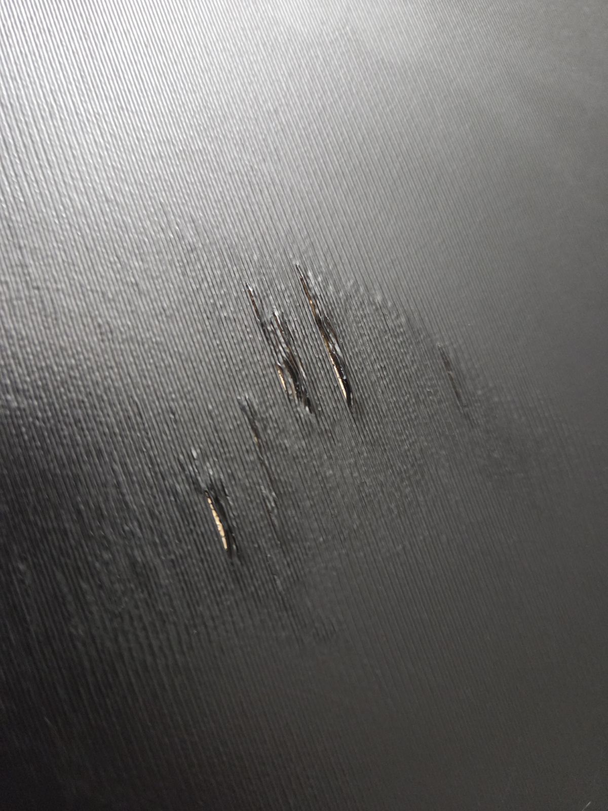

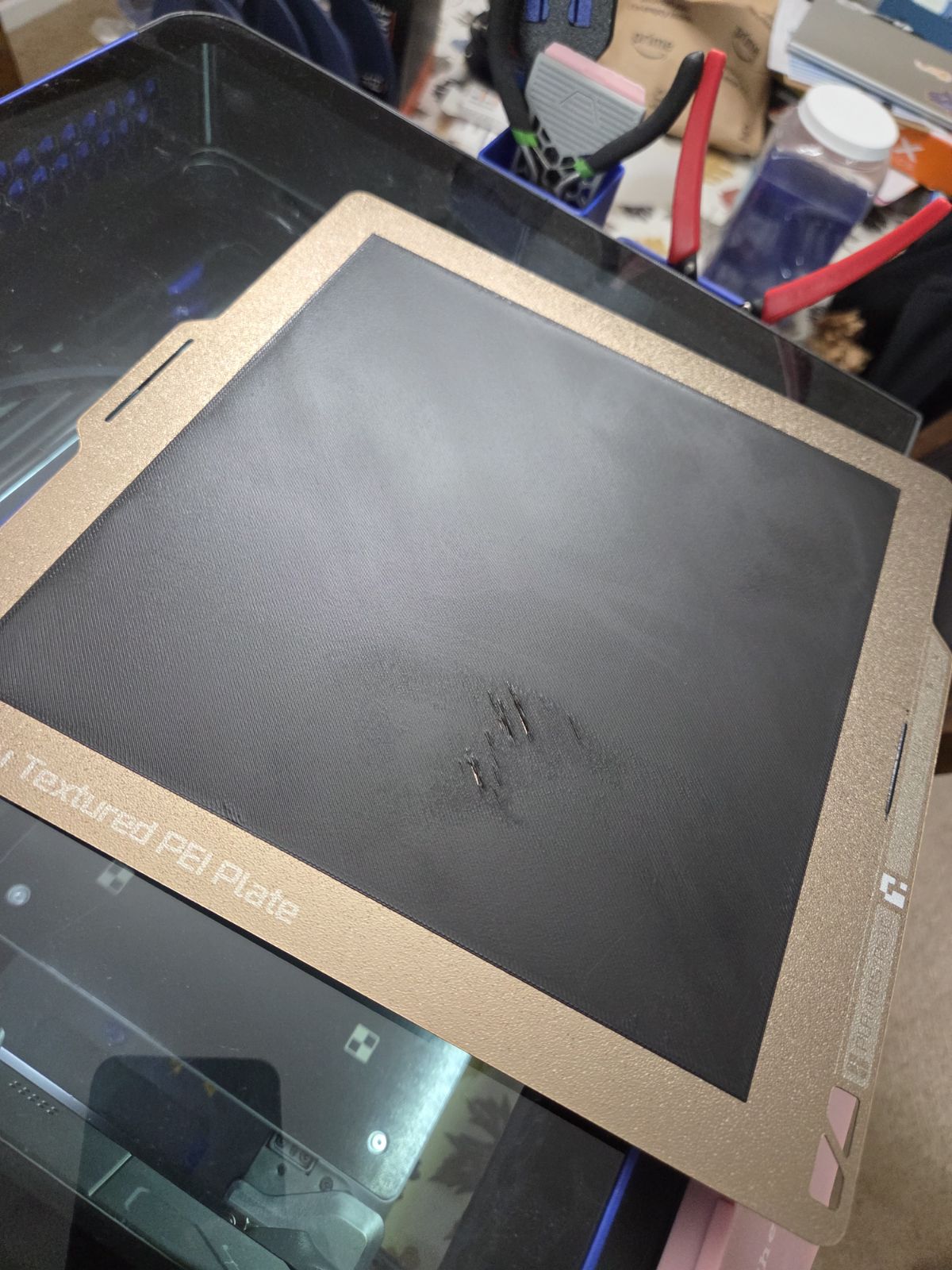

Unfortunately, there is a new problem, please see that attached pictures. There is a spot toward the lower left that looks likes holes or missing filament, not sure what to call it, but its not a smooth print in that area.
  1. What is this new issues, with the bad spot on the print?
  2. Why do I now need to increase the bed and nozzle temperature, when I never had to before?
