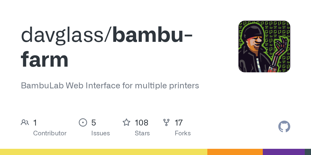

Bambu Farm
A web app that shows you your printers, cameras, print status and AMS details:

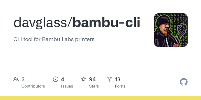

Bambu CLI
A Node.js powered Command Line tool that shows you all sorts of interesting things from your printers. And I have more planned.
Right now it shows:
  • Current Status
  • AMS filament details
  • Lists the files on the device
  • Allows downloads from the device
  • Parses a .3mf file and returns some useful information.
I’ve only got access to my 2 X1C’s so I could use some testers that have 2+ machines as well as other models to make sure that I’m handling all the “edge cases”

I didn’t build the web app to emit those types of topics, but it wouldn’t be hard to add them. The web app has a WebSocket server that emits events from all of the printers bound to it. So, in theory, it wouldn’t be that hard to add a listener to it and do your thing.

The bambu-farm app is 100% local, it doesn’t talk to the cloud at all. The only resources it uses from the internet are standard CSS/JS included files in the webpage itself.
The bambu-cli only talks to the cloud once during login to fetch the machine information from their API and grab their IP addresses from the global mqtt server. From there on, it’s 100% local communication with the printers. So if while in LAN Only Mode those things still work, then it should “just work”.
