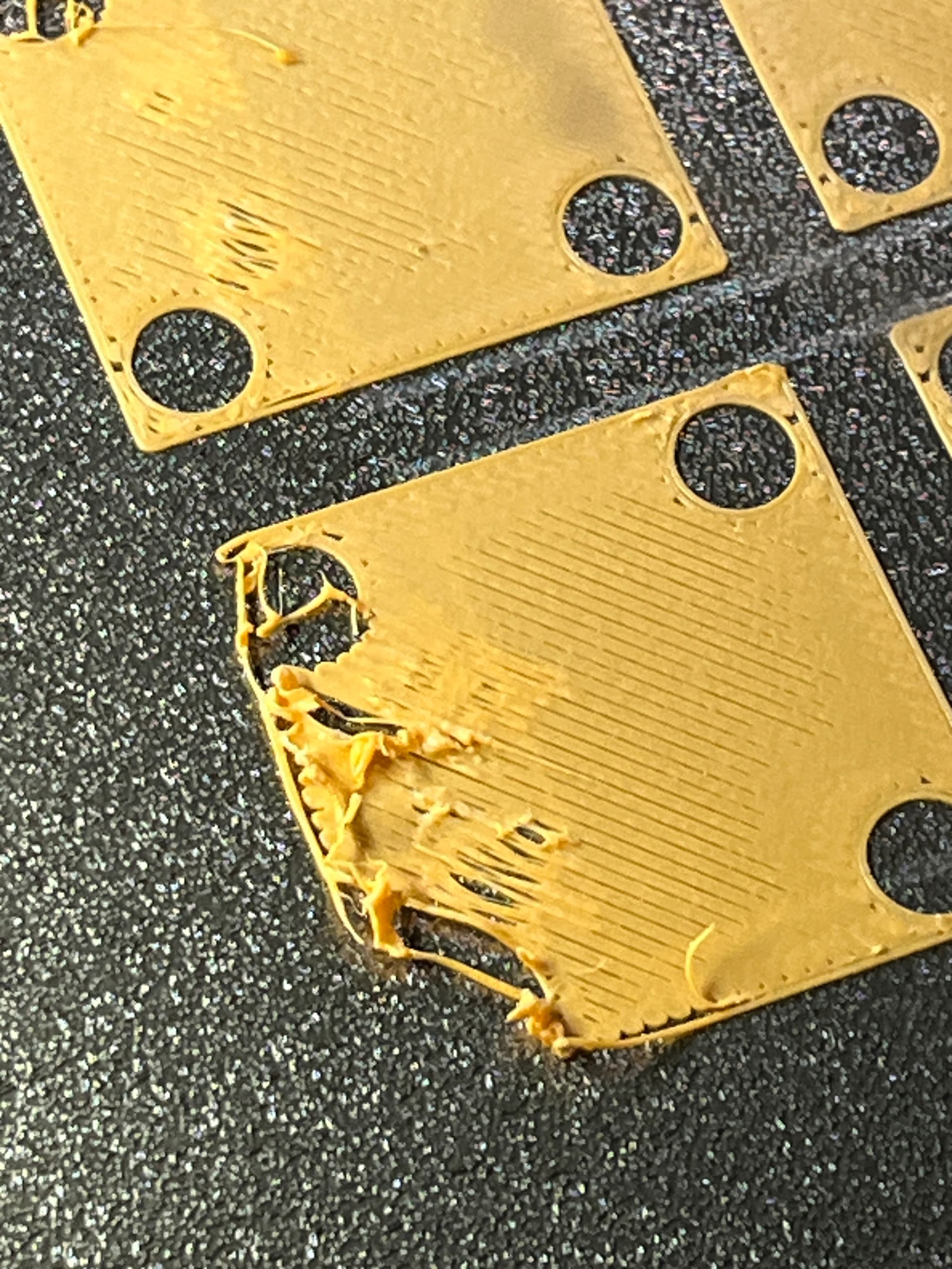

Okay, so here is what its doing even after 8 hours of drying, 13-14% humidity. 1st layer is garbage but then sometimes the rest prints just fine. Maybe a setting that I need to adjust for the first few layers?
What is going on? It only happens with this one spool of Bambu Orange Matte.

The first-layer “garbage” is poor adherence almost certainly caused by a dirty plate. Wash it with warm water and a grease-cutting dish detergent (Dawn, Fairy, etc). Use a clean washcloth or a small nylon brush that can reach down into the “valleys” of a textured plate. Rinse thoroughly and dry with a clean towel that was washed without fabric softener. Do not touch the surface, which will leave oily fingerprints.
The gaps between lines of filament are caused by an insufficient flow rate. Evaluating the flow rate calibration results can be difficult if you rely on the Bambu wiki’s fuzzy, low-contrast images. You might want to look at the OrcaSlicer wiki for the manual tests, which Bambu took for Studio. You are looking for the sample with the smoothest center. Don’t consider the edges for this test.
I had a very similar experience with a spool of Bambu Lab’s matte “Marine Blue”. First layer was just a disaster, anywhere from looking like your photo to a giant blob of plastic on the nozzle. I was going crazy trying to figure out the problem.
The solution, for me, turned out to be very simple: increasing the first layer temperature and plate temperature by 5ÂşC. Totally fixed it. Now I know to increase the temperature for that filament.

Is it just this color or is this the only spool of Matte you have tried? I’ve seen wet matte filament do that, dirty build plate, and running the printer on stupid fast speed. I haven’t had to mess with any out of the box settings for Matte - but I have had a spool arrive without vacuum on the bag and it was pretty wet. I could see steam while it was doing the initial load/purge and from that point forward if I see that on a spool I stop an dry it like I found it in a swamp.
I had it the dryer for 8 hours because that was my first thought and it is only this one spool of matte (I have 7 others that I have not opened). Its Bambu brand and all the basic PLA prints fine and the Sunlu PETG printed fine after I dried it for 5 hours.
I will wash the plate again when I return but its strange. Printing gridfinity bins, it may be the base at the front on one print and then the back corner on another. There seems to be not pattern to the failures (not the same area on the plate) and I wear disposable cotton inspection gloves to remove the plate and try not to touch it with my bare hands.
I have been able to print Bambu PLA pretty reliably without drying, but I use the dryer a lot for other filaments and it usually gets to <10% humidity. If you think about the process logically, the dryer dries the air surrounding the roll of filament, over time evaporation then wicks the moisture out of the filament. The outside of the spool dries first, just like pointing a hair dryer at a rolled up wet towel. Then over time the moisture in the inside/center of the spool starts working its way outwards until everything levels out at a specific humidity. So 1 hr is definitely not enough to dry all the way through. 8hr probably should be, but maybe not if a spool had a lot of moisture. I would definitely also try increasing the nozzle temp and plate temp slightly as @Bratling suggested.

It appears, after taking everyone’s advise the problem is solved. At least for now.
  1. Washed the plate. 2) Dried the filament for 8 hours. 3) Calibration of the filament. The only thing I did not do was increase the plate temperature but after 3 prints that took over two hours and 3 that were less than an hour I’ll keep that suggestion in my back pocket.
It appears that this specific filament absorbs more moisture than the others so I need to prep it more before printing.
