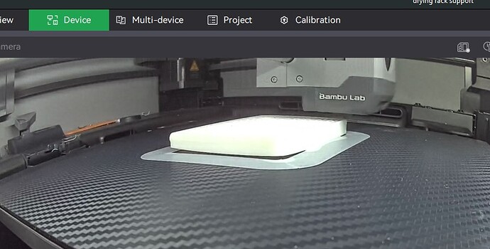

I’m pulling my hair out here.
I’m trying to print a simple part in white Bambu ABS using the P2S with the spool thingy on the top.
I’ve set a 20mm brim to try to retain the flat base of the object on the plate.
I’ve tried different plates even.
However, the print is unsuccessful, dislodging from the plate as the base curls after about 70% of the print.
What would you suggest I try next please?

Model Name Wall Mount Bracket for Foldable Drying Rack Rods
Project Name 0.2mm layer, 2 walls, 15% infill
Plate name Plate 1
Printer P2S(P2S)
Build Plate Smooth PEI Plate / High Temp Plate
Time 2026/01/19 15:25 - 2026/01/19 16:58
Filaments ABS | 38.93g

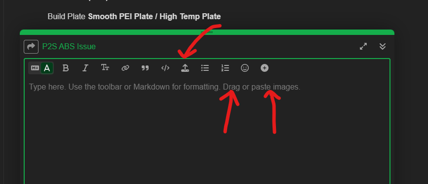

To upload images you can use the upload button, drag or paste them in.
You can also add the .3mf for your project which is really helpful for figuring out issues or making suggestions.

Thanks JonRaymond,
Picture and .3mf added.
EricU, yep that’s my issue with any ABS print and not just this one. Strangely I still get perfect prints with ABS using my original A1. I only bought the P2S as it had enclosure and wasn’t a bed slinger…..
trenzterra, I’ll give it a tr….
I know you said you’ve tried other plates, but that 3D effect one in the picture is only recommended for PLA and TPU.
You do not mention your chamber temperature.
You should be heating the chamber before beginning the print. Set the heat bed to maximum, run the auxilliary fan at 30-50% to circulate the air, wait until the chamber temperature is at least 45° C, but warmer is better.
Yes, but after trying the usual suspects, I tried this as a last resort…
I did’nt know this - I just thought to send the print and let the P2S sort things out……
